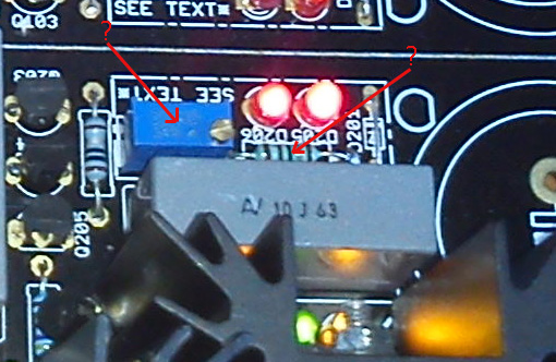

tried to fire up for 18V usage with plitron tfo. the 3 green leds light up, the 2 red leds don't light up. getting about 2.5V output. Tried the 9V batery test on the leds and they all light up.
What can I test next?

Maybe you left some unused position and did not jumper in the voltage making area?
gave it a dummy R load when I fired it up. using 10R at 301
turning the trimmer does not change the V either.
using a 18V AC tfo

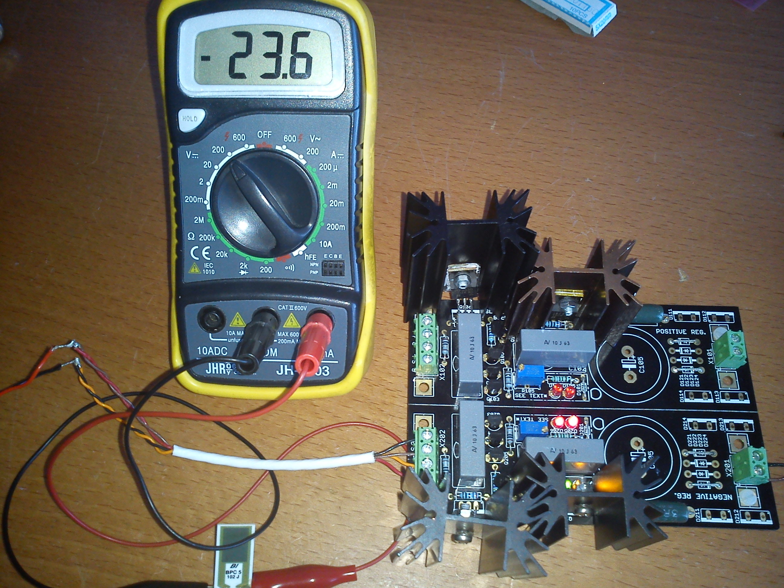

With first +- regs I reached +-24Vout very easily but the second +- regs the posistive rail I get max +24Vout with trimmer at each max position & after warm up, negative rail only I get max -23.6Vout with trimmer at max. position, I'm using in all regs:
Tx 24VAC - 0 - 24VAC 120VA so 60Va per winding
PSU 10.000uF 63VDC Jensen 4 pole caps
Vin at the reg -33,7VDC
Load 1K 5W
R1 3R9 1.5V across (384mA)
I used two differents Tx with the same results😡
I don't understand the reason because first +- reg was operating OK without any problem at first attempt😕

Add a resistor into diode position, or swap out the R203 for something larger.
The reason is something's smaller in the reg that can't go 24V. If the resistors are the same, then simply the K117 in the lower Vo reg has less Idss than in the other reg. Add more resistance as Tea wrote. Simple Ohm's law.

Check that your Q103,203,303 are K117 JFETs and not BC transistors by mistake. Because one reason can be having no current to drive the V reference resistors and trimmers. What dummy value?
Suggested resistor value?
What resistor and trimmer you use now in the -23.6V max one?
I believe the suggested resistor value is 1K or less, right?
Tell me what you use now first, so I can calculate your current.

The guide writes 1K8 resistor also. Is that resistor 1K8? Anyway, add 1K instead of the Zener jumper, should give you enough conversion to reach 24V with ease.
P.S. I see you edited. The examples in the guides state they assume a certain in circuit IDSS. If a FET chances a bit weaker or stronger it takes compensation in the values.
