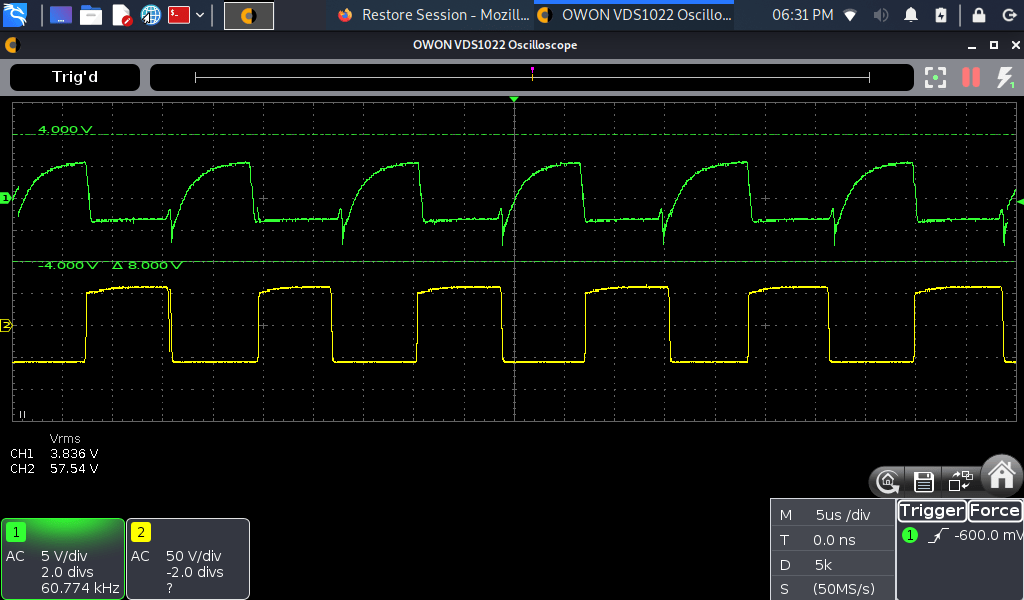

When i put 12v in remote the amp PS tries to start but fails, i measure the signal in gates and is not present, without mosfets in board i got a clean nice square waves, but when install mosfets i los the signal, the mosfets get hot, some kind of short is present, i teste diodes gate reistances other resistances of the PS an i can not find the problem
Perry i replaced PNP PS driver transistors an it worked, i got 50 and -50 volts in rails, now i got another problem
The output fets of the positive rail is getting hot, i post a picture of the scope readings.
between gate and source i got 10.2 kohms i desoldered that bank and the value stays in the board,i desoldered diode tha i thinked was bad but the value remained in the board
following the value that resitsance is present in transistors mpsa56 of the driving board this value is suspicios to me
10.2kohms (inverting polarity of meter is the same value) between emisor and colector pins of a56 is normal value?
the weird signal is channel 1 and is negative rail channel 2 positive the ground was referenced in secondary ground.
