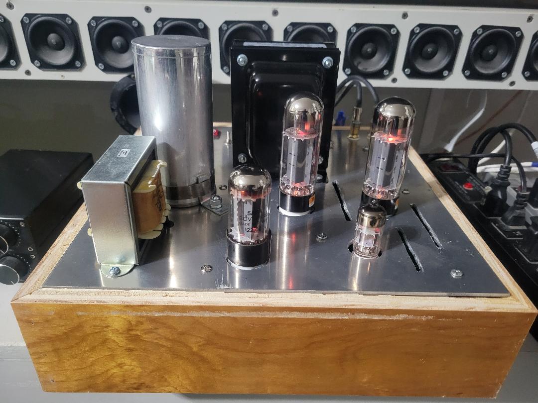

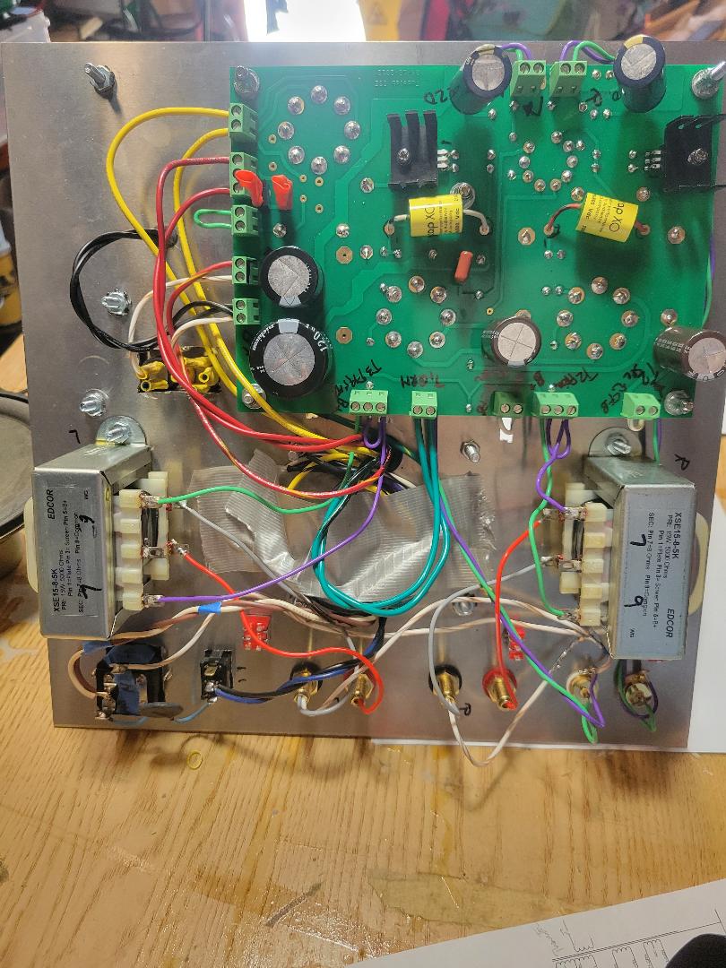

Just finished another SSE built. Got some question about biasing. I used Hammond 374BX and EL34 tubes. While using 5AR4 rectifier tube, I measured B+ 428V, Plate 424V, Cathode 30V and I use a 560 Ohm bias resistor. This computes to 53 mA biasing current and (424 - 30) X 0.053 = 21 W dissipation.
Shall I drop the resistor to 450 Ohm or so to bring the current up to 66 mA like what George specified in his design?

That is a very compact and efficient use of the square baseplate! I am considering a similar approach for a new home for a SPP, so it was good to see your version.
What is that row of speakers for, at the back of the picture?
If you tack a 2.2K resistor across the 560R one, that will be equivalent to close to 450R. It only dissipates half a watt, so a 2W will be plenty. Then you can see if the extra burden on the tubes pays off.
Thanks for the suggestion. I wonder why my cathode voltage is lower 31 vs. 37 on George's design page using similar power supply and tubes which requires a drop in the bias resistor to get the desired current ? Even if I switch to solid state rectification, the cathode voltage is not much higher: 33 V. The row of speakers in the background is my center channel speaker containing 16 X 2.5 inch fullranges. The aluminum base plate 12X12 inch and as you can see space is tight. I had contemplated upgrading the OPT to the Edcor CXSE25-5K, but the added weight and space requirement cause me to pause and think for a while. With the current weight, it is quite and exercise to lift the base plate up and gently replacing it back on the wood base
