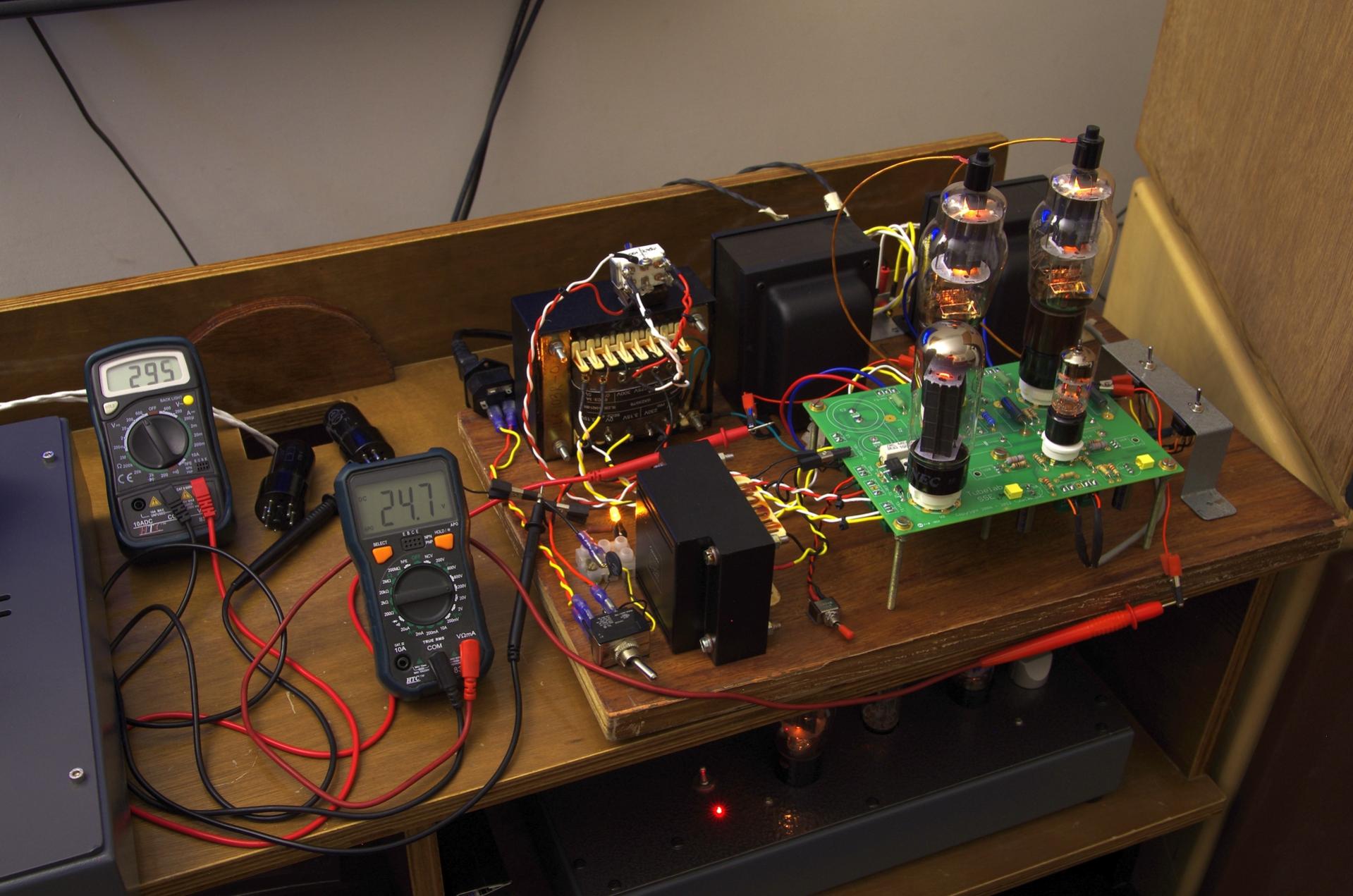

SSE 275/300
Got my first SSE running. Reading the adventures of others, decided to try a dual secondary and have switchable 275 /300. The cathode bias is 'toggled' via that contraption on the right side
This one is running at ~ 290v /20v with 560R on Rk. The valves are 5U4Gb, Brimar 12AT7 and 6P6S.
Any recommendations on what voltage I should run this? The spec sheet says its a 13w tube, so I can raise the secondary or drop Rk to 400R.

Congrats Sunil, very neat breadboard build.
On the page with sims here, George says:
That's a good first step. After that, if you want to choose a different harmonic profile, you can use the table and an online parallel resistor calculator to find the value for a couple of matched resistors that you can solder in parallel to the 560R.
Looking forward to seeing your final build in a case, etc...

Thanks YashN. I'm following G.As recommendations as much as possible. Being a new build the 6P6S was the guinea pig (no magic smoke yet) but the results sound 5hiT.
The amp is wired in Triode and I've tried with valve and SS - B+ (R4) at 290, 320 & 360v. Just couldn't get decent sound. Don't have the equipment to test distortion or anything as such, so can't say what power levels they were at.
Plugged in a Brimar 807 today - 294, 25v and 680R. Sounds the best I've heard so far
I'll try different power levels and see how it goes. G.A mentioned if the B+ was kept below 375v it should be ok.
Any recommendations from folks who've tried the 807?

I do know that 807 can be a difficult beast to tame, but at the right anode voltage, with the G2 voltage respected, can sound good? It looks like 440v is possible when trdiode wired, from the data sheet. People fit a stopper resistor on the anode cap to help with 'snivets', which may be audible. I have used 5B/255M (807 on a loctal) in a Quad II, and they sound great there, but that is with the benefit of a push pull configuration to improve linearity.
What sound source are you using? It could be that the weakness of that is being exposed?

807 and 6P3S with Solid state rectifier
The 807s at 294v, 25v and 680R were short lived. The amp started making funny distortion noise. The B+ was rising and the cathode V. was dropping below 19v. While building the 2A3 I had a similar situation while fiddling with the bias pots (~10ma).
Anyway, switched to SS (300v) and this is what I have - 358v, 28v and 560R. Seems to take a while to get going, but after that they sound great.
The 6P3S sounds great at these numbers as well.
Could someone please explain why that happened at 290v

When the B+ is below about 325 volts the 10K resistors in series with the CCS chips need to be bypassed to provide more voltage to the CCS chip. This can cause distortion as the current through the 12AT7 may be unstable.
I made an SSE using 6V6GT's on 325 volts and the amp sounded better with a piece of wire in place of the resistors. Much below 325 volts and it's probably going to sound really bad.

UL definitely sounds better than Triode. Way back, w5jag posted a great thread with lots of tubes tested and great info. With SS and 300v secondary I get 360v/30v (680R) on 807 and 350v/29v (680R) on 6P6S.
The 6P3S-e I have are noisy and have a harsh 'in your face' sound. The 807 sounds better than the 6P6S.
With SS, at switch ON, the B+ rises to ~ 410v within 3s while the cathode voltage takes almost 10s to ramp up slowly and then both settle down. Can /should I increase the 10R thermistor in the mains to maybe 50R ? Is this a tricky situation likely to cause problems? Please help.
