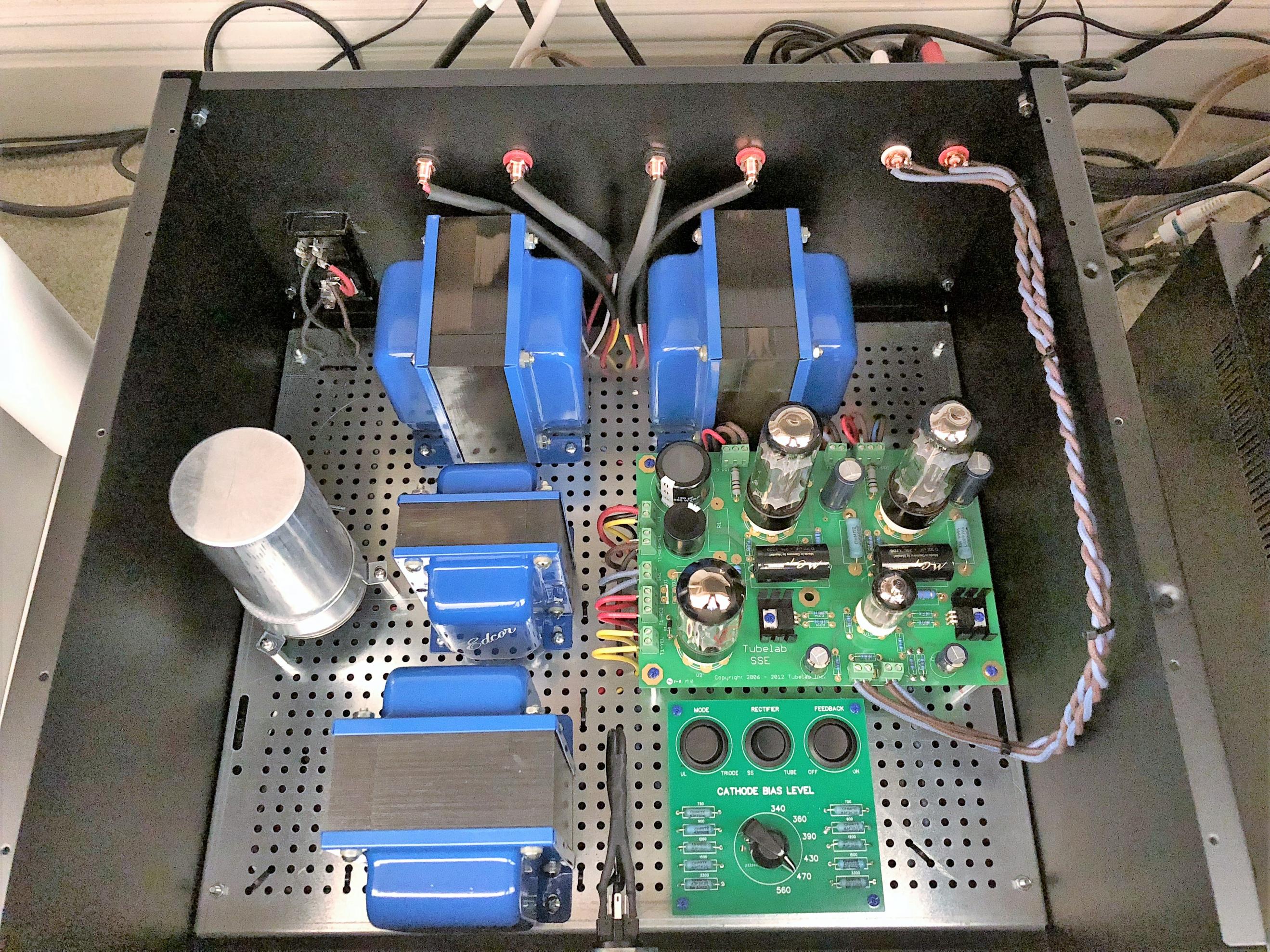

My SSE is just about completed and I wanted to share my build and my thoughts. All that's left is to get the illumination working on the front panel power button, maybe take some measurements, and tweak some settings. Otherwise, the amp powered-up on the first try and was fully functioning without any issues. Here's my new baby:
Enclosure
Since I have a young child at home, I wanted the amp to be fully enclosed for safety. The HiFi2000 Pesante 5U chassis available on the DIYAudio website looked like a great option. Although certain areas of panels closest to the tubes get quite warm (but not “hot”), both the top and bottom panels are fully vented so heat does not seem to be a problem. Leaving the amp powered-on overnight doesn’t change anything. The amp seems to operate at a constant temperature and does not get any warmer than after being on for just 5 minutes. I’m happy with the way the customized front-panel turned out and the “traditional solid state” appearance.

Having never heard an SSE and because of uncertainty regarding which loudspeakers will be used with the amp, I thought it would be best to include toggle switches for Ultralinear/Triode Mode, Solid State/Tube rectification, and Cathode Feedback. I also wanted to incorporate a rotary switch for selecting various cathode resistor values (i.e. forum member rknize’s build).
Instead of having all the switches on the outside of the enclosure, I decided to mount all the “controls” on a separate PCB board, to be installed inside the enclosure alongside the SSE board. Here’s a link describing how I had it made: Custom PCB Board from JCBPCB

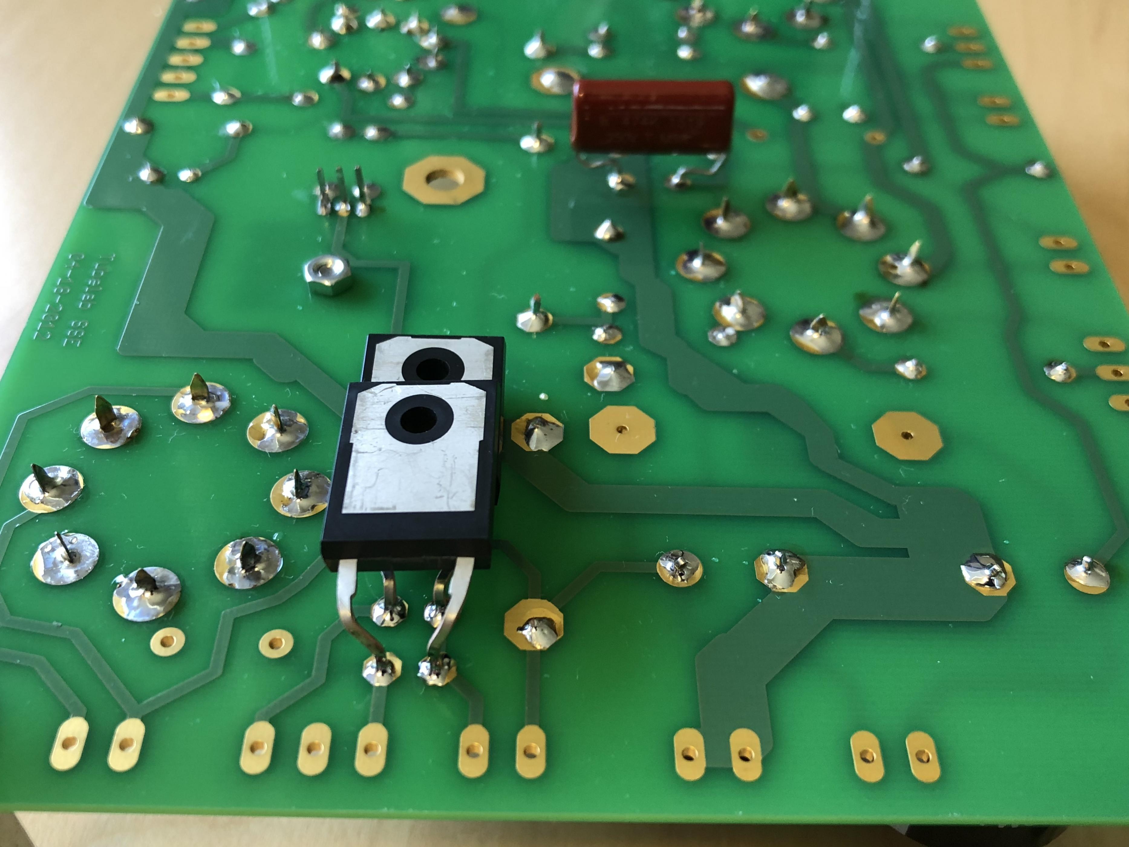

Following the instructions made the assembly process mostly uneventful. Most questions were answered through heavy searching on the forums or directly by helpful folks on the forums.
The very first sounds produced by the amp were sourced from a basic desktop computer in my workshop through an Arcam rDAC. Something about the computer, the RCA cables, the outlet(s), or a combination thereof, created quite a bit of buzzing and humming at idle. However, installed in my office, the amp is nearly silent. I must put the tweeter to my ear to hear anything. 😀
Here are some pics of the assembly process:

My SSE amp has been operational for just two days now and it’s been a joy listening to it. After a bit of fumbling around, I settled on using tube rectification, triode mode, no cathode feedback, and a cathode resistor value of approximately 470 ohms. This arrangement seems to work best with my very reasonably priced Pioneer SP‑BS22 bookshelf speakers. There may be another combination of settings I find more favorable, but it will take either more extended listening or the ability to change settings on the fly for quick A/B comparisons to find the right combo. Since I’m still uncertain what settings, if any, are safe to change with the power on, I’ll just keep powering the unit down.

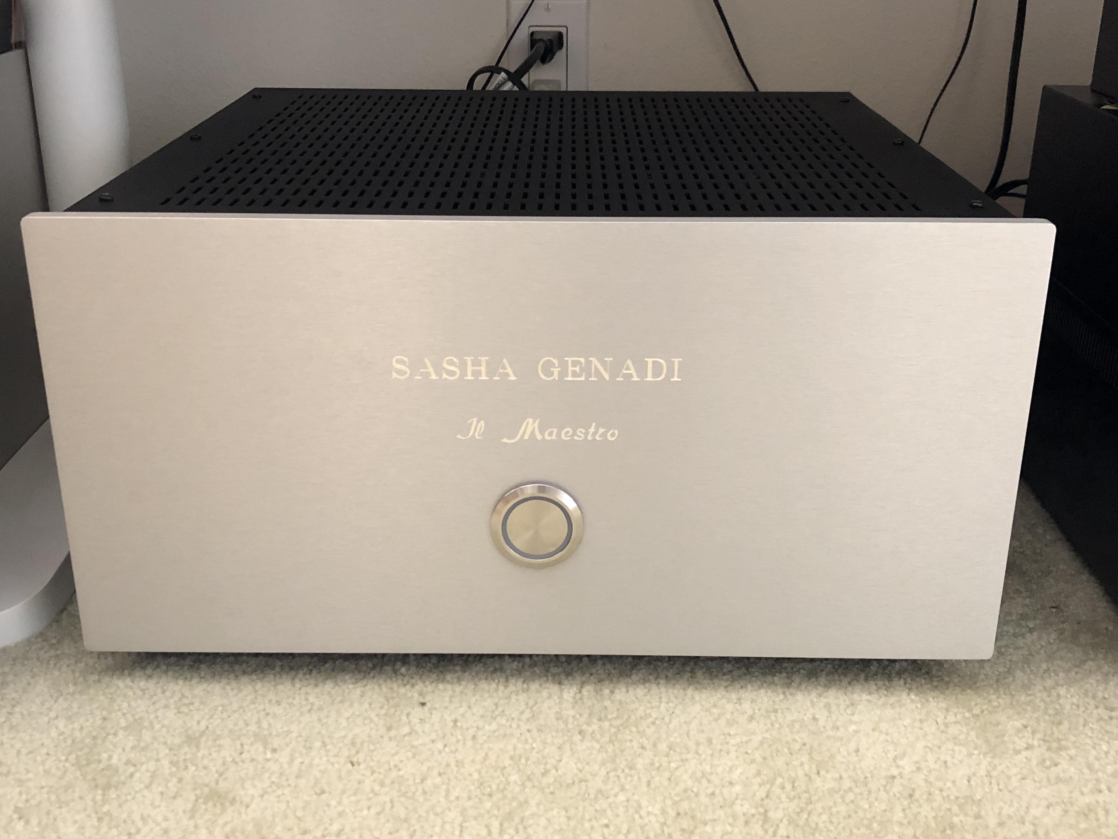

Enclosure

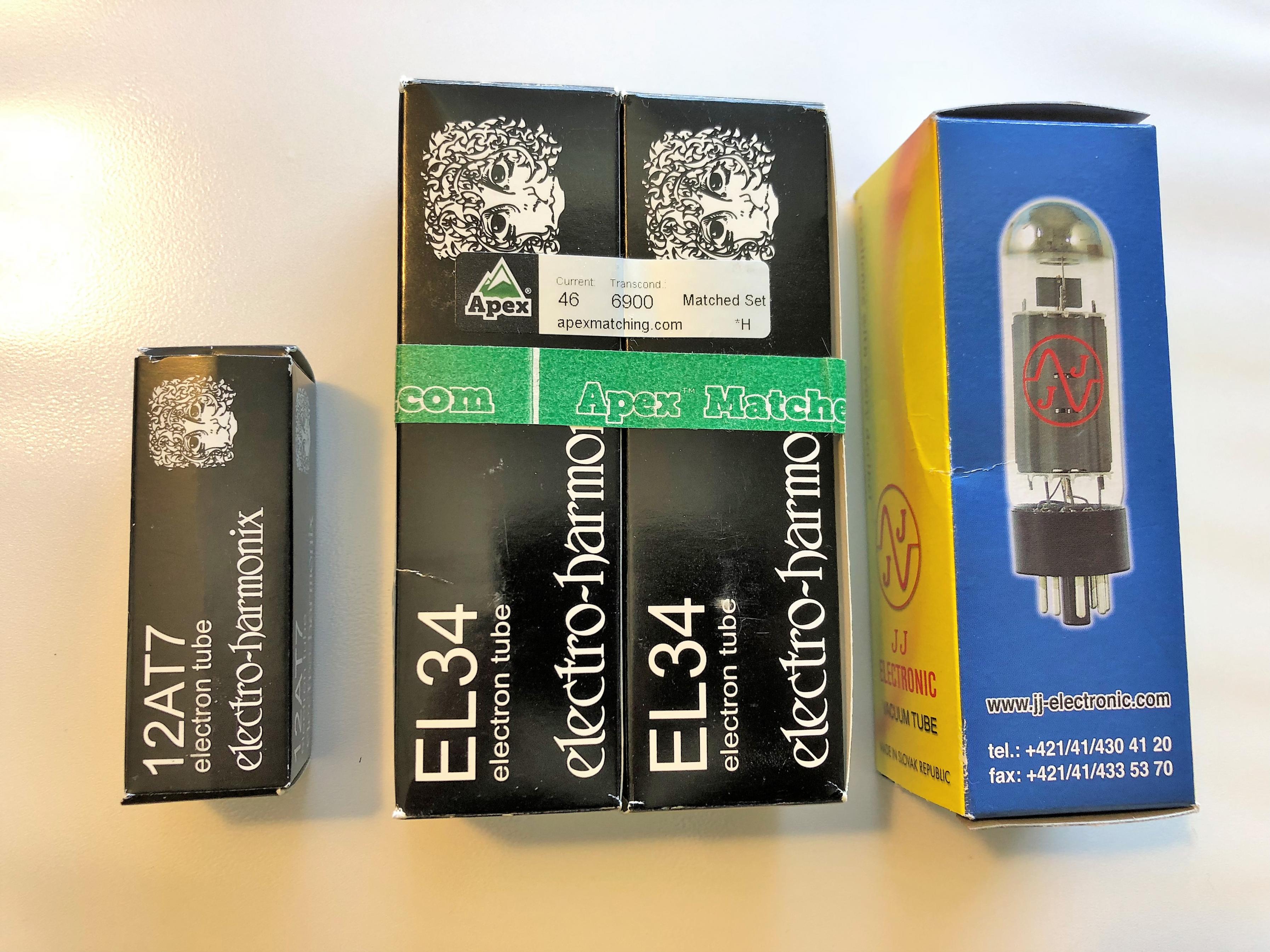

Tubes
- Electro Harmonix EL34 (matched pair)
- Electro Harmonix 12AT7
- JJ GZ34

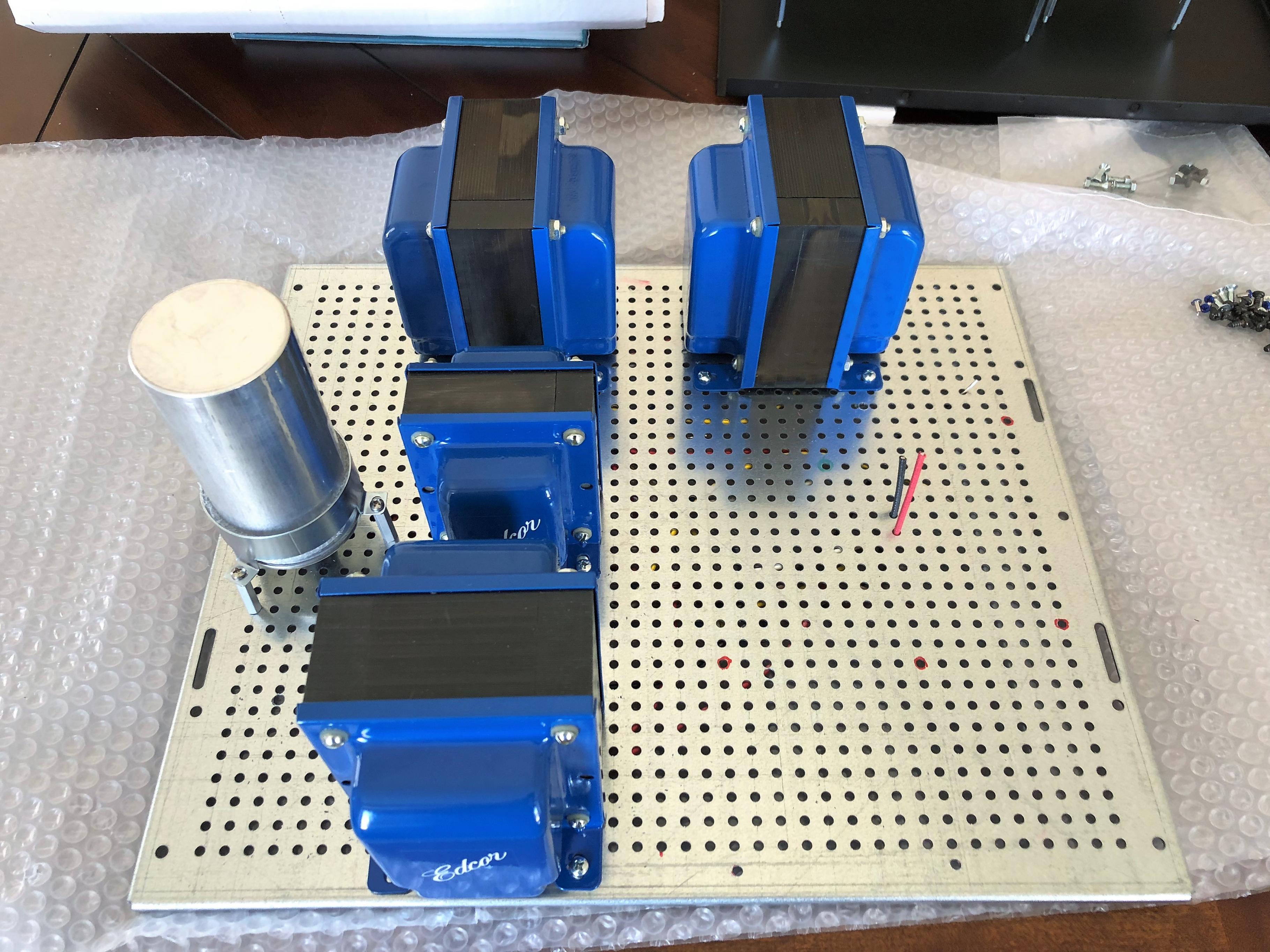

Transformers
- Edcor CXSE25-5K (pair)
- Edcor XPWR035
- Edcor CXC125-10H-200mA

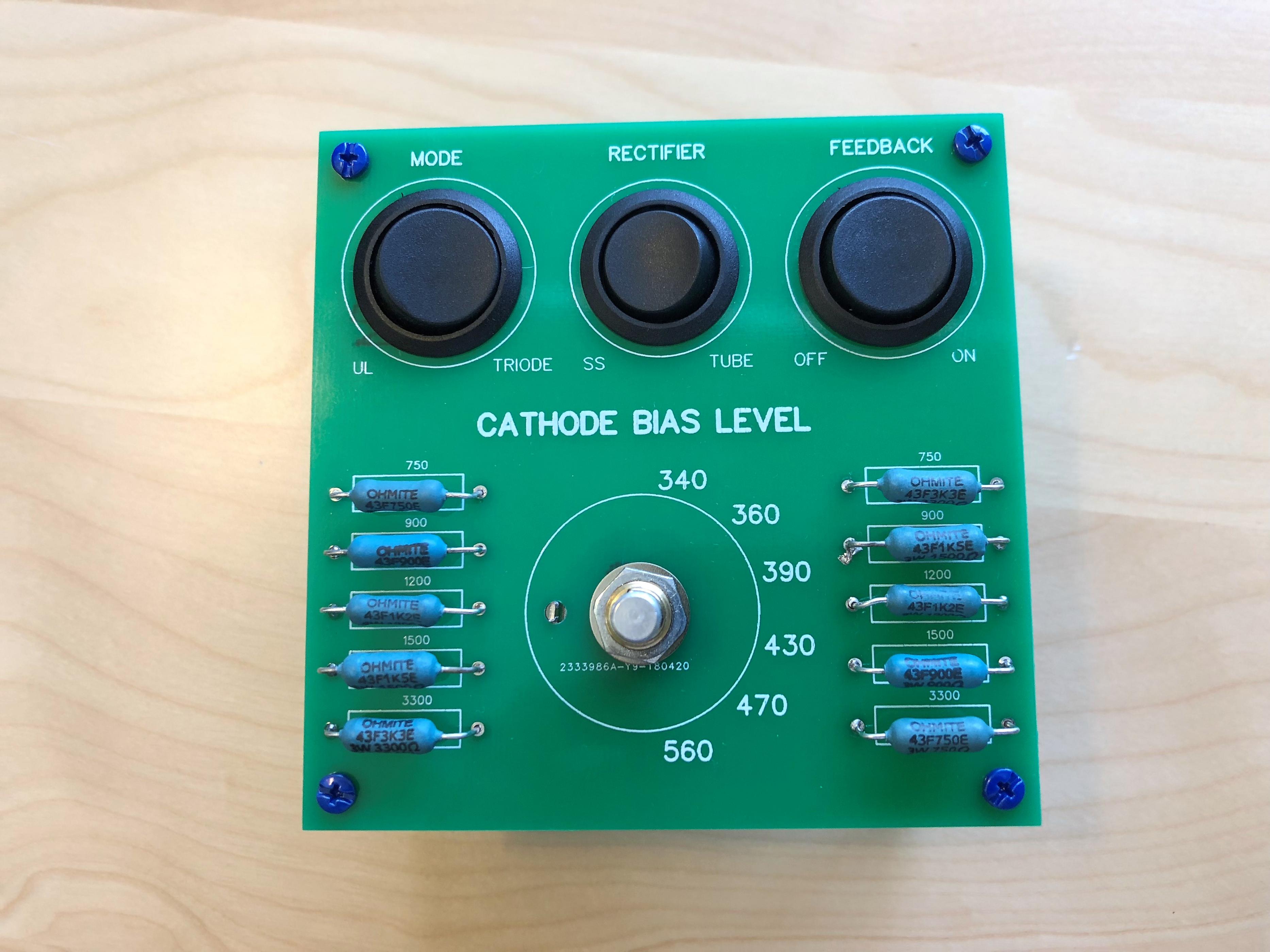

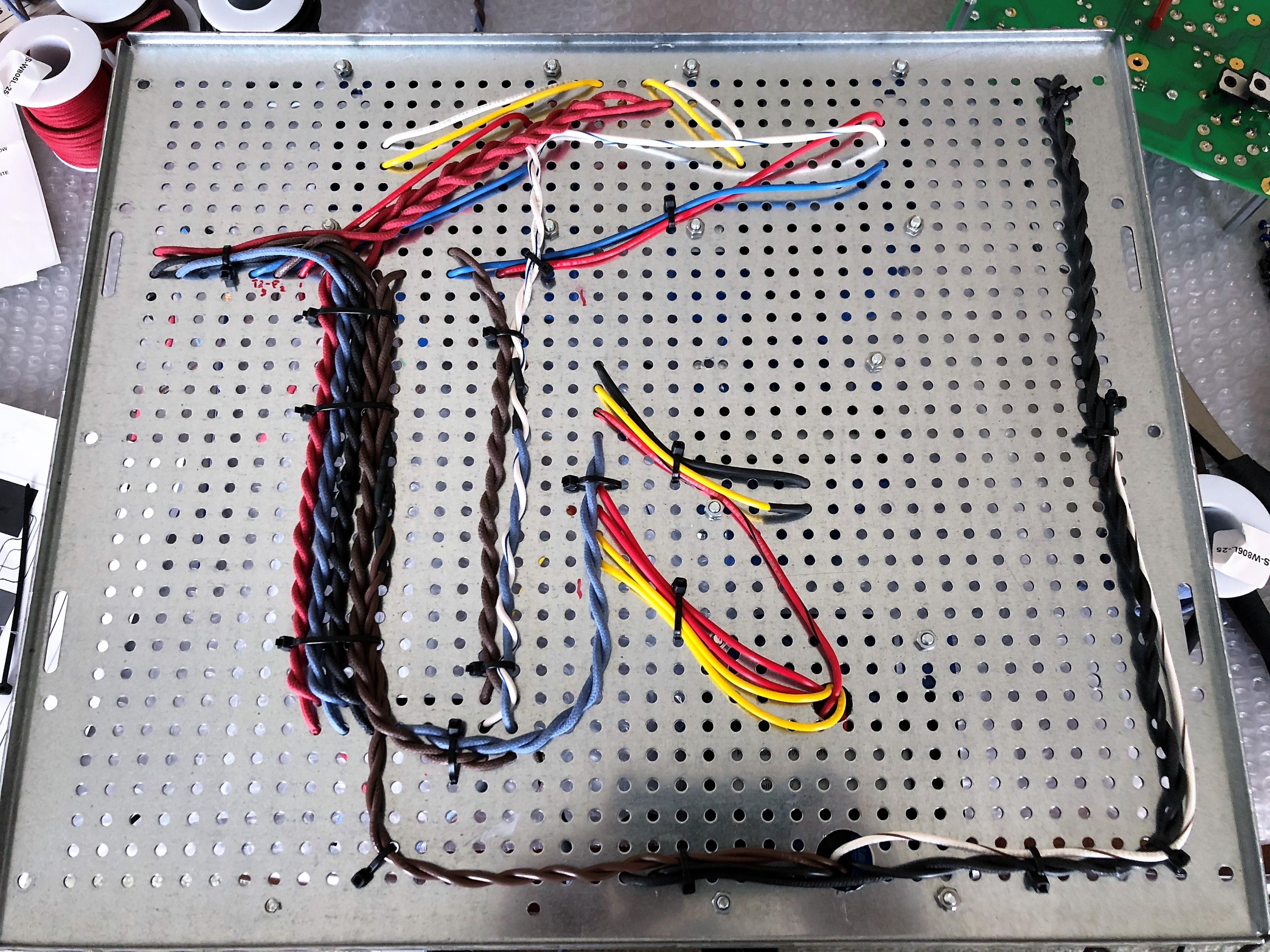

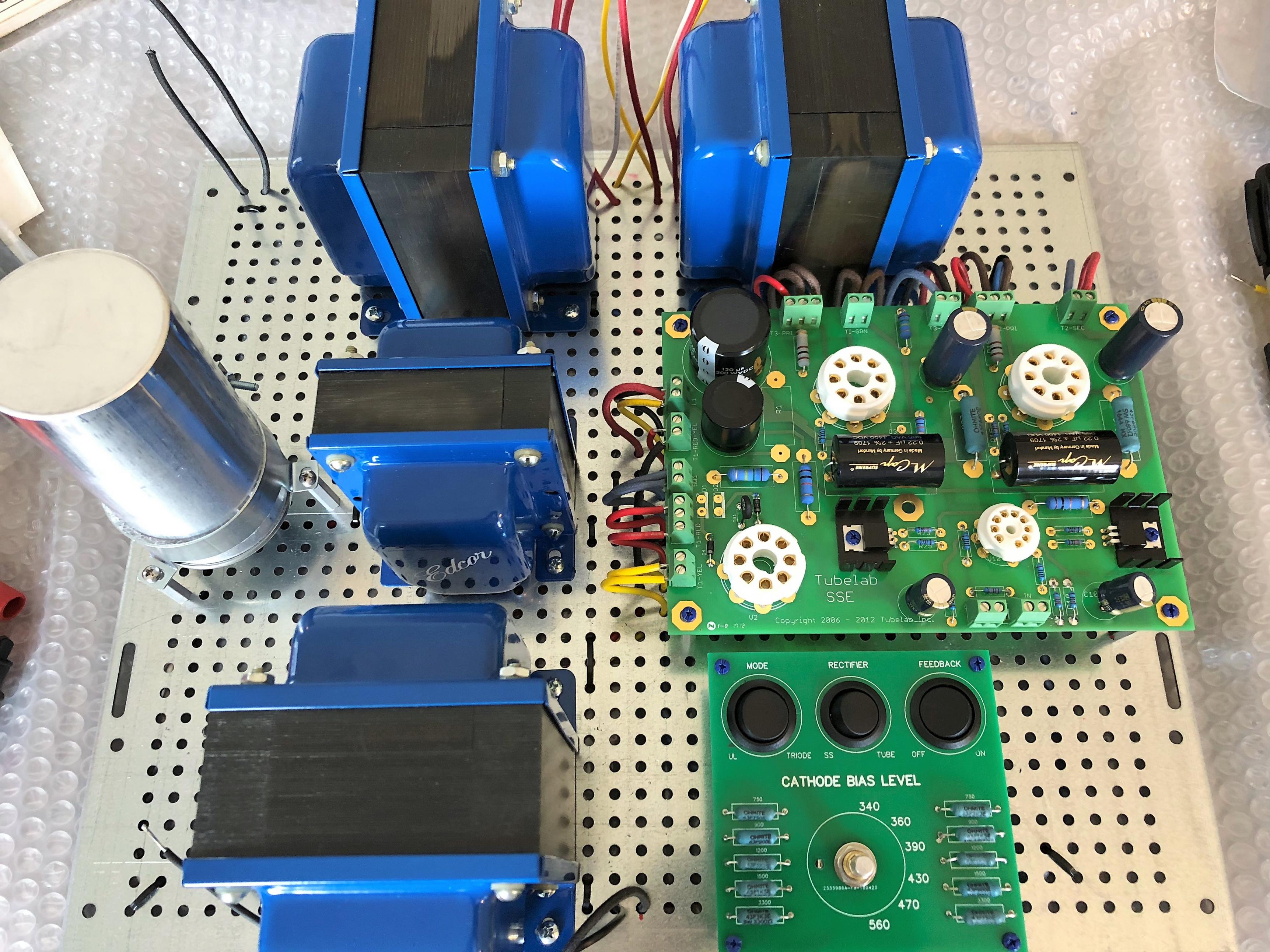

Control Panel
