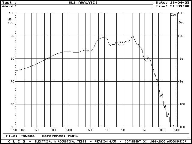

Looking at the response Tony Gee posted in his andromeda, I suspect that there is some breakup in the Scan cone starting as low as 3KHz. You may find the results cleaner crossing over below that with a higher order filter and/or using a notch filter to tame the breakup modes.

Hi Machinow, the peak on the scan that seems most troublesome is the one around 600-800hz of around 4db or so. I've not tried notching it out because listening slightly off-axis it seems to go away, particularly with a lowish crossover point (it seemed more noticable when I was using a 3.2khz xover). I have wondered if notch filters take away some of the magic🙂

In my expirience SS8545 cannot be used with simple 2. order crossover because of it's riseing and far reaching response. Using it that way (or even worse with 1. order xover) attenuation slope above xover point is to slow. If one uses larger inductor to overcome this the crossover point gets very low. With your 1,8mH you get very wide overleap with the tweeter and it can make the highs a bit aggressive (even more so with 1,5mH - machinow ).

Here is the fr measurement of ss18w8545 at 1m in his box. One can see a large and broad peak from ca. 600-1100Hz. It's this driver's feature and you can see it in almost every commercial speaker using it. It ads to some of midrange "warmth and presence" unique to that driver. To get rid of it (that's - if you want to) you have to use more complex filters than simple textbook crossover filters. Otherwise (to get rid of it) you either have to use larger inductor and than have sudden drop after 1,1kHz ( float ) or use smaller inductor and live with it and have somewhat agressive midrange/highs.

this might sound crazy, but i think the 2-3 khz area is better done by woofers than tweeters, no matter how expensive tha latter. i've got the scanspeak 8" 8554 kevlar and 2905/9700 crossed over somewhere between 3 and 4k witha simple 2nd order and it's better this way than lower, but this is just preference.
carbon is way more critical here.
i would be most concerned about the 3k peak on this woofer - look at the time delay graph if you can find it but if it's not too nasty give this suggestion a try.
