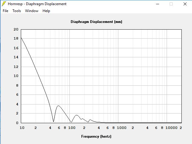

At what wattage will I run out of excursion? And would my aim of 100W be "ok" without a highpass?

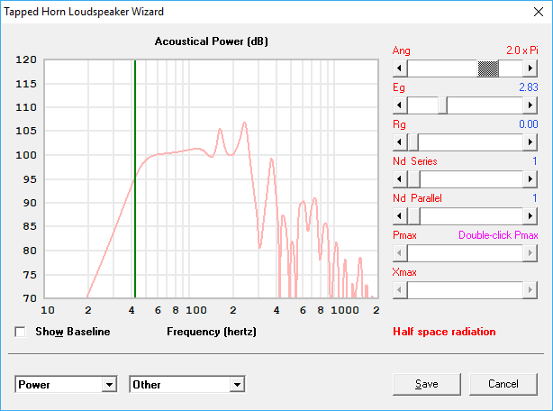

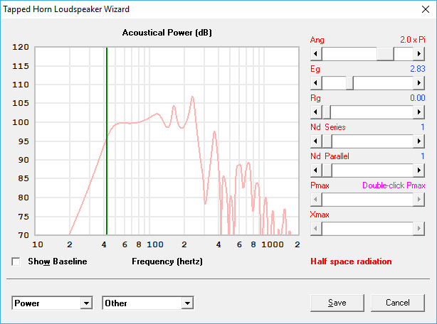

You will need a high pass filter with a tapped horn use it at the levels you want.
Using Hornresp it is easy to see the effect of different filter types and how this will help to control excursion. As I posted before I think a 4th order butterworth at 35hz is suitable but do check with your chosen driver.
Pic shows an example driver excursion in Brian's Sim driven at 28V (100W)

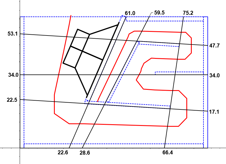

Brian I think you did it! I just checked with those dimensions, 1 would fit even INSIDE my trunk, 2 easily with only 1 seat down - with the efficiency I want, the extension I want, using a high value budget driver!
How much space do you have to play with? The workbook I use for the design work does allow for quick adjustments. The cab may perform a bit better if the width is increased to 18", for example.
Don't forget that you'd likely want to pack other stuff in the trunk too 🙂.
I just want to caution again that the design is untested. The Hornresp sim looks pretty good and Hornresp does "get you into the ballpark", but the accuracy does depend on the driver meeting the published parameters (I haven't had the opportunity to measure the PA380), and the sim does not include the impact of box losses.

18" would work. At 18x24x36 I can fit both inside with one seat down.
My max could be 18*30*30, though then its really tight, so I'd only do that for significant gains - like 5Hz or a few dbs or something 😀

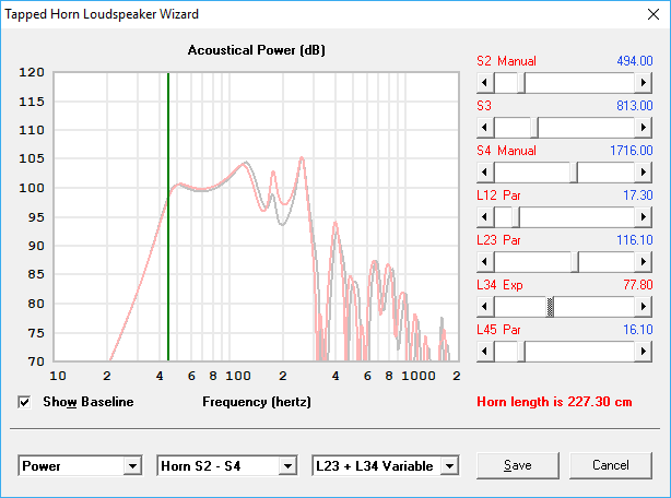

I noticed that the compression ratios I ended up using in my designs (basically Sd/2 in the Hornresp sim) are quite a bit higher than the original SS15 design. Compression ratios that are too high can cause cone damage at higher SPL levels. The CR for my design is around 2.5 and for the SS15 it's around 1.7. That's quite a difference.
While I have another look at the designs, here's how the PA380 models in the "SS15" model that was put together by Oliver in the SS15 thread, with slight corrections made for cone correction. I've also included what the response looks like in the "modified" layout as suggested by my workbook (same external dimensions, same use of 0.5" ply all around). The response up to just over 100 Hz is just about identical. I think it should be possible to achieve something similar or better with a slimmer 18" box.

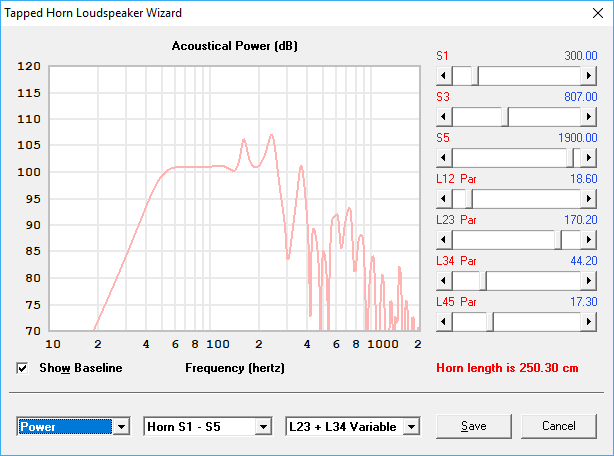

Ok, here's another option. 18" wide, 34" high. Compression ratio is 2.0 (when cone correction of 3L is taken into consideration), which is lower than my previous suggestions, but still higher than the SS15. Maybe at 100W it shouldn't be an issue - I'll let the more experienced here (particularly with that driver) chime in.
But with this design you get your 40 Hz and your 100dB/2.83V/1M (if you squint a lttle 🙂 )

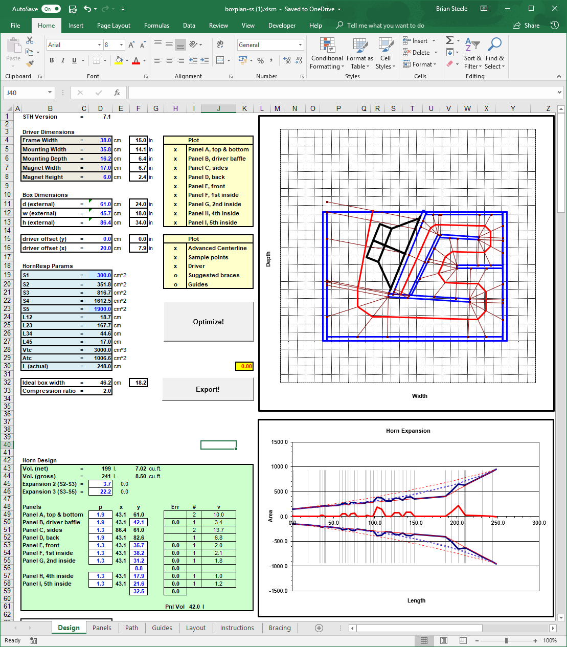

BTW, while using the SS15 fold workbook, I've come up with a few ideas to improve it, which I will incorporate into the workbook this weekend. I don't expect that it will provide any massive improvements, but we'll see..
For what it is worth: PA380 measured WT3 specs
Now, that's interesting. Not only are those parameters a little different from the published ones (Mmd works out to be quite a bit lower than published Mmd which makes them a little suspect though), they are different to what I have on file for the PA380.

I've adjusted the sim to reflect the published specs of the PA380 (as they currently are on the PE site). There are some minor changes to the FR, but nothing really to worry about. However, if the measurements on that link are more accurate, it may be best to adjust the build (smaller CR).

I've done some tweaks to the workbook, and ran it with the specs above. There are a few minor response changes, nothing really to worry about.

Woah! Just got back from the weekend. Thank you so much for taking the time to adjust the design to work. With such an affordable driver, high sensitivity and performance down to 40Hz, I'm sure others would be interested! I'll have the drivers ordered next week and update you on the build. thank you again.
With the last workbook info, the TH's lowest resonance frequency is going to be somewhere between 40~42 Hz, and it's likely to be up to 6dB down at that point. If you do build it, for God's sake don't forget to brace it properly, and let us know how it turns out 🙂.
Hi Brain, this may be a stupid question, but this is my first time using your worksheet for a build - are X and Y the dimensions of each panel in cm? Is P then the thickness?, and what is the best way to transfer the positions of the internal panels from your plot onto the side panels? Do I need your xcel file or have you already given me all the info I need?
That's correct.
The Excel workbook is available from my site (look under "Horn Folding" link). The latest version of the SS workbook is v8.1 However, the easiest way is to cut the side panels first, draw the guide lines on them as specified in the "Layout" sheet in the workbook (see image below), and then use those to set and mark the position of each panel. The workbook assumes no beveled panels, to make the build a little easier, but feel free to cut the panels as you like, once they fall within the guide lines as specified on the "Layout sheet. And use lots of glue, etc. to make sure that there are no gaps, particularly in the first third or so of the horn's path, starting from just before the driver. The cutout for the driver should also be about 3 or 4 mm smaller in diameter than the recommended cutout, or you may end up having leaks around it, and leaks = less bass.
...and don't forget to put in bracing 🙂
