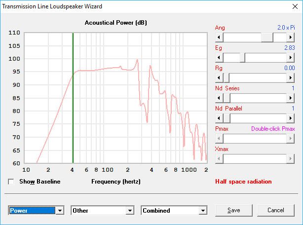

Simple 40 Hz offset TL with the PA380. One will have a sensitivity of 95dB/2.83V/1M, so two will put you over that 100dB sensitivity target. Each can take just over 200W (40V) before exceeding linear excursion limit, and will likely comfortably take 350W each above 40 Hz without anyone noticing anything. And the amp will be seeing a 4 ohm load. The big "vent" will ensure little or no vent compression effects up to the peak SPL capability of the box (particle velocity will peak at 10 m/s @ 40 Hz with 40V drive).
Net volume for both will be less than one SS15.
Build 4, drive them off an amp that can do 1.2kW into 2 ohms, and I think that should be more than enough for your 30-person beach party.. 🙂

My bad, I totally misread sensitivity vs sustained output. yeah 100db sensitivity is more interesting as a problem for sure. Multiple drivers as already suggested would be where I looked first. A TH from 40-80 might be really big.. whatever you do, please post some sims / what you end up doing.
Doubling cabinets and drivers would add +3dB sensitivity, for 98dB, 2 dB shy of 100dB sensitivity ;^).
Sim looks very good, and amazingly compact!

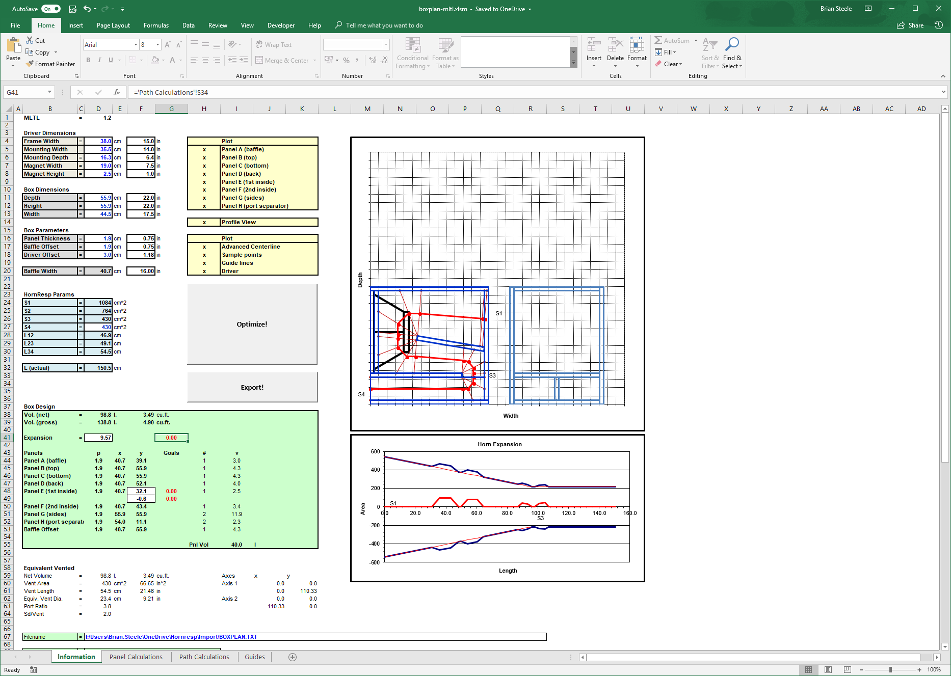

The boxes should be easy to build (basically shelf-vented boxes with one extra internal panel). If I was building them, I'd add an extra brace across the top, like I did for my POC6 build (not visible in any of the build pics unfortunately, but the top panel should be braced if it's going to be that large, unless you like to see anything placed on top the box being vibrated off).

Thanks. It could probably do with a bit of tweaking (I'm tempted to enlarge the vent and go with a 42 Hz tuning to reduce any vent compression effects @Fb even further and up the output capability a little), but it does look nice on paper.
And the total cost in drivers for four of those boxes is less than $300.
A 4x8 sheet of ply can be cut into two to make "barn doors" for a stack of two of these subs. I suspect though that they will also act as pretty good sails if the beach is windy 🙂
Note: I did not use the "Lossy Le" option for this sim. With that enabled, a hump does develop in the response, but it's been my experience that Le for the PA310 measures lower than published, and it may be the same for the PA380.
