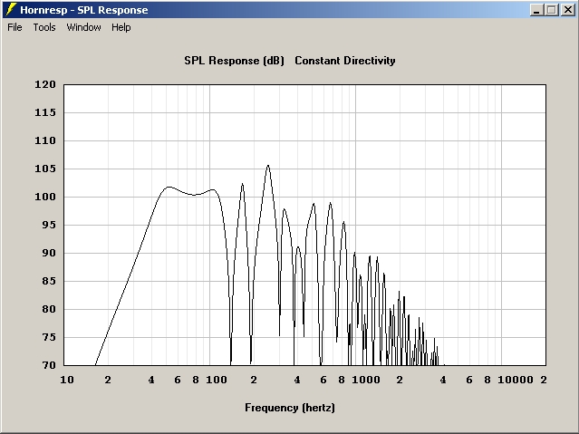

Hi Col
The Peavey 18 Low Rider Looks like it will work well in the Cubo sub.
The cubo is a fairly forgiving design when it comes to utilising various drivers.
The cubo will only reach up to 100Hz or so. Make sure your mid tops can get that low to match.
A quick sim with the Cubo Sub / Peavey 18:)
Regards Xoc1

Xoc1 - is that hornresp sim done with the Cubo sub or the cubo 18 "extended"? Iv'e built the Cubo 18 extended, which is considerably smaller than the Cubo Sub (by around 100 liters).
Hi Col.
The Sim was with the Cubo Sub. I had the data to hand as I helped Rademakers (Cubo) with drawing and development of the cabinet.:eek:
