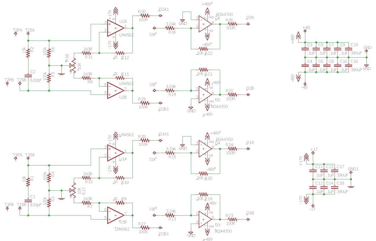

I designed the following input board to 1) reduce the overall gain of the amp (I have more than necessary) and 2) just try to do better at low-noise design in the first stage.
The board is fed by the output of the Jensen input transformer (hence the RC) and goes to an LM4562 stage that is similar to the input stage of an instrumentation amp setup. I chose the LM4562 because it has low distortion, good noise performance, and can drive heavier loads so I can choose resistances that will keep noise down. I also chose it because it does particularly well at keeping distortion down with large common-mode input swings; most op-amps do not do that well. It is well-suited to non-inverted duty. With +-17V supplies, it will put out 10Vrms with very low distortion, which is all I need right now.
I put the option of a second stage ADA4700 for later use (I have a new driver idea with less gain, so I might need more up front). The ADA4700 can get me from 10Vrms to 30Vrms. It has more distortion than the LM4562 but is the lowest distortion amp I can find that can handle voltages this high. I also put a trimmer as an AC balance adjustment. The amp this is going into has no global feedback loop so nulling out the 2nd harmonic generated in later stages has a big effect on lowering overall distortion. Of course, if the trimmer is not desired in another application, I can install a jumper wire and bypass it.
Anyway, what do you guys think of this heresy? Anybody see anything major or minor that I'm missing in this approach? I'm sort of new to this op-amp design stuff, having only read Douglas Self's small signal audio design book, and he doesn't exactly cover the best ways to drive tube circuits with op-amps.

What is the purpose of the pot in the lower half? To adjust out any imbalance from the source?
No, it is to purposely introduce an adjustable amount of imbalance to cancel out gain imbalance in the later tube stages. This feature could be easily bypassed by soldering in a jumper wire in place of the trimmer and just using equal resistors.
The amplifier this is going into has far more H2 distortion than any other harmonic, just due to driver tube gain differences between the sides (I'm using old 841 DHTs as the driver tube). This allows me to compensate for that imbalance if I want.

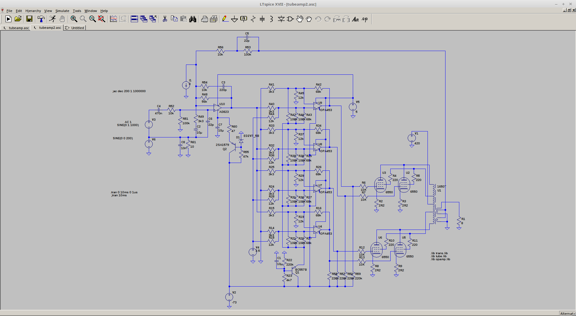

Output stage needs 160Vrms in. 841 stage needs 5.3Vrms in to develop 160Vrms. The plan is to use only the first stage of this SS board at first, which should be capable of 10Vrms with very low distortion from a 2V source.
Later, as my supply of 841s dwindles, I have plans to convert the driver to something like this. I will set it for less gain than the 841 and make up for it with the ADA4700 stage and have the ability to trim out gain imbalances. Distortion in the overall amp should be very low at that point. As it stands, the 841s are the dominant source of distortion in the amp but I'm in no rush to get rid of them because they are pretty.
I am also in the process of changing the supplies around on the 841s so that the grid circuit is referenced to ground, which may have some benefits as far as the hiss goes? I mean, I expect that the Maida regulator feeding that node has some noise at the output that is greater than it would be if referenced to ground, I just don't know how significant it is as far as overall noise contribution to the amp output.
I'm also planning on running some tests on alternative drivers for the 841 grid. Since it is operated in A2, even at fairly low signal levels, improving the grid driver performance may have a significant effect on overall amp distortion.

1) separated stages so I can just leave stage 2 completely unconnected and unpowered until used. I will put in a jumper when I eventually use it.
2) moved the AC (im)balance adjustment to the first stage so that it is useful in the first phase of my rollout of changes. I don't know why I didn't just put it there to start with. It looks much more symmetrical now.
I'll probably have this built as soon as I complete the layout changes.
