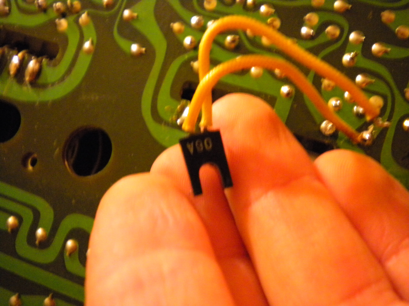

Sakis, thats all fine and dandy, but the amp still works when I heat up the "Diode Transistor array(s)" which is also known as a Varistor. or at least reffered to as one, you might be thinking of a slightly older model. I have the bottom off, and I've bypassed and re-attatched these myself, if they are not actually there, then I guess I need to search for ghosts instead of amp problems...

here's the pic of the "diode array"
I realize the lead is off in the pic, I haven't bothered to re-attach it after I attempted the bypass.

stv3 is just 3 diodes in series for thermal regulation of output bias. (D19 and 20 in the schematic. Normally, I would look for problems in the protection circuit, but if you here the relay click, then it is probably OK. One possibility is low regulated (20v) supply - it feeds the input part of the power amp through a resistor (r299) and cap (C249 and is to prevent turn on thumps. Best way to trouble shoot is to use a scope and follow the signal. If no scope, then check the DC voltages coming out of the supply. The STV3 should have nothing to do with a turn on problem. Good luck.

in the 30 or more years that i do electronics i found may be one or two cases that a diode aray like the one you posted was faulty and yes its a diode array not a varistor
to be more specific even if this network and related parts arround it are not working properly the amplifier will distort or overheat or blow fuses at start up but other than that will play music .... so again you are in the wrong direction ....you are chasing a ghost eventhough the solution is given to you

Those STV-3H diodes are indeed referred to in the 70's manuals as 'varistors', but that is a poor description since they are in fact multijunction diodes and their operation is nothing like a varistor. Sakis is correct, in that these very rarely go bad, even after a catastrophic amp failure. They are there to regulate the bias current as the amp heats up and cools down, and cannot be removed from the circuit! If a lead breaks (or is intentionally desoldered), or the diode goes open, bias current goes to 'infinite' and the outputs blow up. If they go shorted, then you will not be able to get any bias current to flow, although the amp will still work...poorly.
