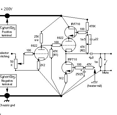

This buffer is what the late Allen Wright called a Super Linear Cathode Follower (SLCF) and I believe he got it from an early very high end Tektronics tube scope.
I built one as one off an output buffer for my Lightspeed Attenuator to drive low input impedance power amps <30kohm.
I must say it's the best tube buffer I've heard, none of that tube tubbiness, clean clear and dynamic, and not much colouration.
I built the original (1st pic) not the improved (2nd pic).
Cheers George
