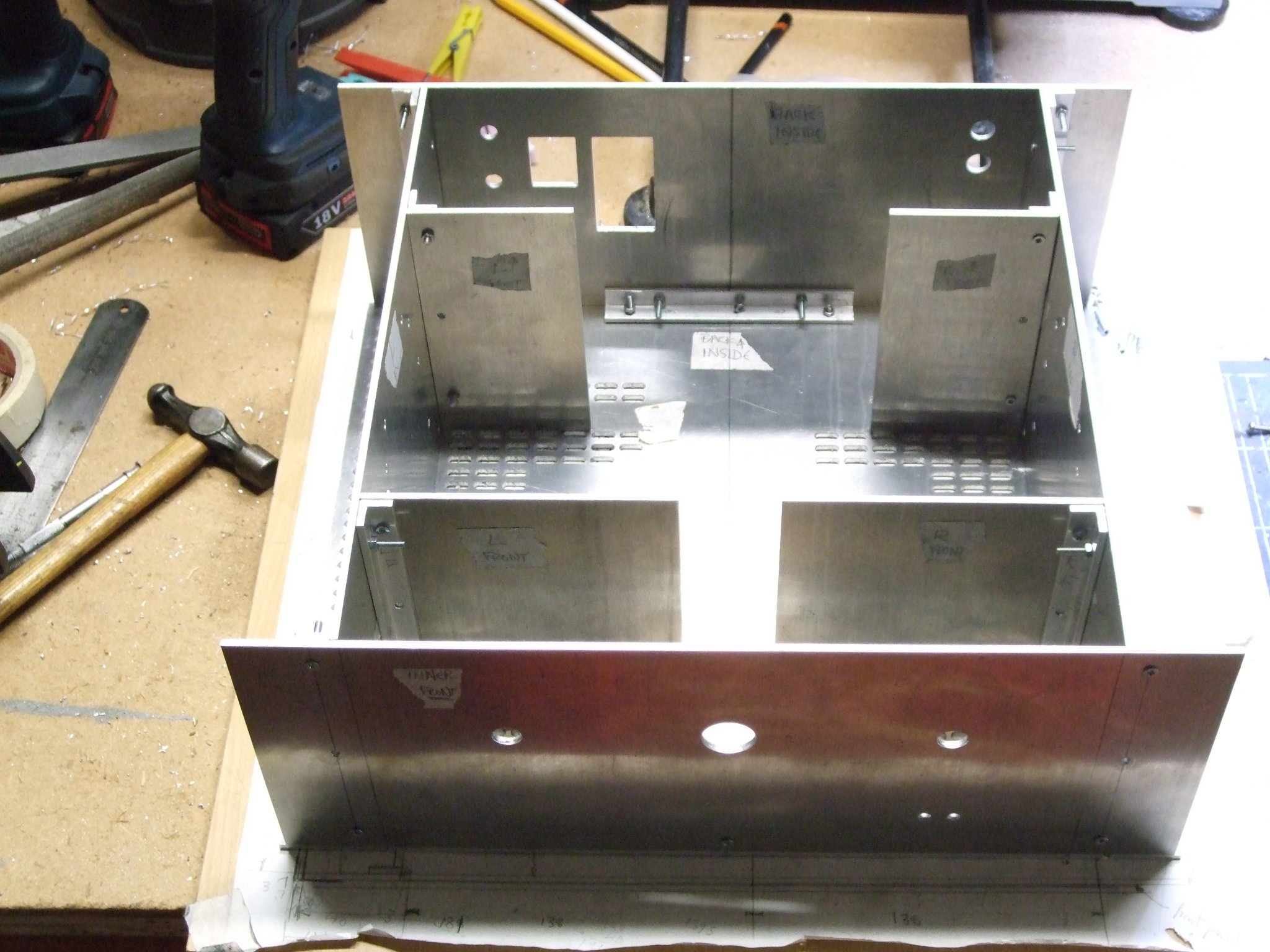

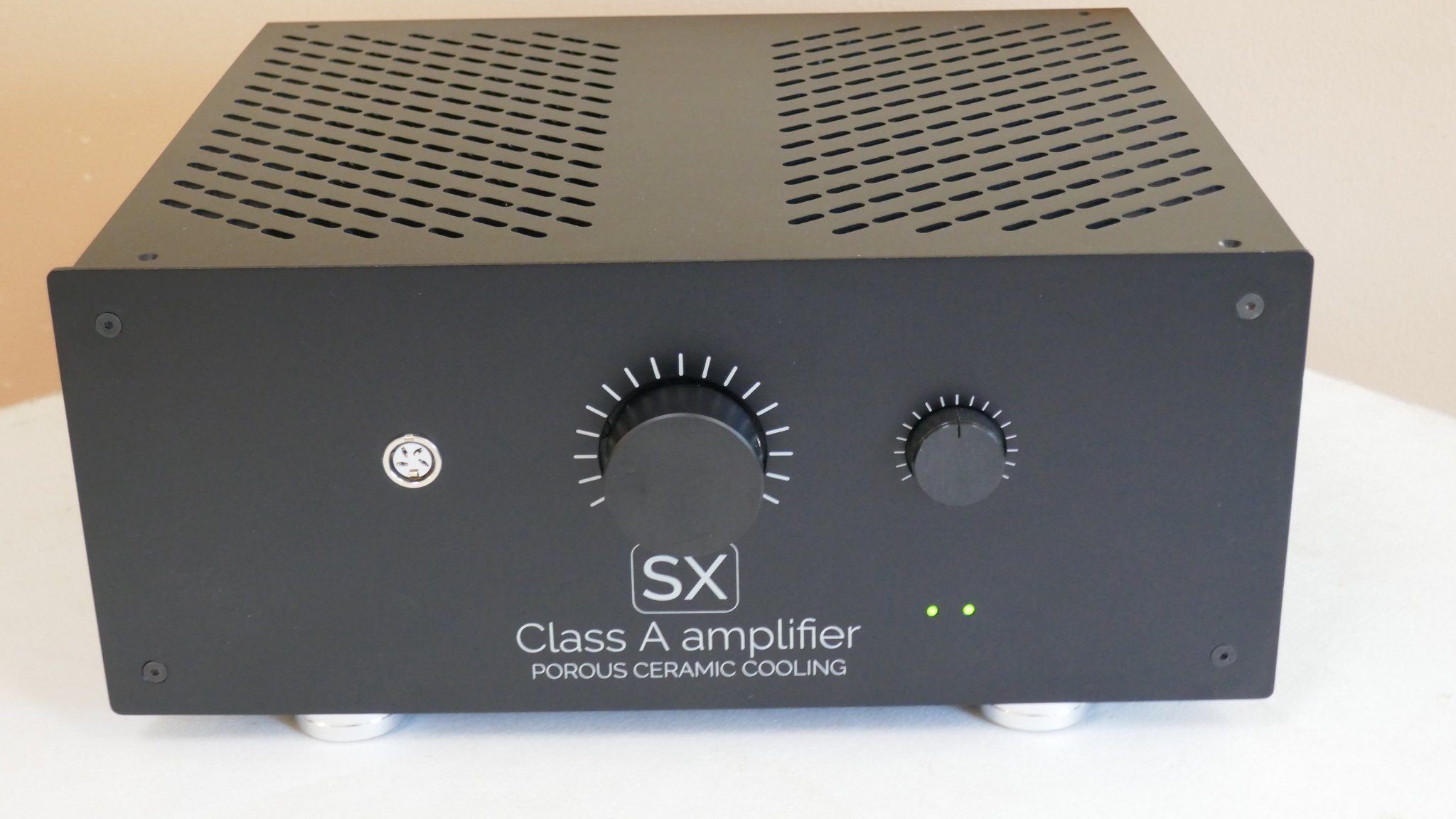

I wanted to rebuild my Ovation SX 15W per channel class-A amplifier which dissipates 120W as heat. The original SX build used an off the shelf case which was large and heavy so I designed a new one using the technique I previously used in my “headinclouds” KGSShv Carbon ES headphone amplifiers dissipating about 32W. The cases are all 3mm sheet aluminium alloy and the heatsinks are porous ceramic with adhesive pads. The SX rebuild adds two ripple eaters, volume and balance controls and headphone feed while being smaller and lighter.
I allowed 3W dissipation for each Amec Thermasol FCH505010T, so 22 dissipate 66W per channel for a reasonable temperature rise. They are simply stuck on to aluminium plates holding the power transistors and forming part of the case. Of course the heatsinks are now internal so the case needs a good updraught to allow the heat to escape. In practice the temperature rise is similar to the original large aluminium finned amplifiers. The area near to the power transistors runs at around 50°C and the outer heatsinks 44°C.
The case is 375W x 320D x 170H (inc. feet) [14.75 x 12.6 x 6.75in]

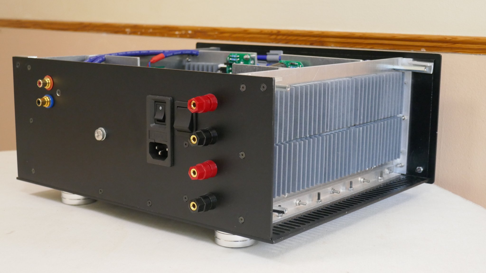

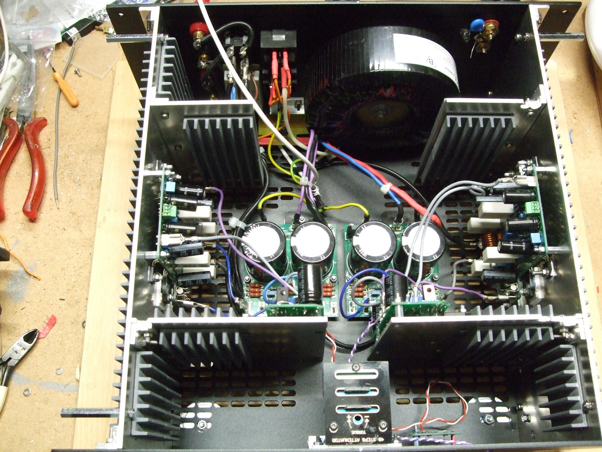

View attachment 1118140 View attachment 1118141 View attachment 1118142 View attachment 1118143 The case is 375W x 320D x 170H (inc. feet) [14.75 x 12.6 x 6.75in]

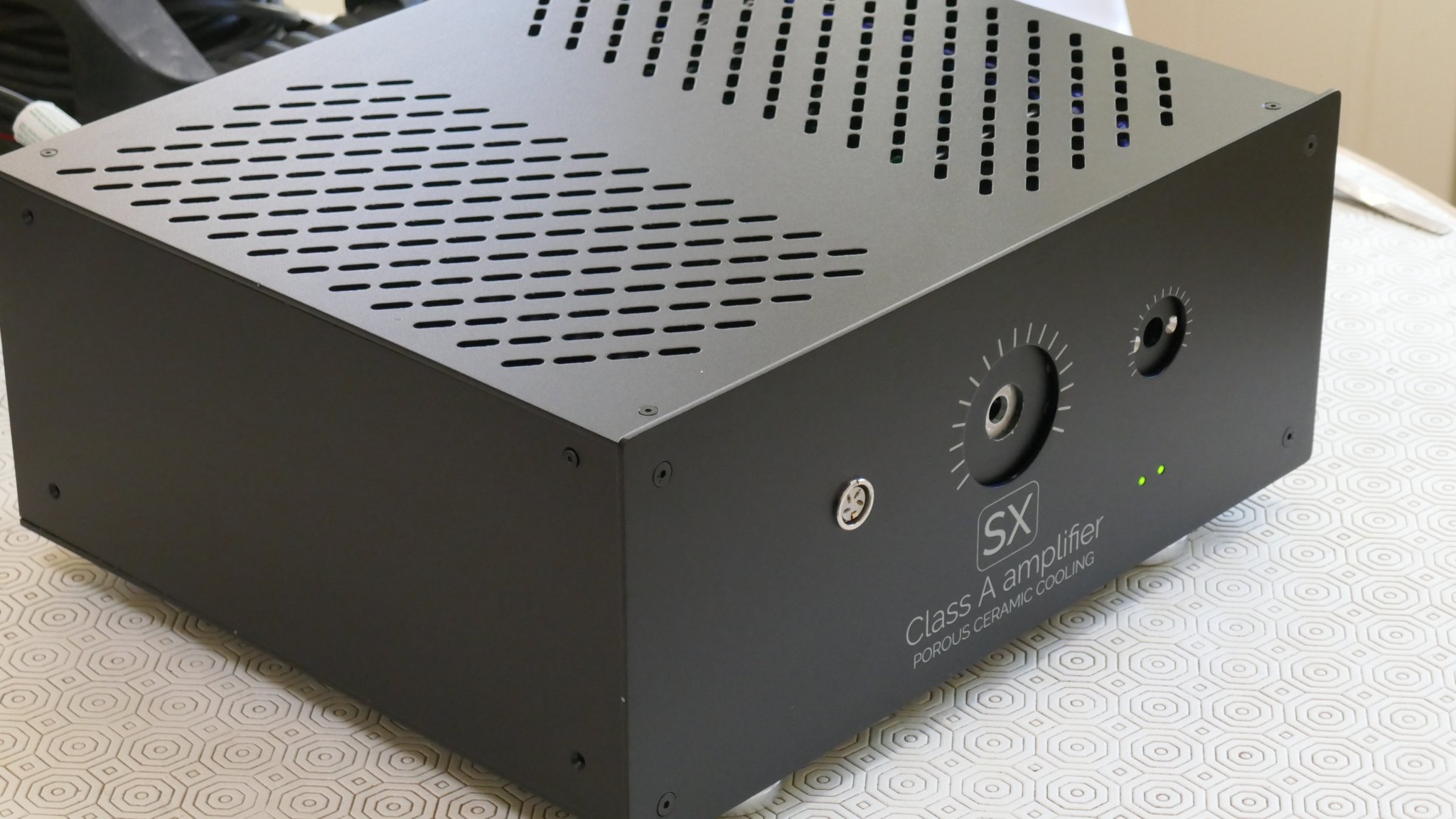

The heat sinks need to radiate heat as well as produce air flow. There is not enough ventilation by having small slots in the top of the case and sides covering the heat sinks on each side.
You would do better to use aluminium extrusions for the sides of the case. This was my approach with a JLH 15Watt Class A design where the dissipation per channel is 88W and case temperatures of the output transistors is limited to 60 degrees Celcius.
These heat sink extrusions are 300 mm long and anodised black which helps heat dissipation and I recommend having this paint process done for your project. All the same there is a large ventilation hole in my case bottom with cross hatch aluminium cover on the inside to prevent entry of insects and vermin and a similar pattern sheet on the cover for the top.
I am using a 300 VA power transformer to power this system and it gets quite hot. This resides in a separate case with heat sink and voltage regulators for the whole two channels. This is mounted horizontally in the separate case and there is an umbilical supply cord and plug connection to the amplifier case. This removes a heat source and any source of mechanical vibration/ noise from operation of the toroid. The supply rails are +/- 22V and the regulators are electronicallshort circuit protected. These are mounted on a heat sink forming part of the back of this separate case. I drilled small holes in the bottom of this case to allow air to flow around the toroid.
