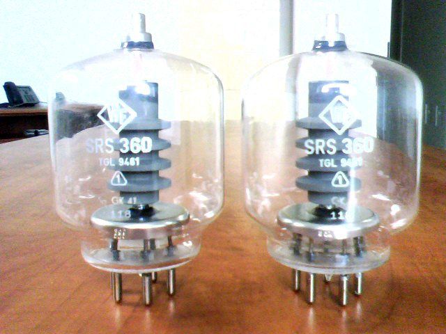

SRS-360 East German transmitting tubes
oshifis said:
Good info, thanks a lot. Can they be operated in "starved mode", that is let's say Ua=500V, Ia=100mA in AB1 setting (no grid current)?
Looking at the tb3-750 curves above you can see that at 500V, 100mA is ON the Vg=0 curve so grid current is required to get any output.
On the other hand at 1500-1800V on the plate and a decent 10K opt 20-40W triode SE power is acheivable i A1. if you have a driver that can source some 30 mA grid current you could get some 60-70w in A2 at similar plate voltages.
But please don't even think about it if you're not comfortable with the high voltages involved.
