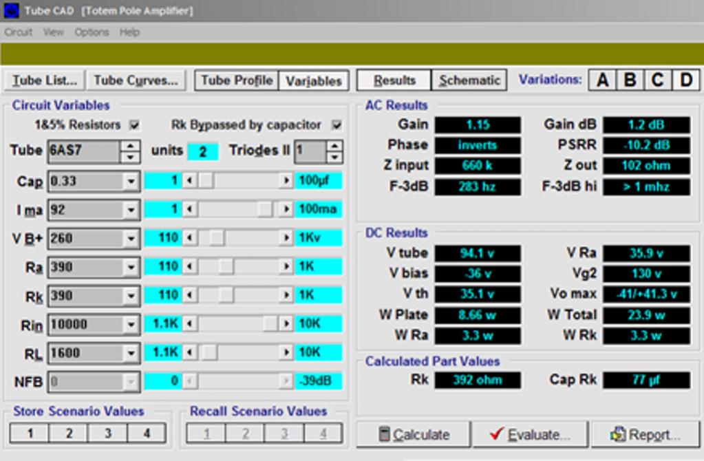

Cassiel Disabled Account Joined 2004 2010-03-01 1:59 am #1 2010-03-01 1:59 am #1 I like the sound of this 6as7 amp and I'd like to know the output power. OT is 1,6k. No oscilloscope and my software only does SE output stages. Any idea? Attachments New Picture (1).jpg 91.6 KB · Views: 133 Cassiel Disabled Account Joined 2004 2010-03-01 3:38 am #2 2010-03-01 3:38 am #2 I know how to calculate power out using the tube curves but what would be the right value for the load line? Status Not open for further replies.
