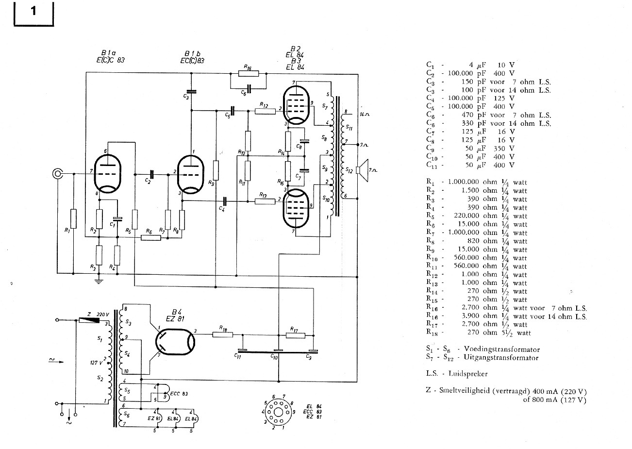

You probably mean SEPP (Single Ended Push-Pull) OTL audio output stages, in combination with 800 Ohm loudspeakers. Philips used them in many of their televisions, radio's and a range of Hi-Fi amplifiers. Attached are some examples.It has a lowish output impedance out hence use for driving TV speaker.
It was just the circuit shown in this thread.
ECC85 + ECH81 + 2 x EF89 + EM84 + EABC80 + ECC83 + EL84 + EL86 + EZ80 (B6X92A).pdf498.4 KB · Views: 148
ECC85 + ECH81 + EF89 + EF85 + EABC80 + EM80 + ECC83 + 2 x EL86 + EZ81 (B8X72A).pdf676 KB · Views: 106
Sorry, I meant can you give me an example of a TV in which an SRPP was used for the speaker output.It has a lowish output impedance out hence use for driving TV speaker.

And of course not the HF303 😊
The upper tube is controled by the output current for a Serial Regulated Push Pull and can only function in classA.
In the HF303 the upper tube is driven by a phase inverter and can funtion in classAB for more output power.
Mona
Mona
I thought the schematic looked strange for an SRPP.And of course not the HF303 😊
Mona

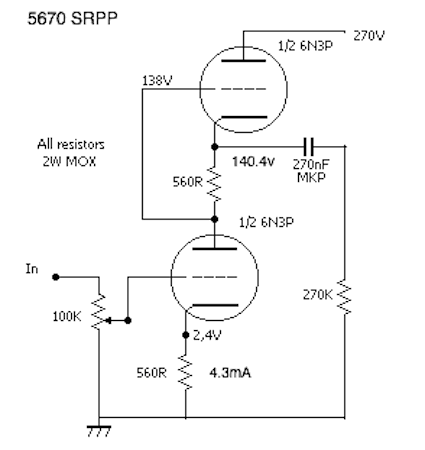

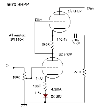

Instead of a couple of SIC diodes, I would try a known good sounding LED like a Broadcom HLMP-Q150, which will drop 1.6V and give it a listen. A low power LED isn't going to run across the knee, and I've found a combination of an LED + resistor can sound quite good. YMMVIs it possible to substitute in a couple of SIC diodes for part of the lower tube cathode bias and use a smaller resistor?
Voltages and operation should stay the same?
