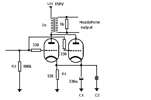

Ah, I didn't see your edit - I initially intended simply to go like this (see schematic).
Values are:
R1: 100k
R2: 50-100k
C1: 220uF
C2: 10uF
C3: 1uF
C4: 220nF
C5: 0.7nF
But to your edit: Is one parallelled E182CC per channel anyway better than "one half" per channel = one E182CC for stereo, or is this just for the LL1630 and we should try to find an alternative for it?

This is an idea of how it could be done. Have already recommended a substitute: triode-strapped 6E5P. But if you have the 182´s, why not use them?

Many thanks Lars - that looks good!!
Yes sure, I love going with the E182CCs, just thought you maybe had suggested the parallelled E182CCs just because we had focussed on the LL1630, while there might be a better tubes for this recommended solution if we only chose a different output transformer. But that does not seem to be the case, right?
A few questions to the design please:
- You omitted the snubber to the grid at R2, I had thought it would be good for resonance elimination?
- Only 120 ohm for R1? 😱 Is that enough...? One usually finds values in the 50k-10k range there...
- What would you recommend for C2? 10uF? C3 and C4 are not good?
- And finally: Do I have to put a resistor across the headphone output...? I am afraid it does harm to the sound in some ways... :scratch2:
Thanks again
