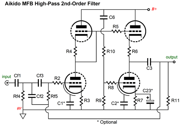

P.S.: The question arises in general (i.e. related to line and phono RIAA stages) but also specifically in my case, where the question is which topology is the best for an active high-pass filter. Regarding the question of multiple positive feedback (Sallen-Key) or multiple negative feedback (MFB), the question is answered here:
https://glass-ware.stores.turbify.net/nostmfbcr.html
But not regarding the question mentioned in the head line for topic.
This I want to know to make a decision,. whether I order the PCB boards under
https://www.tubecad.com/2021/08/blog0543.htm
or not.
