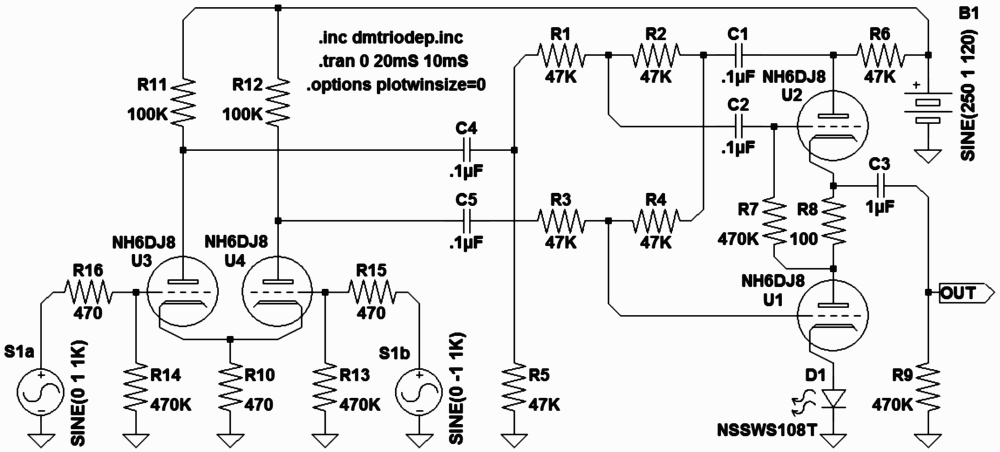

Since this thread has gone irrelevant numerous times already, I'll throw another curve.
You mention SRPP gainstage, not follower. But then Aikido and Broskie keep coming up.
The latter half of his circuit is unity gain follower for sure, with some tricks for PSRR.
I'm not sure why Aikido qualifies to be in this ring? But if it does, then so must this???
What we got here for SRPP duty, is a White Cathode Follower. But not just any old
WCF, this one is DIFFERENTIAL. And oddly enough had excellent PSRR properties too.
A follower by itself, has no voltage gain, only current gain. In fact this one actually
attenuates voltage by half if only a single input is driven. But a simple LTP up front
gives plenty of voltage gain. Similar part count vs Aikido, but full differential to SE.
Well anyways, its another circuit to chew on.
I've left 2VPP @120Hz ripple on the power rail, just to illustrate how it rejects.
Grid stoppers are not placed correctly, I should probably fix that next spin.
Won't make any difference to the LTSpice simulation, if you chose to run it...

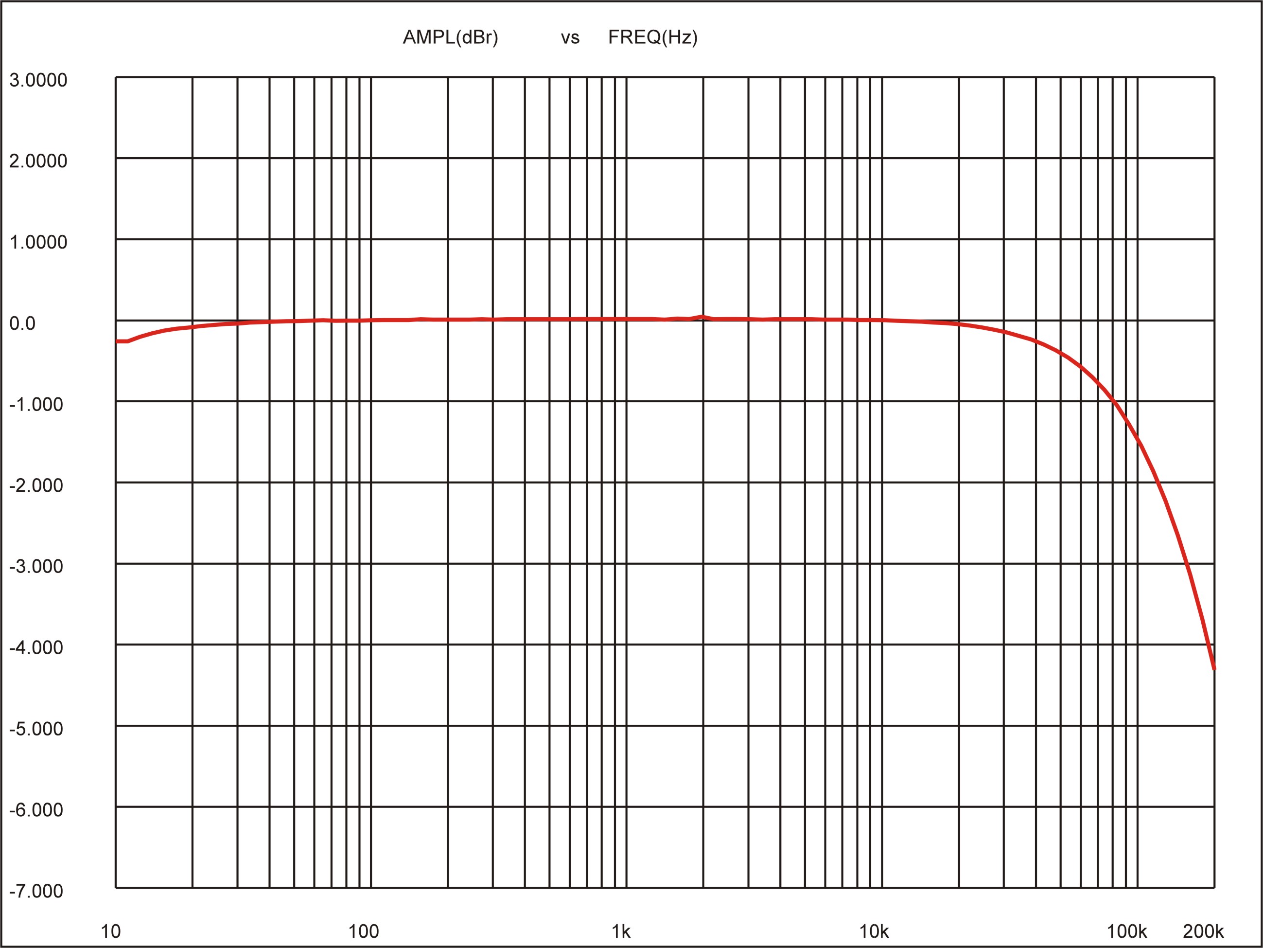

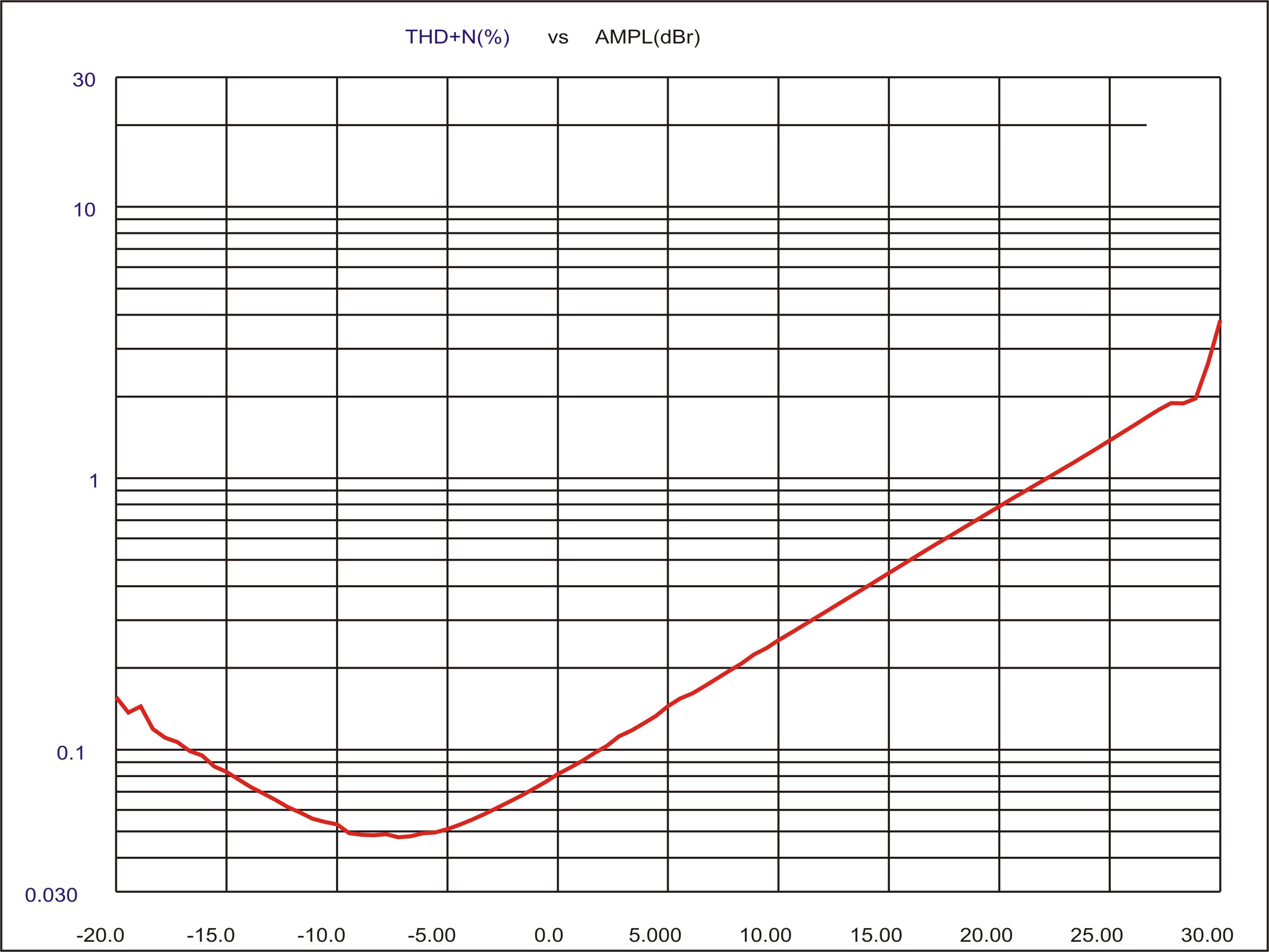

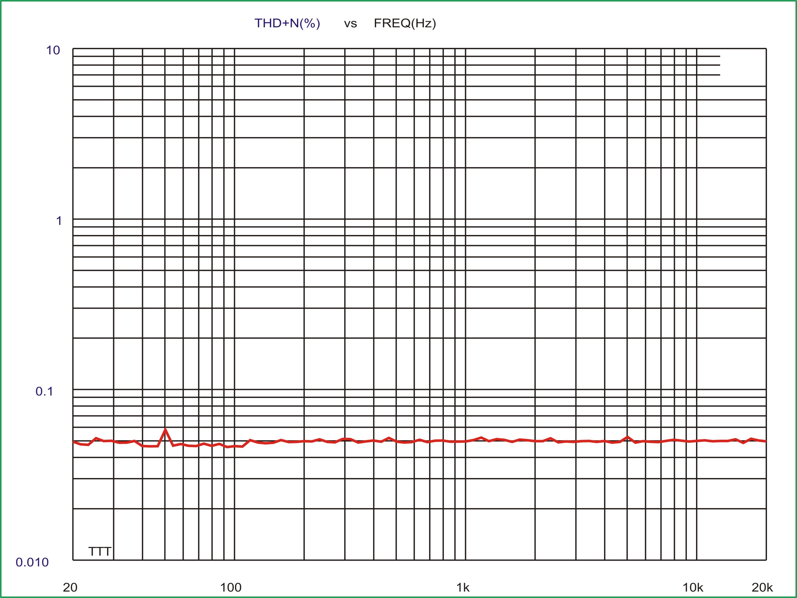

time ago I wrote two articles about Gomes circuit on Audioreview magazine in Italy.
In addition I wrote an additionla article where I developped a s.e. with a Gomes circuit ( 6N1P) that drive a 2A3.
In those articles I have tested 12 different tube: , Ecc88, ECC99, 6FQ7, 6H30, 12AT7, 12AX7, 5687, 5965, 7044, 7062 and 12BH7 ans 6FQ7.
Here you can fins, as an example, four test results:
1- 6fQ7A1 this is a frequency respinse; - 3B at 150KHz; very good
2- 6FQ7A2 thd versus frequency; 1 vout; it is very low
3- 6FQ7A3 thd versus amplitude; 0 dB = 2 volt; the increment is costant ( only IInd armonic; 20 dB means 20 Vrms out, 56 Vp-p)
4- 6FQ7A4 FFT at 1 vout , the first odd harmonic is at -100dB.
The resuslts are very interesting; in this case the Zout is 330 ohm and the gain is 16.
I check also for the Rx as the best load for the mininum THD; as you know the SRPP (and Gomes) are dipendent form the load as swing and distortion.
With 3900 ohm, with 2 Vout I got 0,008%.
I will back again with other results and additional consideration.
