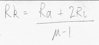

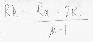

I have been trying to be a bit more scientific than usual when nailing the load for an srpp driver circuit. In previous amps I have taken published circuits as gospel but having discovered a few descriptions of balancing methods I have found 2 equations which disagree. The balancing revolving around correct load(Rl).
1. Rk = 2Rl + Ra / (mu - 1)
or
Ra + 2Rl
2. Rk = -----------------
µ - 1
by the rules of bodmas one of these cannot be correct.
Can anybody shed some light on which is correct or whether both are wrong or another way of determining the output load value for srpp.
Ed
The hand-written formula you attached is correct for an SRPP with unbypassed cathode, and an additional resistor in the anode equal to 2Rk. However, it doesn't make a lot of difference if you leave out the extra resistor, except for really low-mu triodes.
Incidentally, both of the formulae you typed are correct! If you apply BODMAS to the first one you typed, you will end up with the second...
