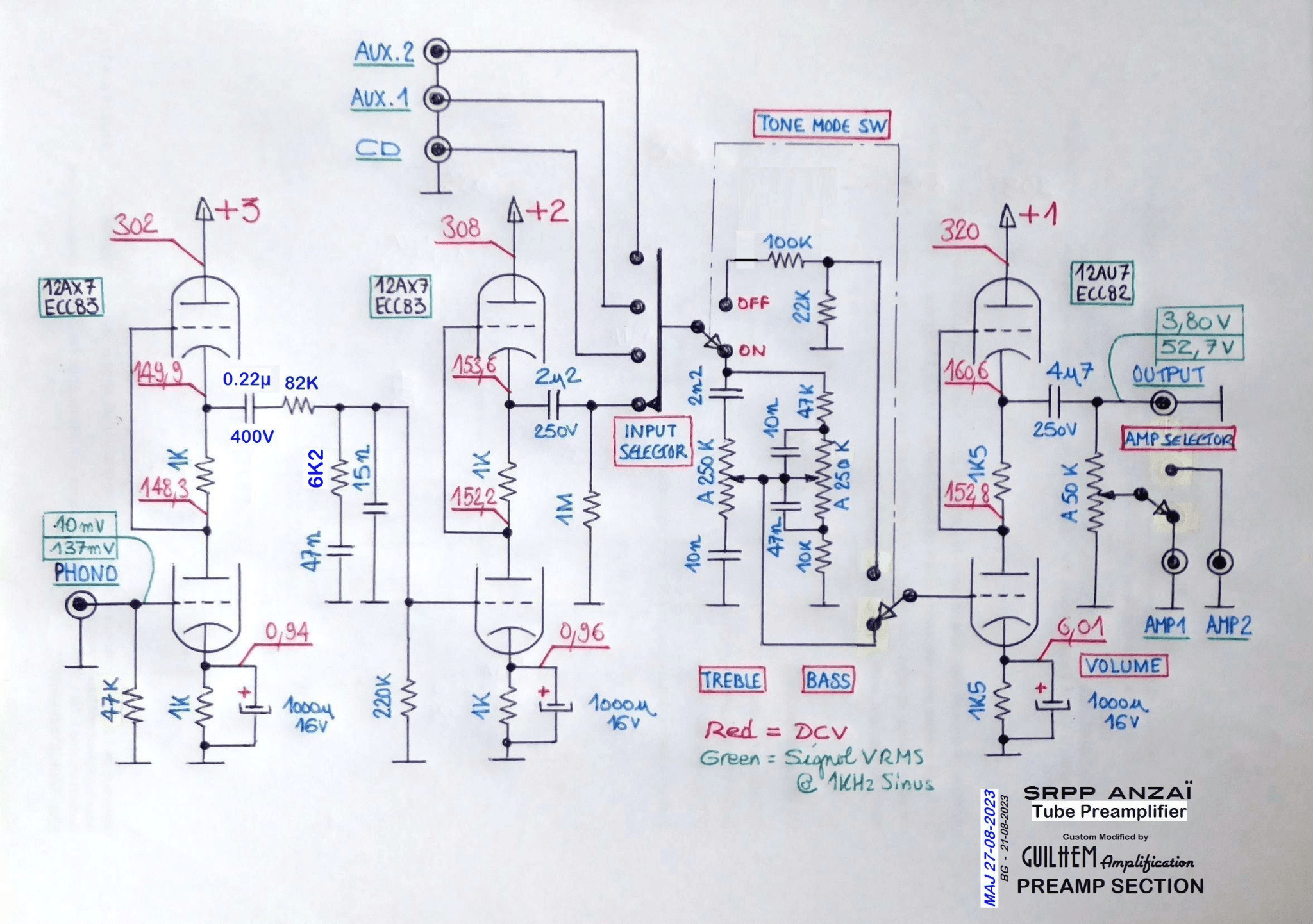

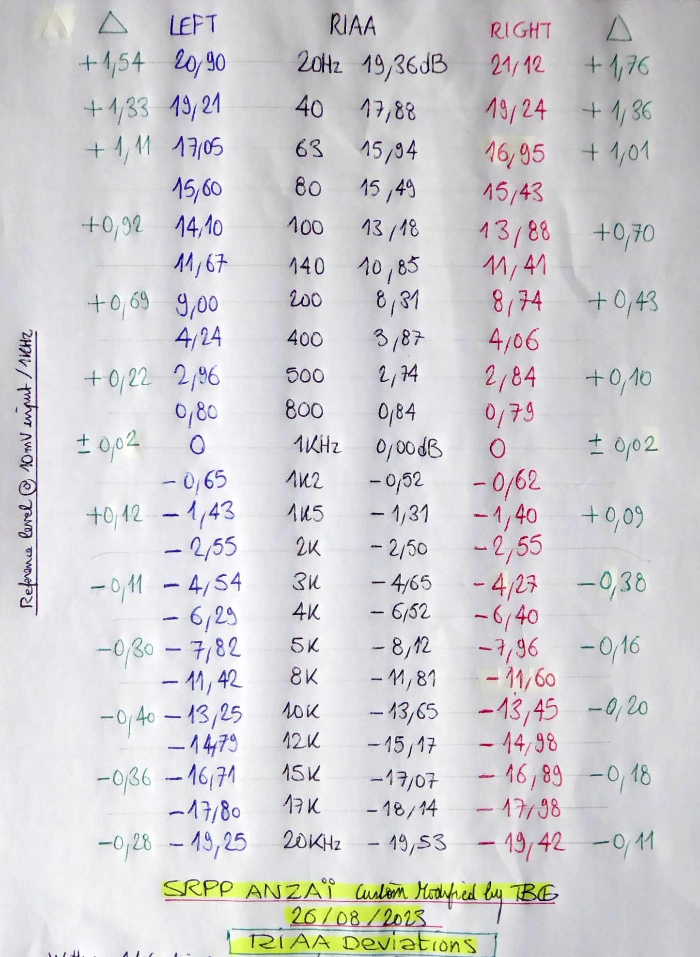

Update : some data measured today on my finished and lastly refined/modded SRPP ANZAÏ :
  • RIAA equalization in the PHONO section is met at +/-1dB between 20Hz and 20kHz.
  • PHONO input saturation @1kHz sinus is 130mVRMS for 50VRMS output.
  • CD/AUX input saturation is 25VRMS for 50VRMS output.
  • Bandwidth in CD/AUX section is 5Hz-45kHz@-1dB and 2.5Hz-85kHz@-3dB.
Unfortunately I no more have distortion measurement facilities - and I plan to have one, when is the real question - but by my experience, looking at the triangle and sine waves, the max THD% should be around 1% at worse.
Just in regard of the max output level capability (and hence the dynamic margin) of the SRPP-ANZAÏ measured at 50VRMS, my ARC SP3A1 offers 25VRMS and my McIntosh C712 offers 8VRMS according to their respective specs - certainly with a lower THD%, I guess...

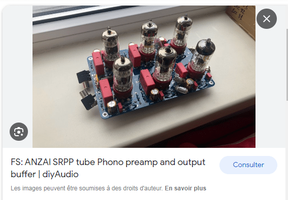

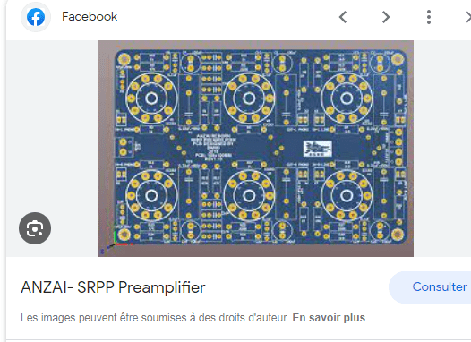

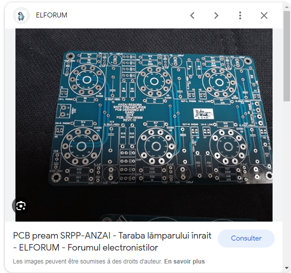

I will probably try to make my own lauyout.

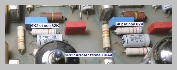

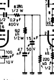

Note that on this schematic, there is a mistake - that I fiercely reproduced without checking 🙄 - The RIAA networks shows two 82K resistors, but the one in series with the 47nF capacitor is a 6.2K - not a 82K ! :
So here's my updated corrected schematics :
Now to answer your questions - confirming @Zitronenfalter 's reading :
- The Tone-Control pots are A250K, that is to say LOG. On my SRPP they are separate (L and R), but you can indeed use a dual gang, if you prefer.
- The switch used for Tone-Control ON-OFF is a 4PDT switch, that is to say a double DPDT.
Here is the RIAA compliance table, measured on both channels :
And here is the overdload levels table :
Note that the 12AX7 tubes are not specially matched for these tests...

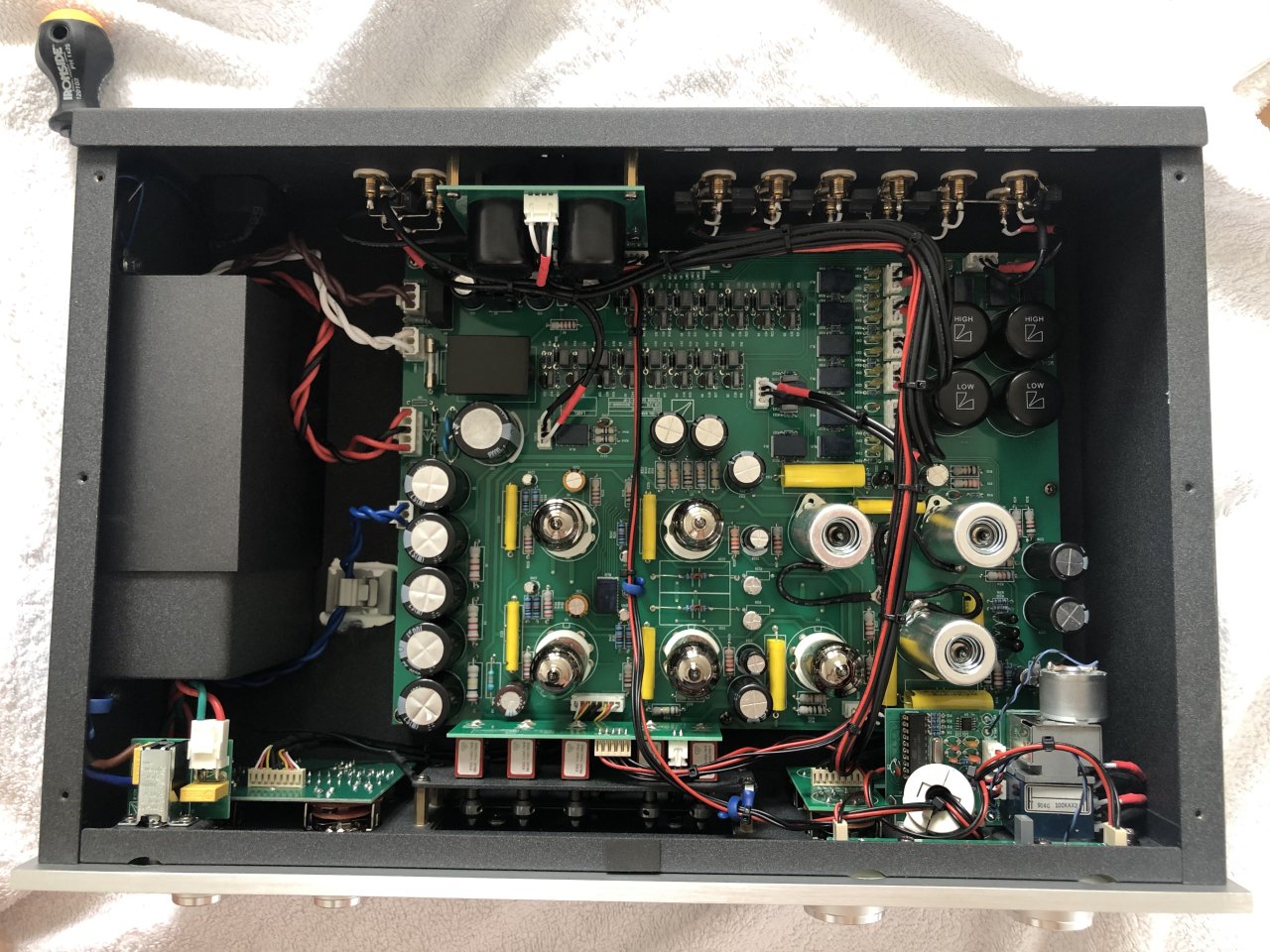

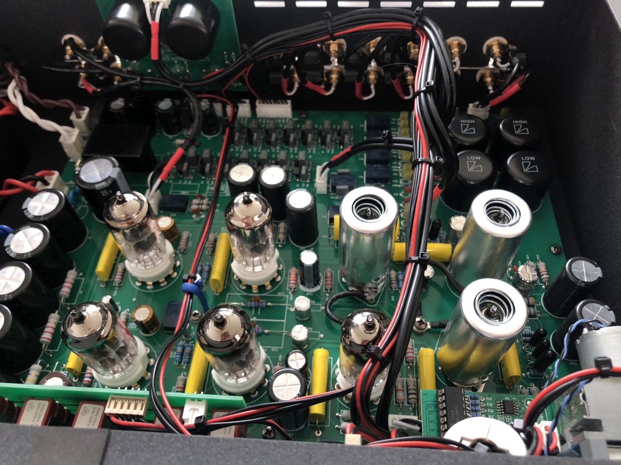

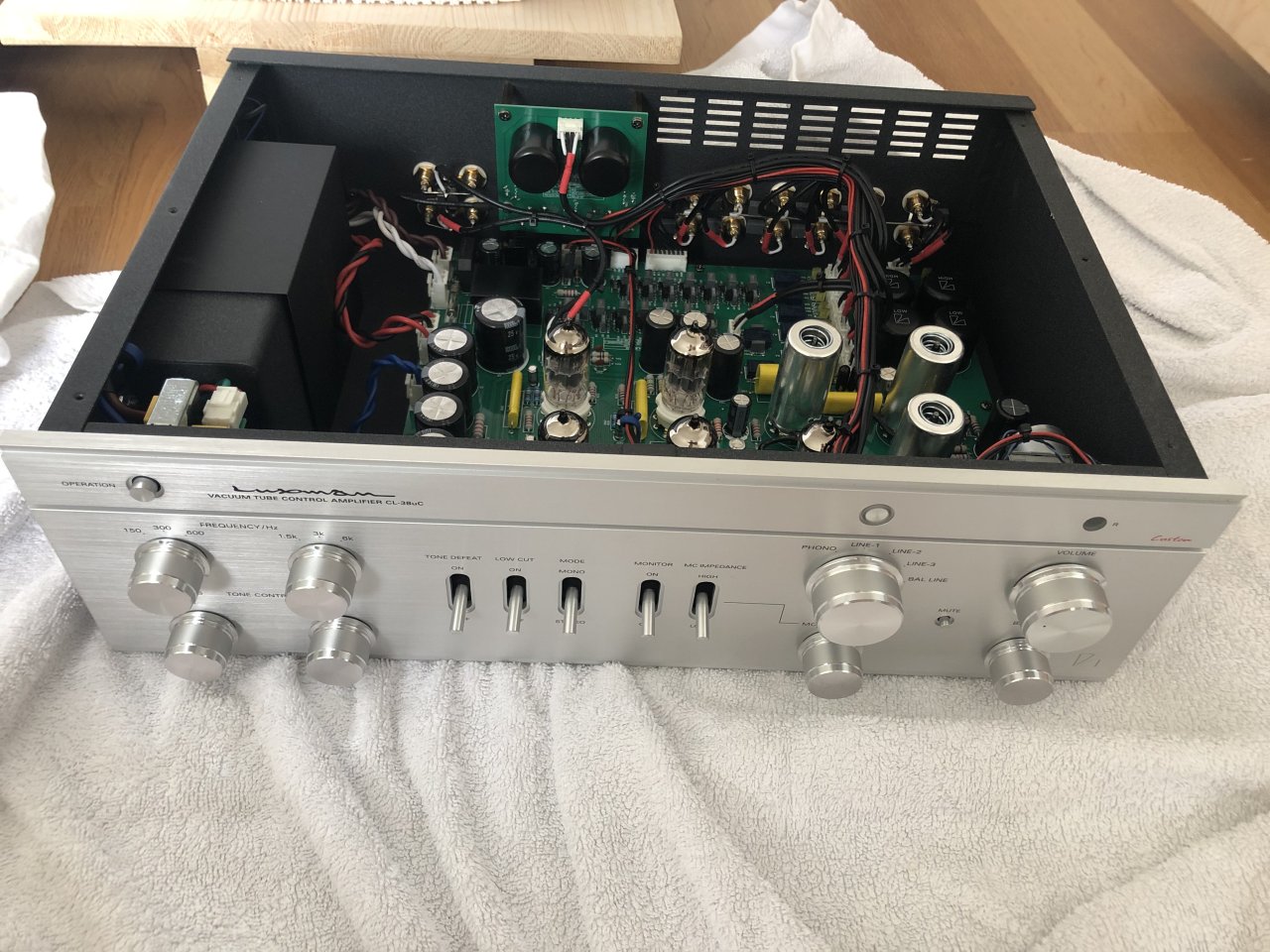

Interesting, those inside pictures remind me of my luxman preamplifier, it is also SRPP = cl38uc
I wonder did they have influence from Hiraga, what you tell me from sound seems similar from my luxman..
" For moving-magnet phono gain, the CL-38u uses three ECC83 dual-triode tubes in a shunt-regulated, push-pull (SRPP) configuration chosen to minimize the output impedance of each stage. Five ECC82 dual-triode tubes, also in SRPP configuration, provide line-level gain and the extra amplification required for the Luxman's tone controls"

Yes, @matsurus : the LUXMAN CL38U is a nice modern SRPP preamp tube unit... Very costy also !

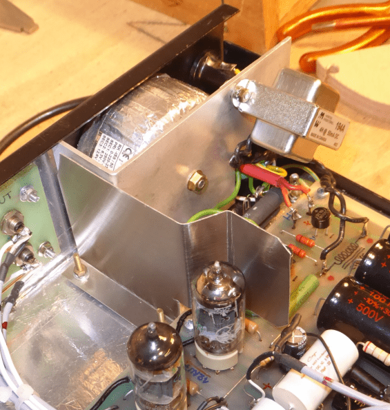

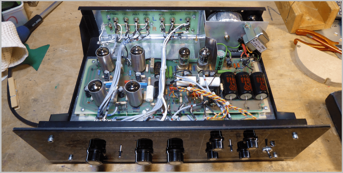

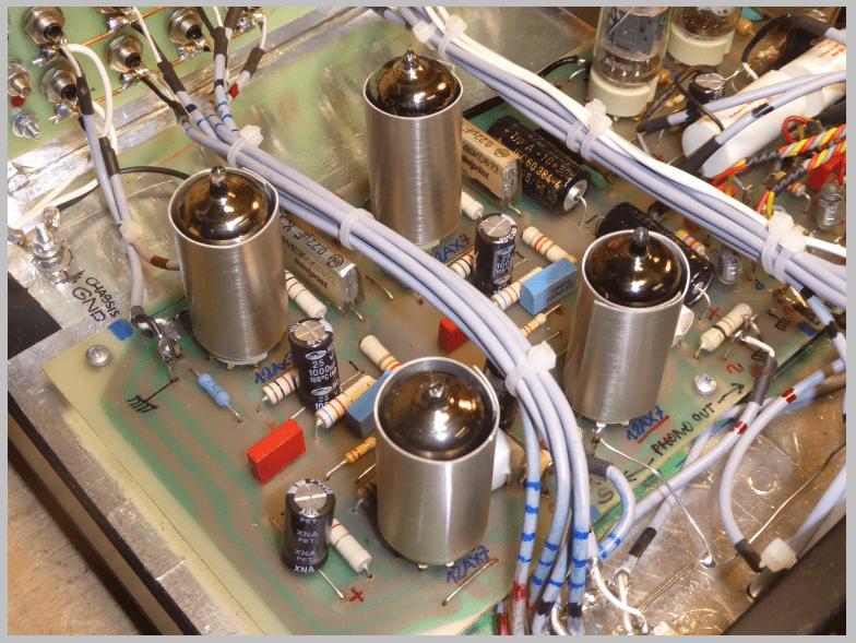

About my SRPP-ANZAÏ, I added some additional shielding in order to reduce the slight hum that superimpose to hiss at maximum volume on a 100WRMS ampfifier - absolutely not annoying but hey, why not try to eliminate it ?
Maybe a slight improvement, but rather no significant effect.
I shorted the phono input instead of connecting my turntable : no noticeable difference too.
Verdict : if you can build a separate power supply, it's better against hum...

This is a very interesting thread. I‘m thinking of maybe try to build it point to point but without the tone controls. Would the 100k and 22k resistors between second ant third stage be needed then? What purpose do they have?
Thanks @Sykomor !
Easy : when the Tone-Control is defeated, the 100K + 22K attenuator divider has no other purpose than matching the attenuation of the Tone-Control circuit with all pots in neutral position. So the gain of the output stage is constant, T-C defeated or not : circa 2.
I did not measured the gain of the output stage alone, but I think that the 12AU7 probably provides a voltage gain of circa 10-15, which could be too high in regards of the signal levels standards of today...
If it is too much, then you would place the Volume pot instead of the T-C circuit, as a satisfactory solution. In this case, you would not need any of the parts of the T-C circuit, not the matching attenuator and switch. Otherwise, you let the Volume pot at the output, and preserve the 100K + 22K attenuator
I must confess that I did not made the test, as I wanted to preserve the T-C facility, sorry...

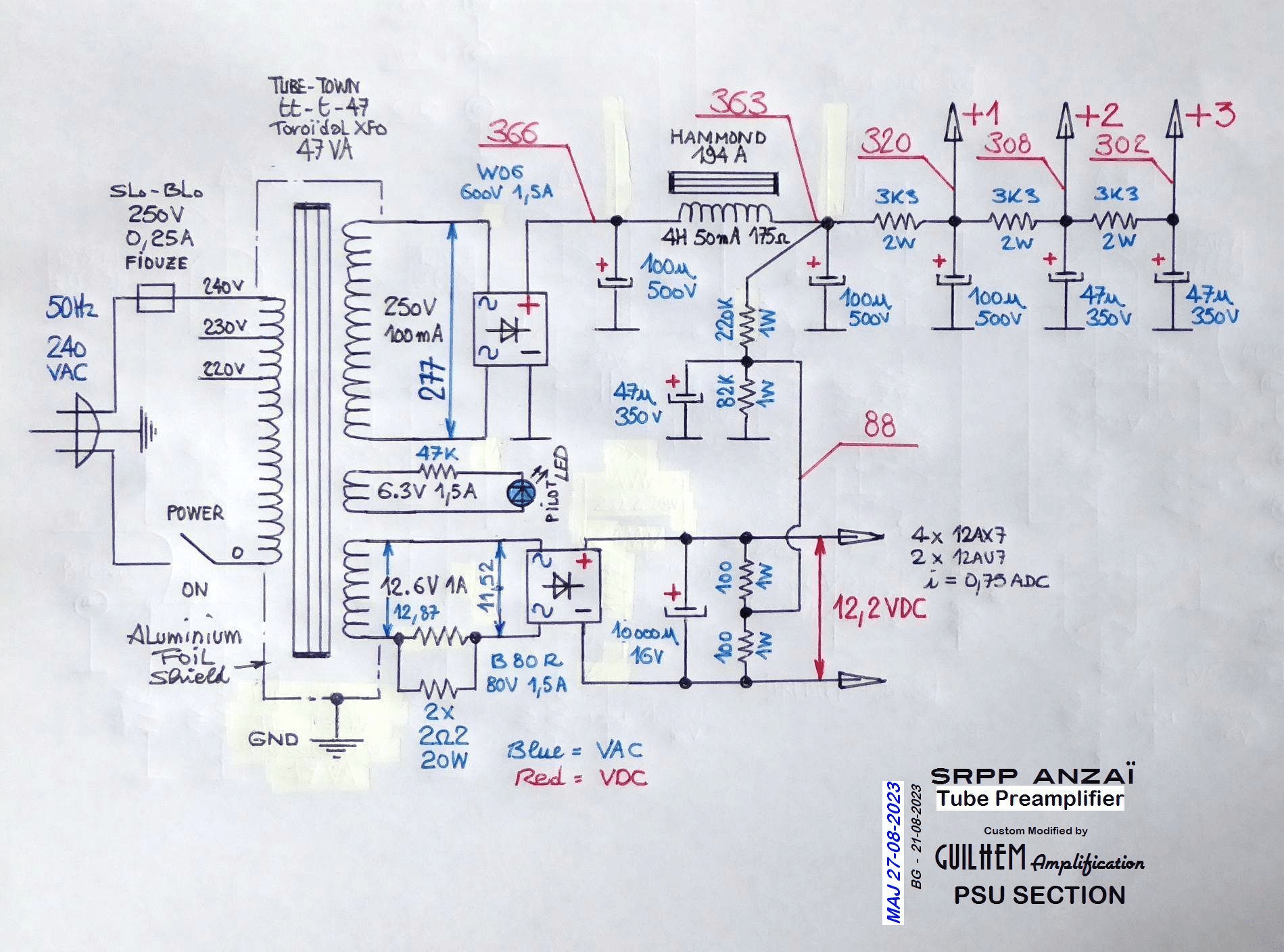

Some questions. Why do the 12ax7 and 12AU7 go with 12V instead of 6.3V?
can I replace the 4H chocke with a 175ohm resistor??
thanx a lot for the info!!!!
Thanks @mrpunkk !

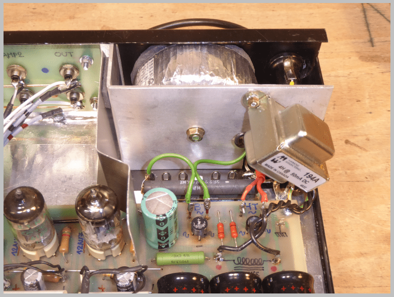

You can indeed heat the 12AX7 and 12AU7 in 6.3V, assuming you can provide 6.3VDC filtered. 6.3VAC would be too hummy for a preamp. It was just easier to obtain this from 12VAC for me, and it was the original design, that's all...
The original resistor that was in place of the 194A (175R/50mA/4H) choke was a 3K3/2W. If you remove the choke, return to this value, otherwise the filtering effect offered by a simple 175R resistor will not be enough. Note that you can use any other choke, say a 30H/500R or whatever you have on hand or can find locally. I used the 194A just because it is compact to place in the cabinet.

Yes, you are right @Technical : I changed the 12AT7 for the 12AX7 in the RIAA section simply for a matter of global gain and noise level, to be similar to my other preamps.
The output stage is a 12AU7, because here I just need a bit of recovery gain to compensate the tone-control, and this tube offers a high input swing admittance. With the tones in neutral position, or tone off position, the gain of this stage is 2.
I must confess that did not field tested the 12AT7 and shifted directly to 12AX7, but I don't see reasons why it would not work : it's a matter of tests !
