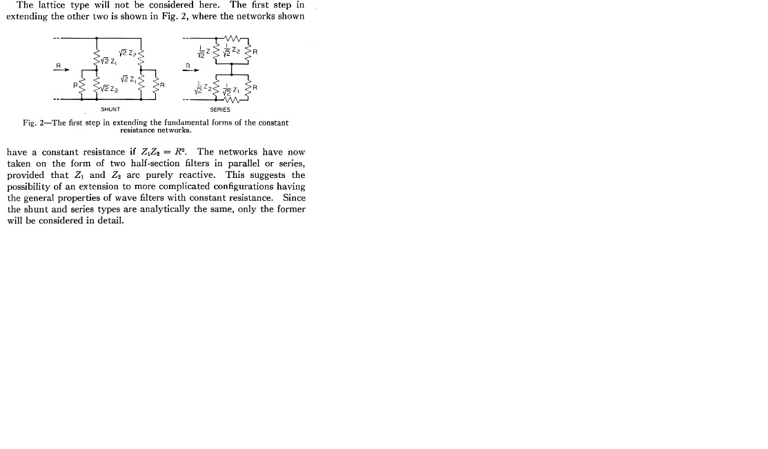

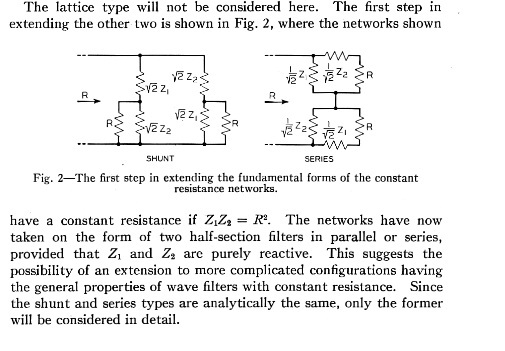

Well, I have been reminding myself what the famous Bell Labs engineer, Edward Lawry Norton, wrote in 1928 or so about Constant Resistance Circuits. He says the series and shunt networks are EQUIVALENT! 😀
http://www.alcatel-lucent.com/bstj/vol16-1937/articles/bstj16-2-178.pdf
It takes little work to see that if Z1 and Z2 are made into, say 0.33mH and 10uF with R as 8 ohms, you have two topologies that add up to the same result! Series and Parallel filters amount to the SAME THING. No magic sauce here. Game, set and match to ol' Norton here, and an end to the argument, I'd say! 😎
Not quite. The XO point and influence of any point in a series XO affects the entire rest of the XO. In a parallel XO the drivers & their respective network are independent -- one could for instance overlap or spearate XO point for drivers.
This difference can give quite different results.

You really have different design parameters for each network. But I maintain they are analytically equivalent. You can't beat the maths of it. 🙂
But FWIW, I think source impedance should get more attention. And series lets you see symmetries that are obscured by a lot of parallel designs. It's also nice that higher order series circuits are less demanding on imperfect inductors too. So both designs should be in your armoury, and deployed when appropriate.
OK, I'm the opposite of a Voodoo Audio guy, but what Dave says makes sense. It's very important to account for the actual driver impedances (not resistors!), and these do interact in a series network in ways they don't in a parallel network. And ditto to your mention of source impedances.
Now, the idea that one topology is intrinsically superior to the other is nonsense. You use the topology that gets you the right transfer function with the fewest number of parts. If memory serves, there were some examples at Rod Elliott's site.

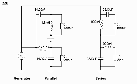

Here's Rod Elliott's simplified second order series design. He would of course correct Le and Re impedance, perhaps even Fs and Qts for the drivers in practise.
http://sound.westhost.com/parallel-series.htm
It's just my intuition, but I'd suspect a series crossover might work particularly well where the tweeter and woofer have much the same inductance. This is doable with, say, small Fostex full-range units which often have a relatively tiny inductance of 0.05mH. This means any Zobel impedance correction networks would be similar in both shunt arms. But then that would apply to parallel networks too. 😕
I quite liked the Norton paper, because it gave you a way to calculate values for third order networks in series crossovers driven by voltage amps, which is otherwise hard.
