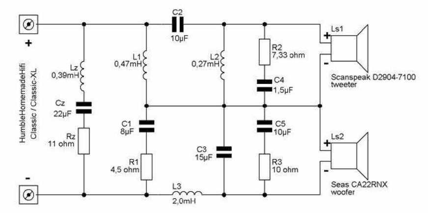

And Tony Gee at Homemade Humble HiFi has done endless designs. The Classic here is a good one to look at:
Humble Homemade Hifi
What you seem to do is give the input LC circuit ca. 5 ohm resistive damping to counter the fact it is getting less direct damping from the LC nearer the drive units. Otherwise it's gonna ring horribly. Still haven't done the exact transfer function, because I've yet to finalise a good higher order example circuit.
Oh, worth mentioning that the optional shunt LCR circuit at the input of Tony Gee's Classic design is just to tame the impedance peak for valve amps. Voltage amp users won't need it.

Let us know if Tony Gee's Classic series circuit 'rings' just as he designed it.
I'm not sure WHAT it's gonna do, speakerdoctor...😀Let us know if Tony Gee's Classic series circuit 'rings' just as he designed it.
A quick estimate on the 0.27mh and 15uF near the 8 ohm drivers says that part of the circuit (Z=4.23R) is damped with a Q of 0.5 and resonance around 2.5kHz. So I'd reckon the 0.47mH, 8uF, 4.5R input (Z=7.6R plus resistance) might just be right too around 0.5 Q. But I won't be risking my amp till I understand it all. 😉
It's become evident that there are at least two accomplished DIY speaker builders (Gee and Graveson) out there in the WWW who, on occasion, opt for a series xo.
It may be worth asking them why since they do build a LOT of speakers and listen a LOT to how they sound.
At least I would value their subjective opinions. Who knows, one or both could surprise us with their rationale.

He's going the opposite way to Tony Gee on inductor values too. But then no pure resistance on the input. 😕
HI,
R1's main job appears to be to attenuate the tweeter, though
being placed where it is suggests it might damp something.
I can't really see how L2 and C3 interact as described.
Given the voltage split for L1 And C1+R1, after than
you got what looks like a second order parallel filter
+ zobels on each driver, but joined together at the
split point, which in parallel would be common return.
Its certainly not intuitive if your used to parallel x/o's.
rgds, sreten.

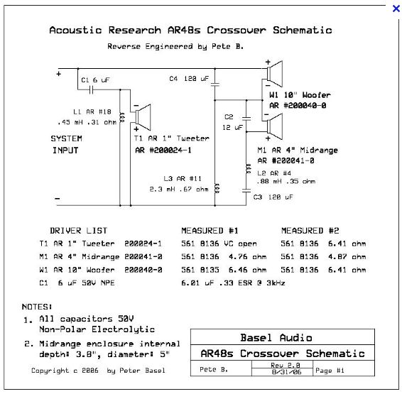

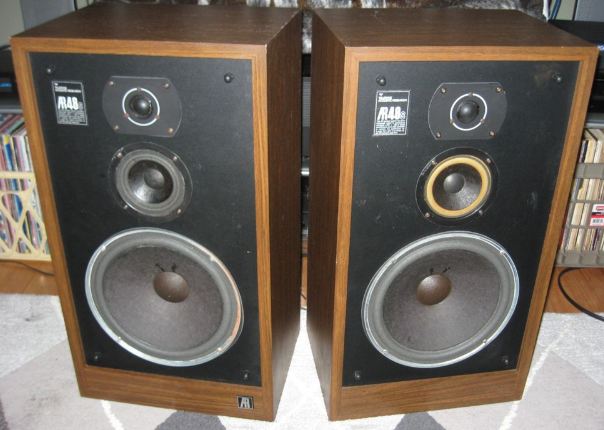

This is INTERESTING! 😀
People here will know my admiration for the musical qualities of the deceptively ordinary looking paper-coned Acoustic Research loudspeakers. Lo and behold in 1981, AR were using a series crossover in their AR-48s model betwen bass and midrange with a quite extraordinarily big inductor on the bass or midrange, depending how you like to look at it...😎
