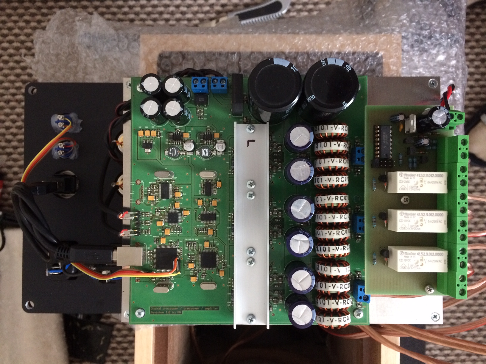

The DIX4192 in my valve DAC, see page 3 of the attachment, has no connection between RXCKO and RXCKI and its DIR works fine with the register settings I posted earlier, in post #2. The signal sdclock that is connected to the MCLK input is a 27 MHz clock that has no relation with the sample rate of the incoming signals.
The signal from the DIX4192 first goes through an FPGA board and is then routed to the SRC4392 via I2S. The SRC4392 also has no connection between RXCKO and RXCKI.
This is an old diy project - I started some years back and slowly proceeded to the final stage now 🙂 It is a fully digital loudspeaker. Schematic attached (SRC4392 as receiver and ASRC), TAS3103 as equalizer and TAS5518 as 3 band crossover and PWM driver for class D end stages.
It works somehow, however occasionally it happens that there is no sound. I tried to re-flash the firmware for Atmel controller, power on, power off several times and sometimes it works but after some time it stops working again (after a new power on). That is why I'm trying to investigate what can be wrong - started with SRC and recognized that there is no Data signal between SRC and TAS3103. So I'm digging deeper and found out that it is probably DIR part of SRC4392.

Thanks Mark. After power on the sequence is:
- all power supplies on immediately, MCLK applied to SRC4392 immediately
- delay (wait) 1 second
- configure external SRC4392 pins via microcontroller (CS0, CS1, /RST, MUTE)
- Reset SRC4392 through /RST pin (registers in default state)
- page select 7F 00, power off DIR, SRC, DIT, PORTA through register 01 00
- configure all SRC4392 registers
- power on DIR, SRC, DIT, PORTA through register 01 7F
When I check status of registers - ok, power supply - ok, PORTA output as mentioned before - LRCLK ok, BCK ok, data not ok, /LOCK pin high

Thanks John. Clock is configured as follows:
- one common MCLK clock signal generated by PLL1705 - 24.576 MHz used for all DIR, SRC and PORTA (in master mode)
- input SPDIF signal 44.1- 192 kHz, output PORTA signal fixed 96 kHz
As I have issue with no data on PORTA I also tried to feed DIR directly to PORTA -in this case I use input SPDIF signal 96 kHz, output PORTA signal 96 kHz, MCLK for both of them. LRCLk and BCK signal as output of PORTA ok, Data signal on PORTS not present.
I’m still thinking how to isolate the problem by checking wheteher DIR only works fine -not sure how to do it - /LOCK pins shows high.

I checked:
- power supplies - correct levels, clean DC voltage
- MCLK frequency ok 24.576 MHz, good shape, no oscillations
- /LOCK and /RST high, clean DC voltage
- I2C bus, checked configuration of registers and everuthing is ok
There are 2 strange things happening but I believe these are not onnected to issue f not having output signal, or?
1. Although I set pins PF3 and PF4 of Atmel as low to define CS1 = 0 and CS0 = 0 it doesn’t work with SRC4392 address 0xE0 but only with address 0xE4 (meaning that pin CS1 is somehow forced high - although sw in Atmel is forcing is low)
2. When I read registers of SRC4392 all of them are ok - reading same values which are programmed. However there is one exception - if I try to read register 0x01 I’m getting value 0x00 while I programmed it for 7F. Furthermore after the read opperation of register 0x01 all registers are set to default value - seems like reading register 0x01 resets the SRC4392?

Strange; writing a 1 in the MSB of register 01 should reset the SRC4392, but reading it should not.
Do you wait for at least 500 us after the end of the reset pulse, per page 23 of the datasheet?
Yes I do wait 20 ms.

Also the occasional loss of audio signal in SRC4392 is happening with both of them (independently)
That's a pity...
No shorts between pins due to solder bridges or so? Or crosstalk due to long parallel tracks at very small distance? I2C interfaces normally have built-in spike filters, but I don't know about the other lines.
