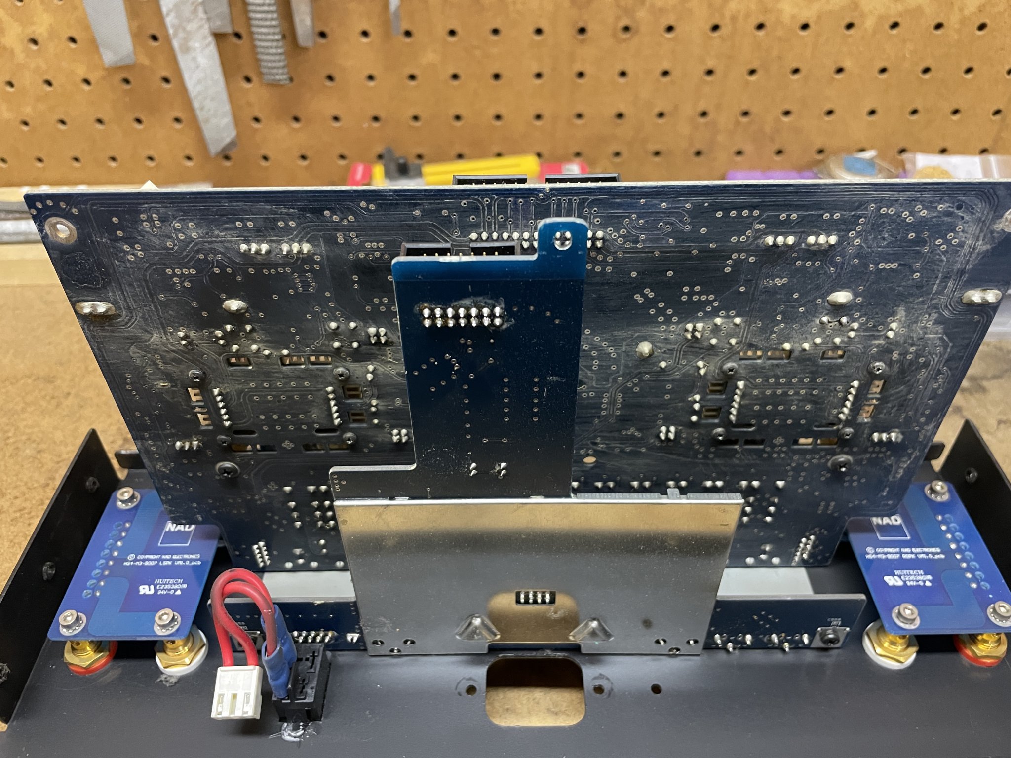

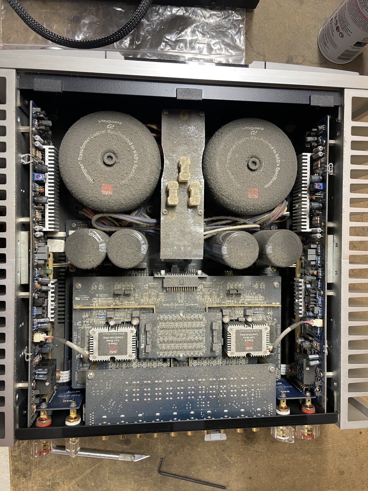

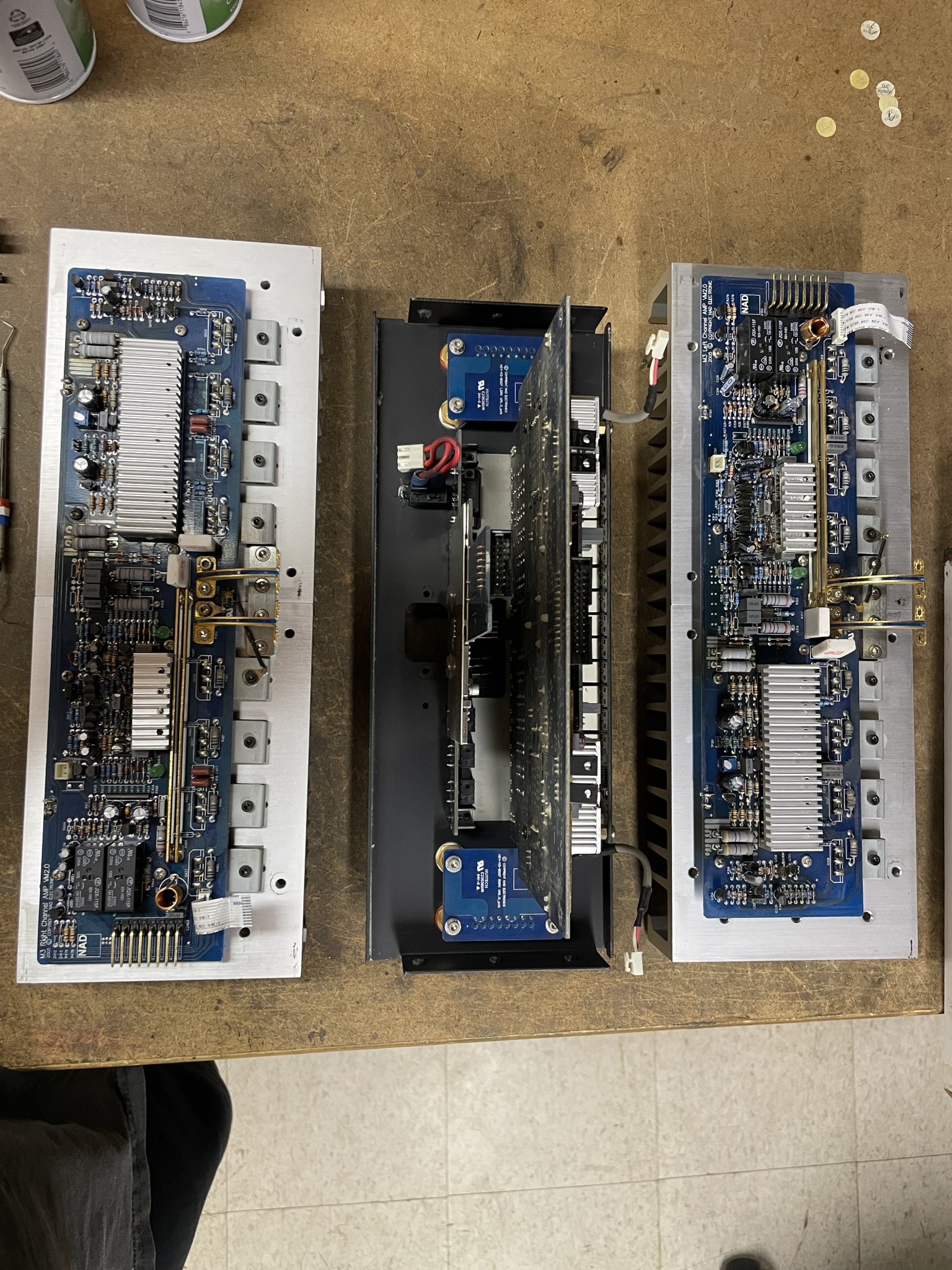

I figured out how to safely dissemble the amp, taking the back of first and removing all screw's from the IEC power connector.

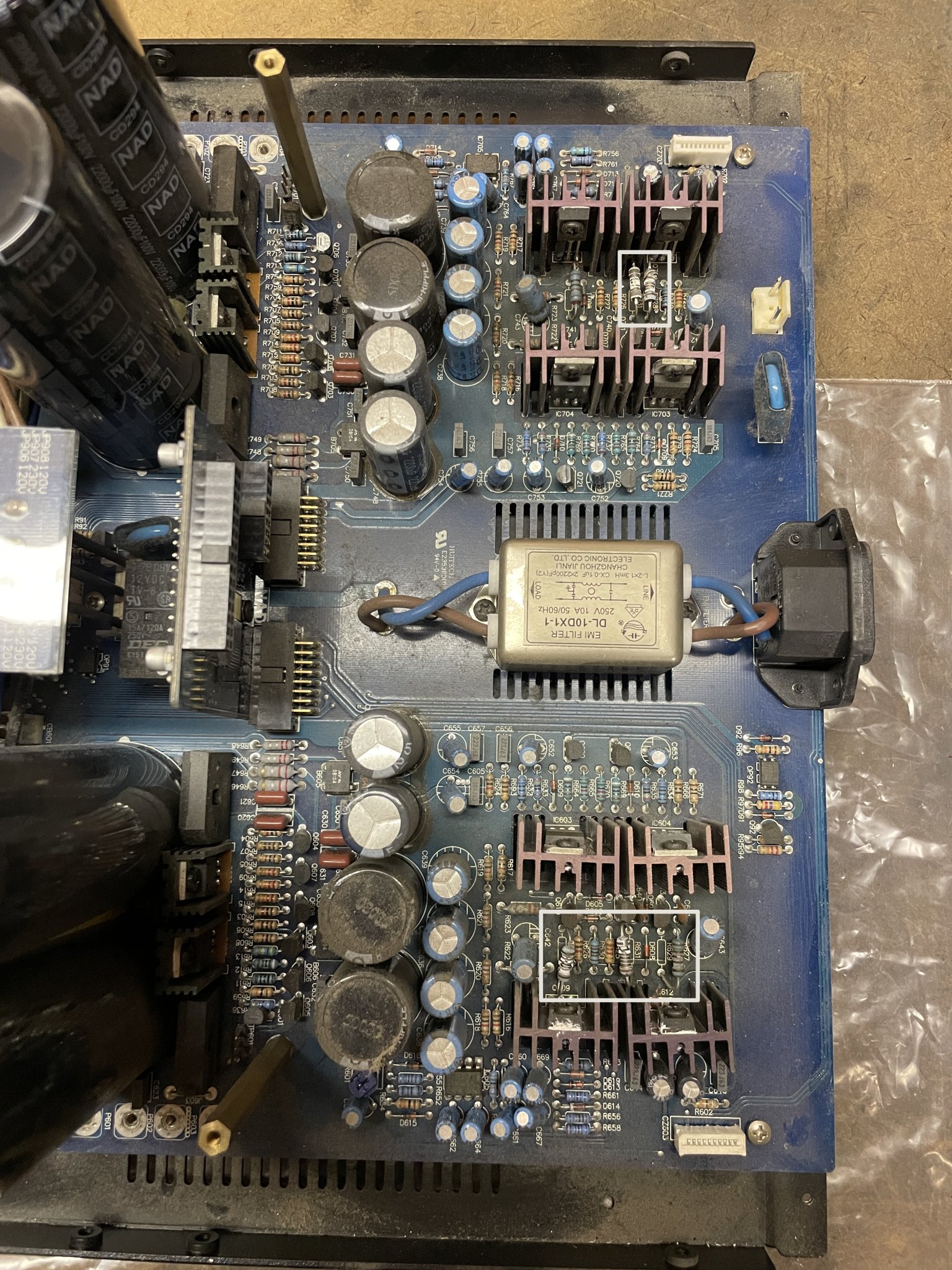

I took pictures but could not see anything obvious that has failed (specifically on the left channel) except the highlighted resistors on both sides that have their outer coating flaking off off.
Any recommendations based on experience as to what components might have failed that I can check?

Those resistors you've noted look suspicious to me. They appear to be associated with the 71V regulators. Are the voltages correct? The reference for those regulators are 20V regulators. In short, are all supplies correct?
I would next check DC voltages at the amp outputs. That's quickest insight to the problem area.

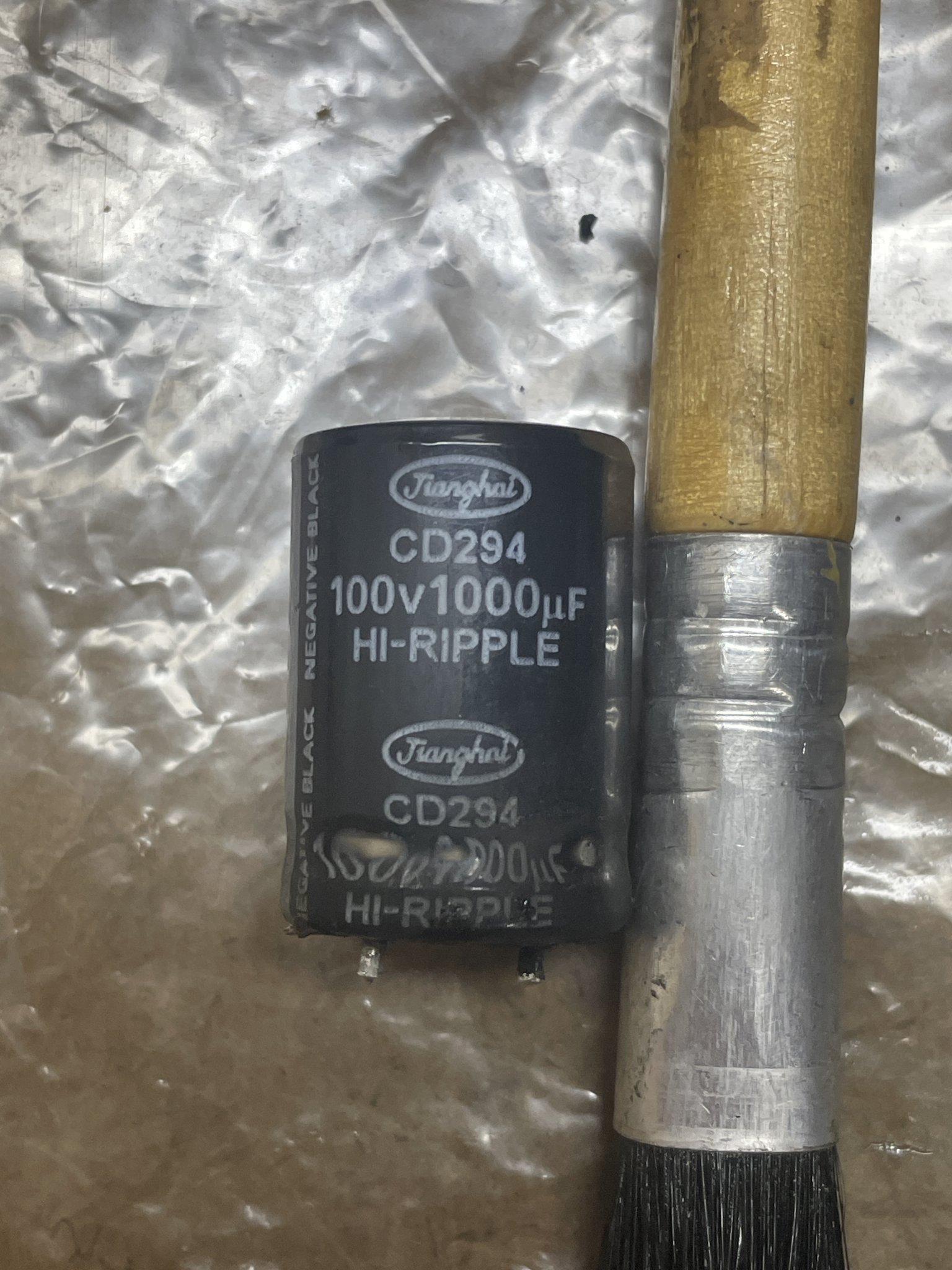

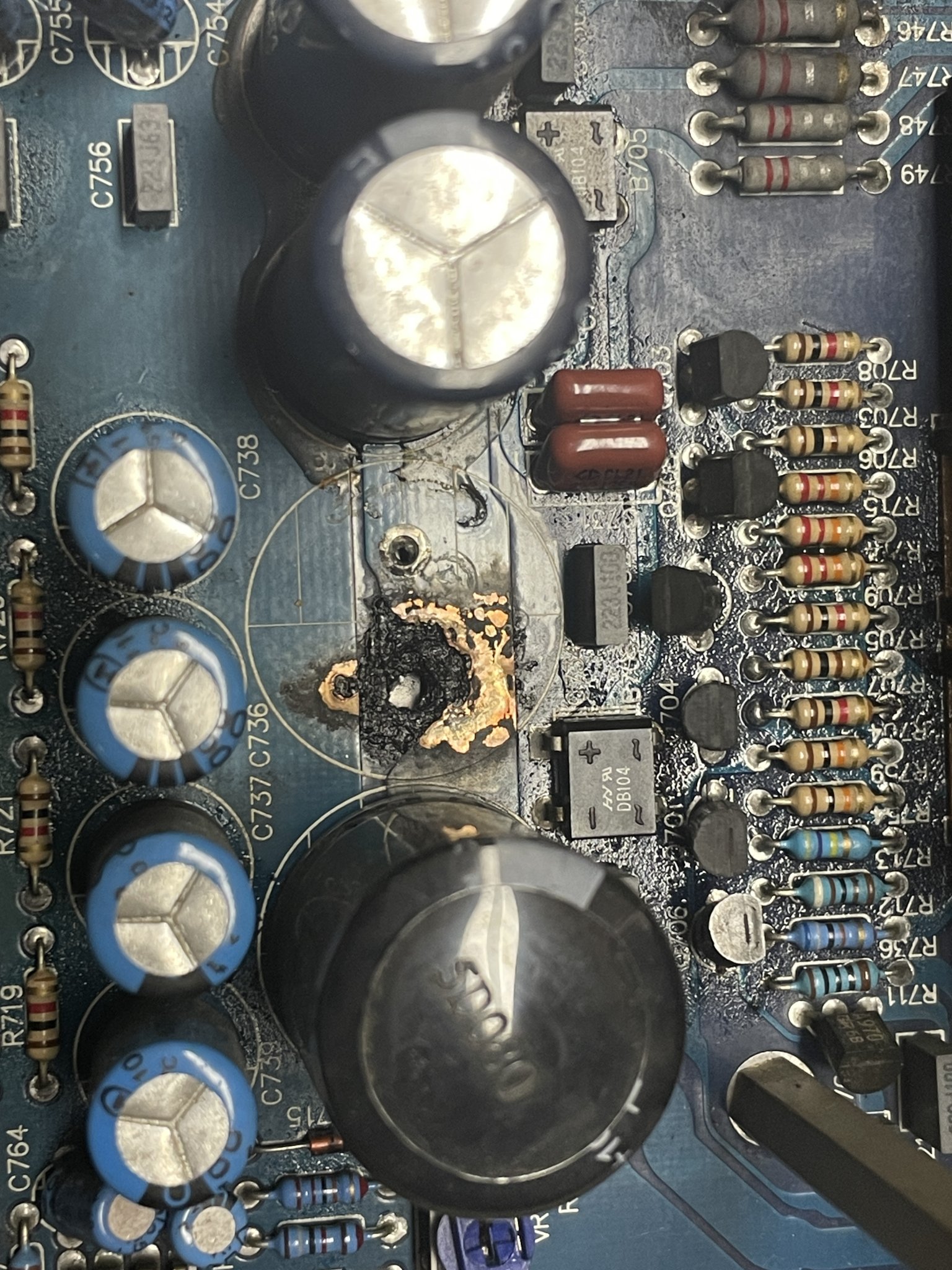

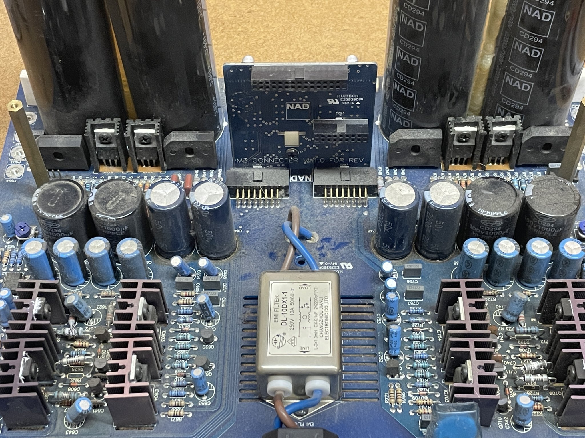

After further disassembly I found the blown capacitor that was the source of the smoke. My plan of attack is to check all of the transistors and the diodes, to create a list of failed parts to order I will then replace the components (in pairs).
Have you seen this before and shed and light on the cause or have any advise on a diagnostic procedure to see if there are any other upstream components that would cause the capacitor and resistors to fail?
Which cap failed, i.e. what's its Reference Designation (Ref Des) in the schematic? I can look to see if anything obvious jumps out. Failed power transistors are possibilities, but that's a rabbit hole to be avoided if possible. Which resistors have failed? They may be casualties of transistor failure.

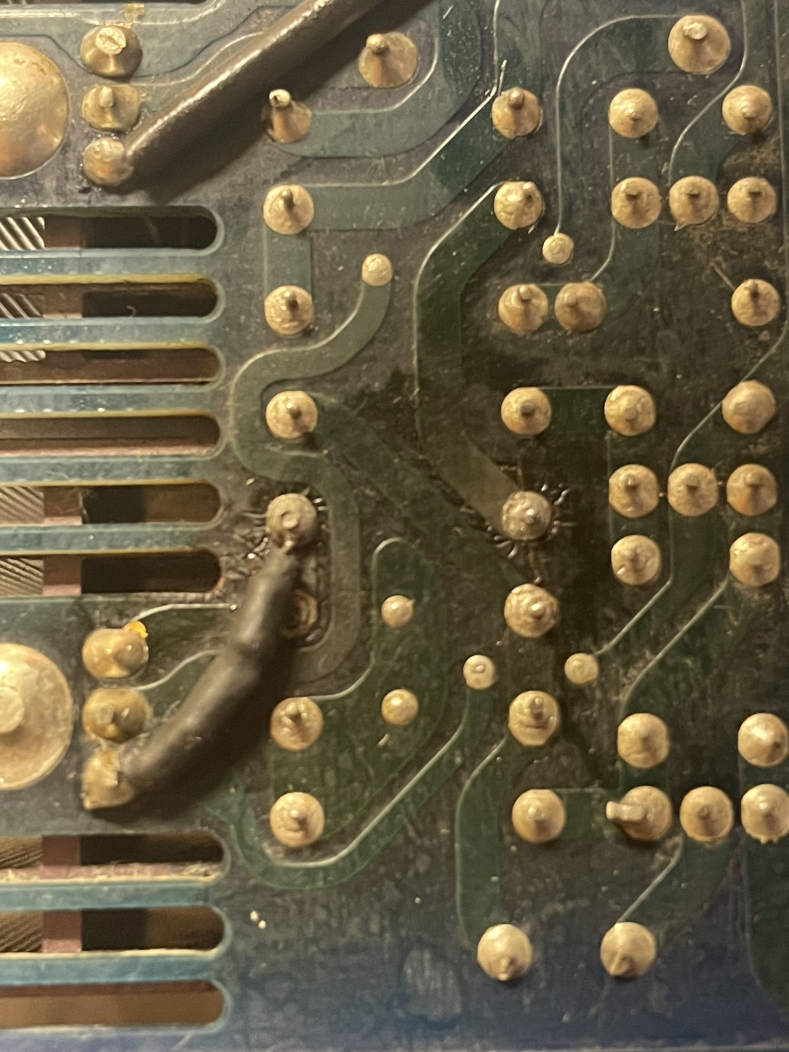

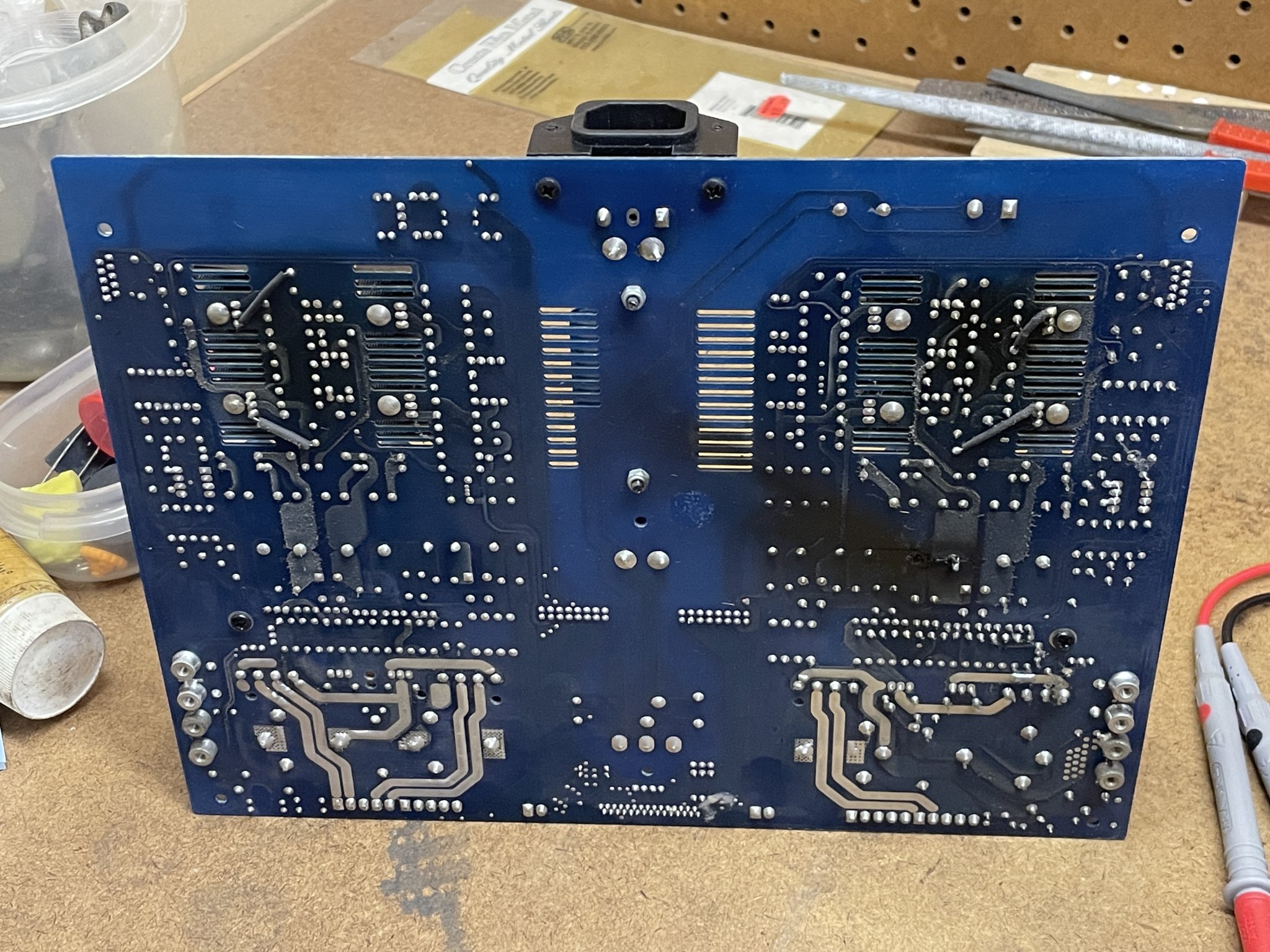

The board looks like it took some damage but the traces on the back do not appear to affected, is there something I can put on the top side of the board to "re-coat" the copper substrate?
