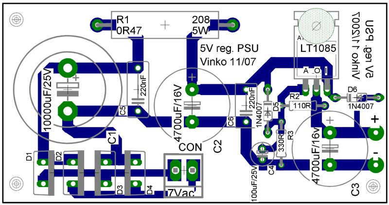

Here is the schematics of regulated PSU for SB Touch which was suggested on local audio forum which I moderate. Several members have built it and have reported improvements in sound. There have also been individual takes on this schematic, such as replacing the C3 with lower value in 10uF range or locating the C3 inside SB.
Thanks to share,
I didn't like this oem reg chip on my PS SB Duet (9V not 5V like the Touch)
Why not a 47 uH or 100 uH smd common chocke instead the 0R47 ?
This reg chip sounds better with some 100 to 470 uf HIGH (bad) ESR on its output and even better if the cap is old (bader impedance due to the ageing !)
my 2 cents, but sharing is much appreciated, thanks again.
I haven't tried it myself. I use a different DAC and PSU, whatsoever. This was just a suggestion which seemed to offer a good cost+performance vs. SB ratio, i.e. it is not more expensive than the SB itself and it has received some positive feedback. It surely can be made better but here is a schematic and a good no-brainer solution.

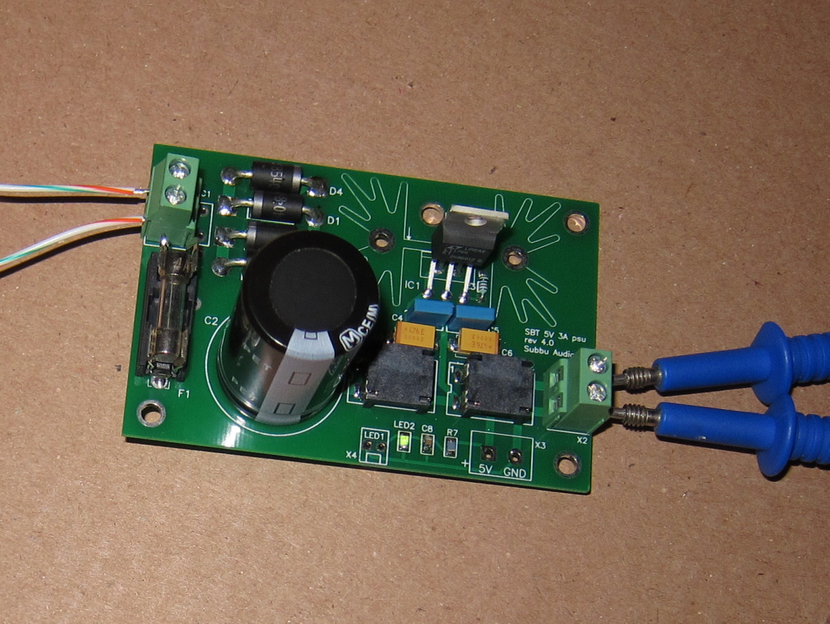

I built 5 of these supplies with some differences and I am still testing them but I lack the time because of work. It performs very good, one tester thinks it is better than the PSU we made of the Subbu V3.
Joined 2002

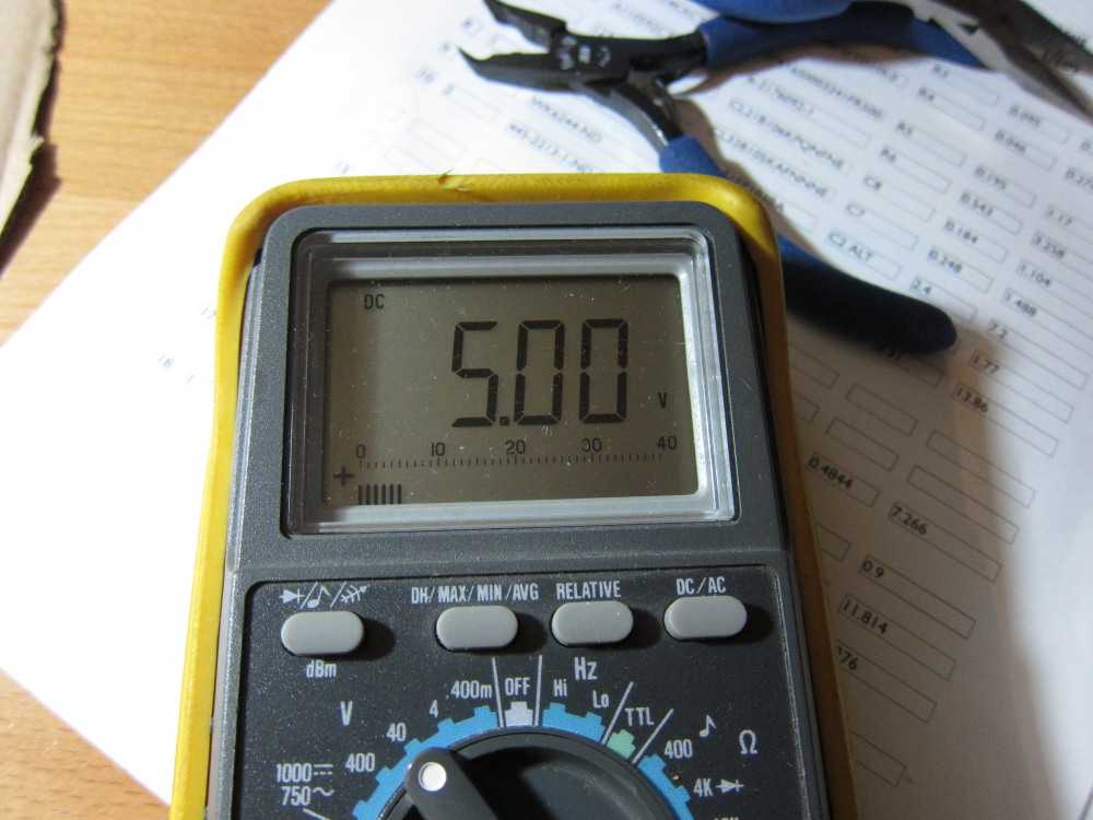

I think that I am the tester that JP mentioned. I got one of the boards just before the holiday and put the power supply together for a quick test. As one would expect from JP and Subbu, the design is nicely done with an elegant simplicity and the boards are very well made. It was a simple project to put together. I didn't have a big enough transformer on hand to test the full current capability of the board (5v 3A), so I used a smaller transformer that would support 5v and 1A. I tried this out on my Subbu V3 DAC and found it to sound very good. It was a lot better than the standard Subbu 5v PS based on the LM723 and even a small step up from my homebrew PS based on the LT1764. So I consider it an unqualified success. Attached is a picture.

Hi Gary, nice build. I was indeed pointing at your results. You do need a SK129 heatsink :)
While I thought the LM723 PSU already was quite good, it is surprising and nice to know that the SBT PSU performs better. Thanks for your efforts.
