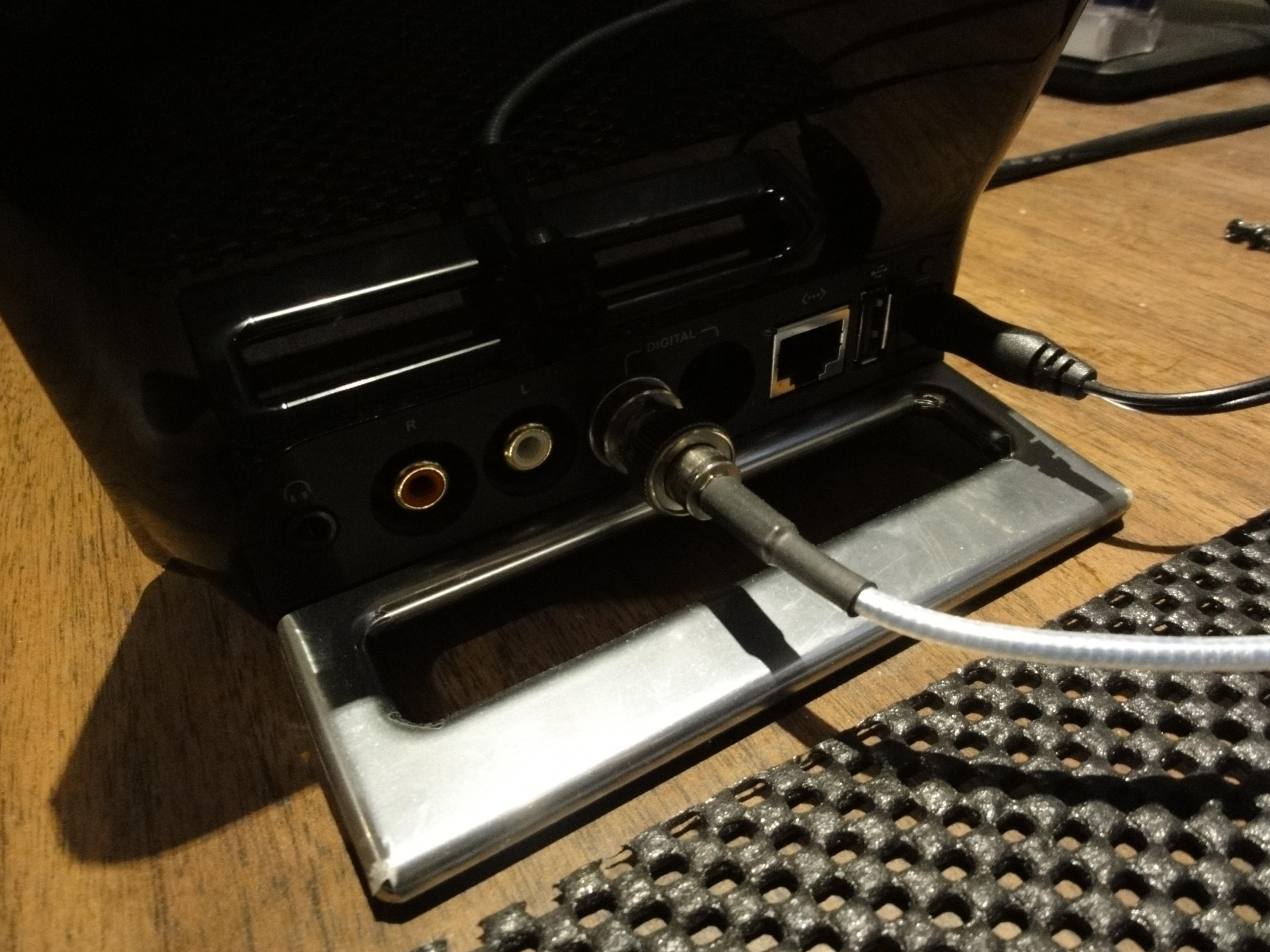

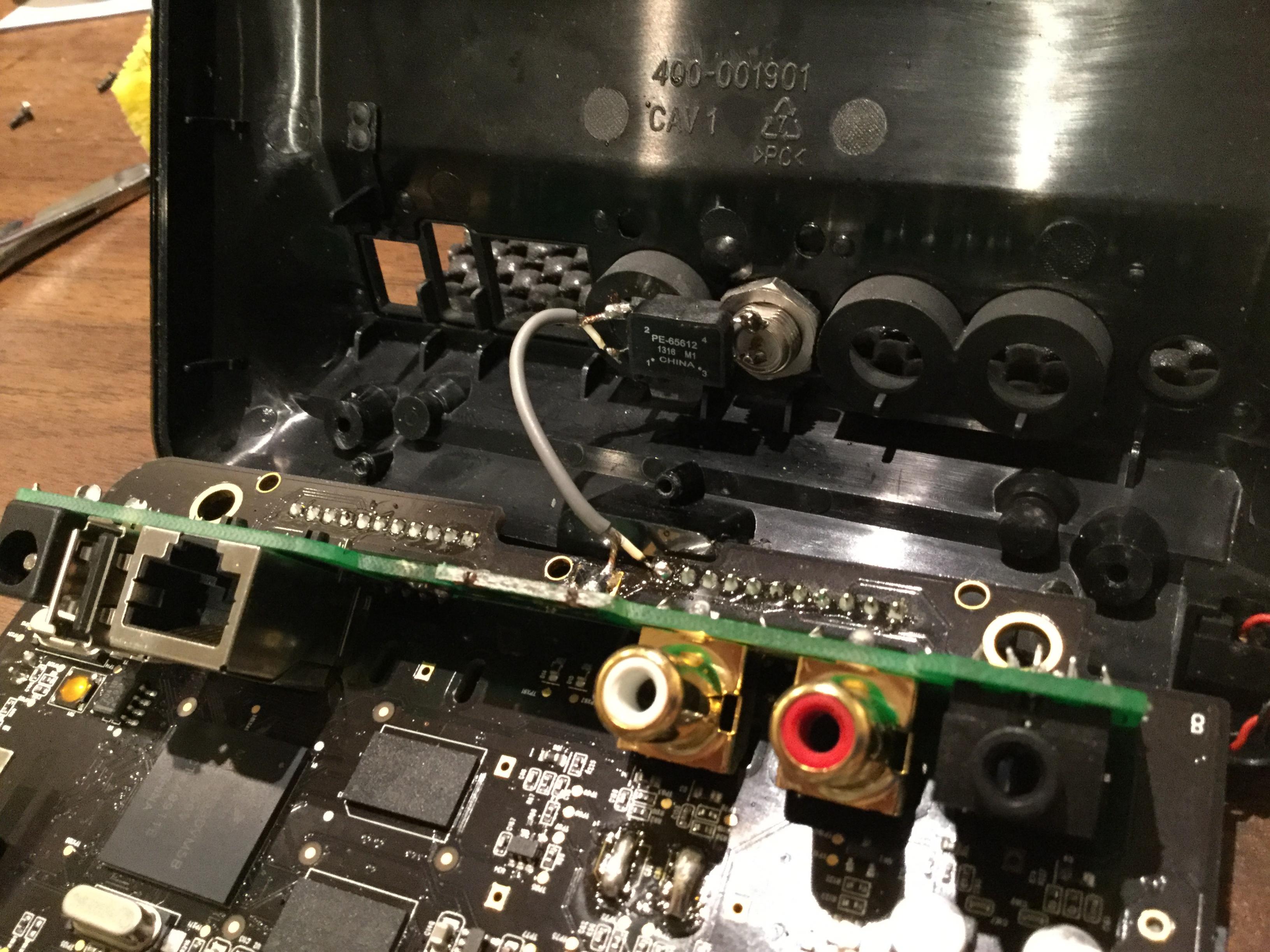

Removing the toslink was one of the things I heard immediately (did that years ago) -- where is that resistor? Might as well remove it for completeness 😀 -- since moved to rasppi/hifiberry digi/picoreplayer simpler, better
some pic's of things I've done in the past-- always tried to keep it very clean... could return to stock if chose to:

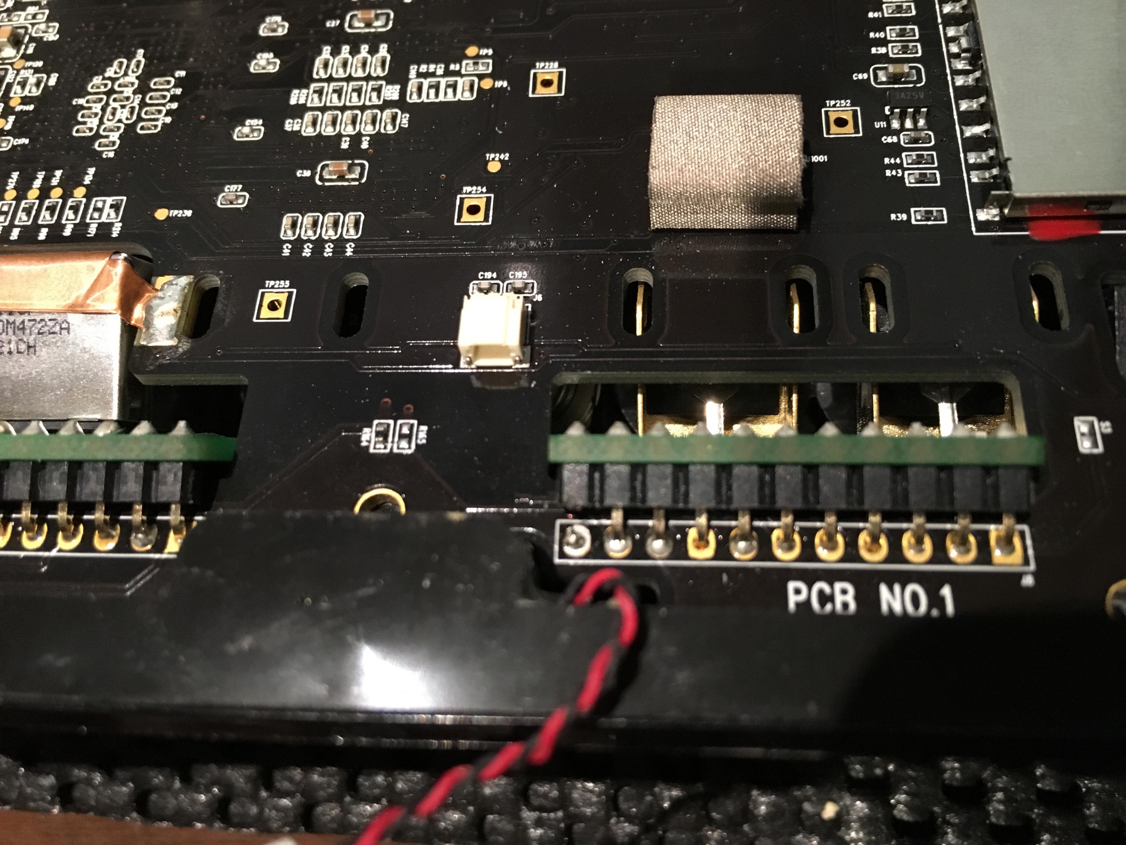

Hi
i dont have a disassembled SBT right now but it is the resistor between TP86 and TP87. R65 as far as i can read on the photo of your SBT-PCB.
You can check this by measure 0Ohm from TP86 to the input of the optical transmitter.
I can see that you have soldered the digital cable to the connection between the connector board and the mainboard. You should unsolder this cable and connect to where the SPDIF Connector center pin was soldered to the breakoutboard.
The reason is that the spdif signal will reflect from the point you have connected the cable and the solder point of the unsoldered SPDIF connector. this gives a missmatch of impedance of the SPDIF output.
another thing to improve sound quality.

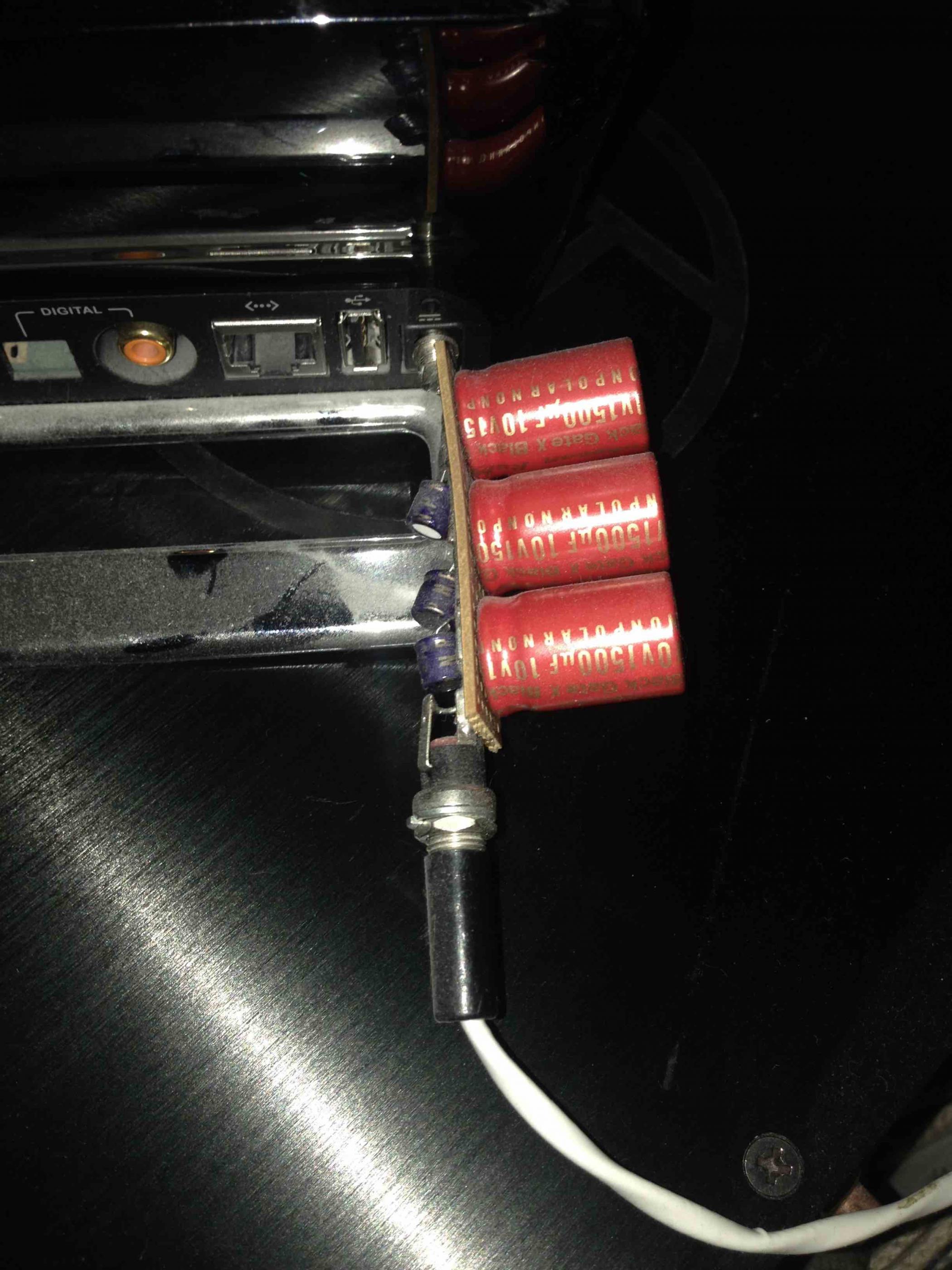

Add 4500-5000uF of very good quality as close to the DC input of the SBT.
This mod will really raise the sound of the SBT.!! it even works if you use a linear high quality power supply. Im using a Teddy pardo supply and this is a mandatory modification i my setup.
I have made an extender board as attached..
I have used Black gate caps, but Polymer caps can also do a good job here.

Yeah re: the BNC, didn't like using that wire either-- this was the last thing I was experimenting with right before discovering the raspi/digi+ and didn't do a lot of listening tests, I may just put the RCA back on, or suppose could cut the trace, not sure yet.
Kinda done with it, makes a nice desk player & controller for the pi

Hi
Dont forget the cap bank on the dc input!!!
Both mods will raise the sbt to a higher sound level.

Thanks for the tip removing the TOSlink resistor, done, it was R65 -- micro solder!
Also snipped the coax connection to the daughterboard & left my connection as is to the BNC

Hi
If you snipped the right one of the two resistor in the middle og the pic. im afread you removed the wrong one.
The resistor that needs to be removed is the one close to the SPDIF buffer on the other side of the board.

I did remove the correct resistor on the other side of the board... I snipped the pin going to the daughter board (shown in that last pic), to avoid having to move the BNC connection like you suggested
