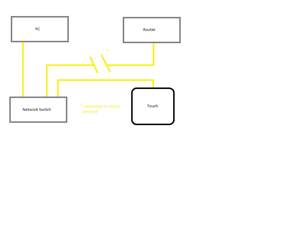

Well, I just disconnected my cable running to the router and the touch plays just fine. So all there is in the path is PC > Network switch > touch.
Just like in this diagram I made earlier. (the way I suggest sounds best)
I'm researching it at the moment, but perhaps this works because this
TP link router "Supports MAC address auto-learning and auto-aging"?

Hi Larry I don't doubt your comments if you are talking "in general", but
if talking specifically about a Squeezebox server PC connected directly to a touch in the manner we discussed above, and the PC and Touch have both cached their IP addresses, then removing the router should be no problem. It also removes another (antenna) cable from the audio chain, and in my experience sounds a little better.
Can you see any specific problem using a dedicated music server connected to the touch in this manner?

Without a router you would not have been able to set this system up. Without a router you can't get to the internet for updates on server software nor Touch firmware.
Without a router, you can only use the IR remote control. You would have to go to the server physically to set up each and every playlist. Very tedious.
The switch serves no purpose in your setup either. You could run a network cable between the server pc and the Touch.

I do know that. If I implied otherwise I am sorryerin:
I only do that once in a while. I don't really see this as a big issue
without a router, you can only use the IR remote control. You would have to go to the server physically to set up each and every playlist. Very tedious.
I use the touch screen to play music, not an issue for me.
Now that is interesting. I was not aware of that. I'm going to try this tonight and see how it sounds.

Larry, I was making my comments based on the sound quality of different network setups (LAN wiring arrangements) as perceived by myself, in my system, which may equally apply in another persons system. I wasn't suggesting that you hinder your convenience by doing any of this.
I will report back on the sound when going direct from the PC 😉
This isn't that trivial as you put it. Without Auto-MDIX on the devices you need a cross
cable to do this. See wikipedia on Ethernet crossover cable.
If you check the SqueezeBox Wiki you'll find that Auto Uplink or Auto MDIX has been a standard feature for many generations of SqueezeBox.
No X-over cable is needed.
