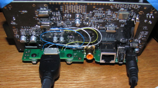

KandKaudio had developed a solution for the Touch. It uses an HDMI cable
K&K Audio / Lundahl Transformers - Logitech Touch I2S digital output mod complete! - KevinC - February 06, 2011 at 14:03:39
attachment.php
interesting. Do they slave the Touch?
I can answer it myself.
NO they don't. The Touch clocks are still in operation.
This solution just replaces the SPDIF interface.
An external DAC will be slaved and clocked by the Touch. NO GOOD! 😉
(With a little extra effort it can get much better!) Or you still apply my Toolbox. 😉
Those K&K I2S send/receive interface devices won't galvanically isolate either. K&K is doing that on the DAC board itself. Hmmh. ( Yep. Those guys are aware of the isolation issue)
