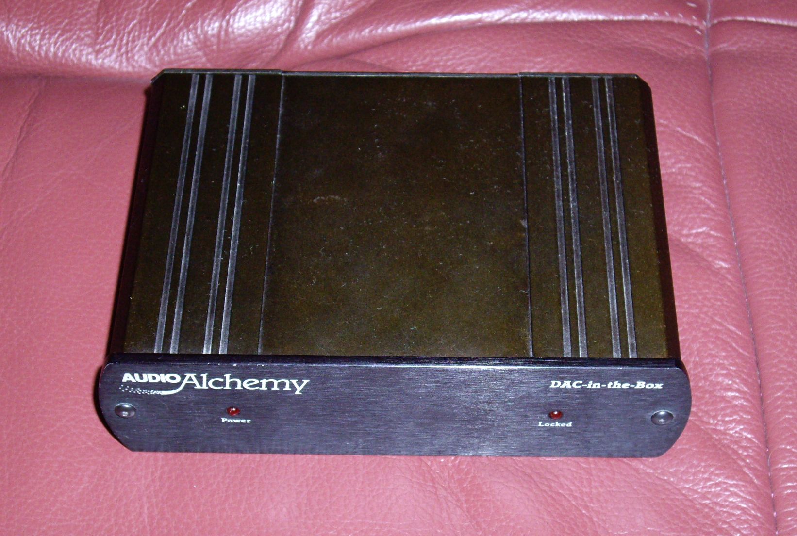

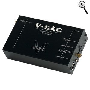

Separate DAC boxs can be used with other components and there are few
cheaper DAC that not bad sounding. (Audio Alchemy DAC in the Box, Musical Fidelity V-dac, Micromega dac duo, Cambridge Audio,etc)

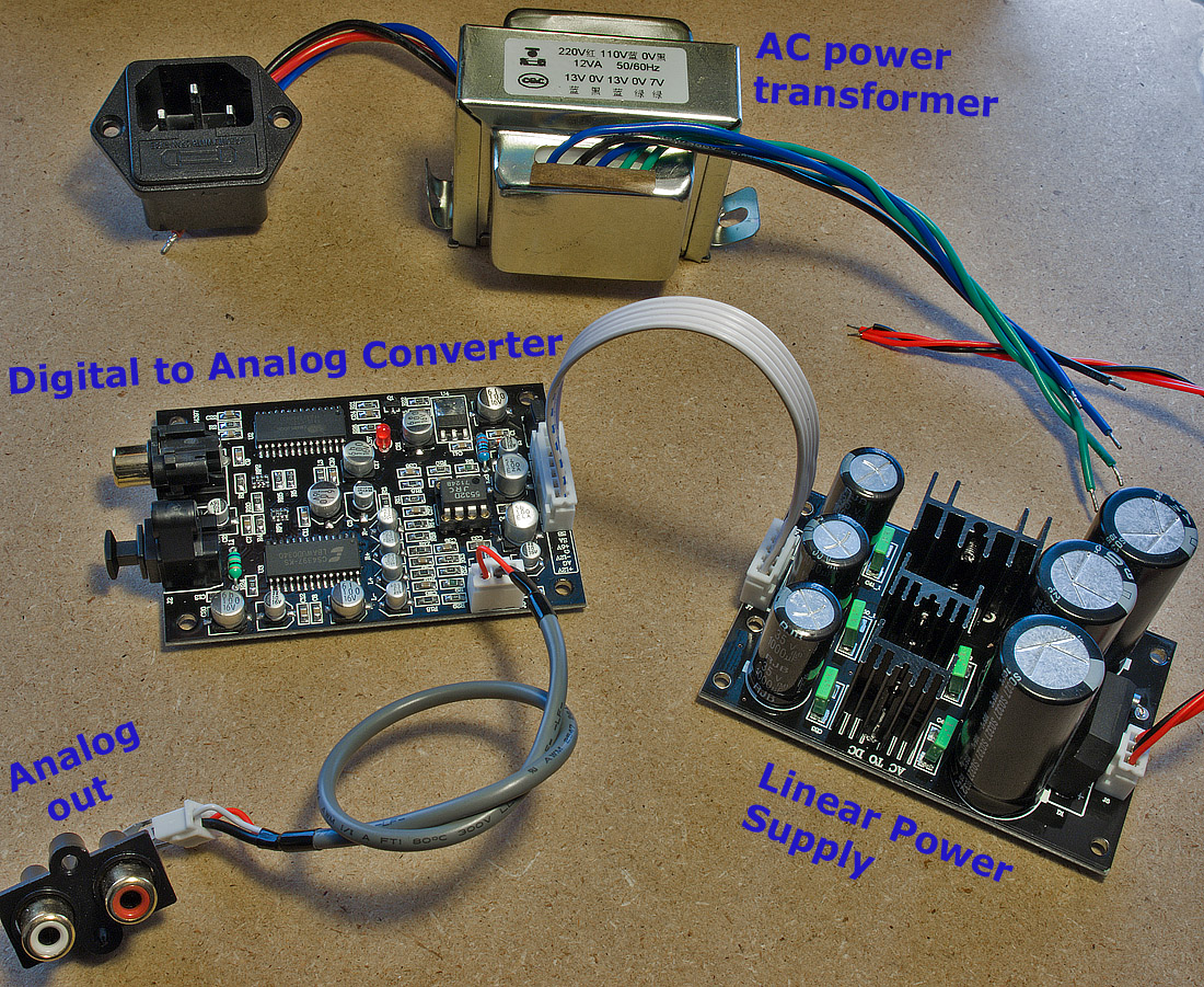

TDA1543 very easy to build a dac from this chip.
TDA1549
If you wanna use your pc you need a good sound card anyway to get decent digital out.
For your PC I recommend ASUS Xonar DS, its cheap and almost as good as the Xonar Essence ST.
ASUSTeK Computer Inc. - Multimedia- ASUS Xonar DS
Forget about Creative sound blaster they are junk.
Or go for DIY, there are many good DACs around.

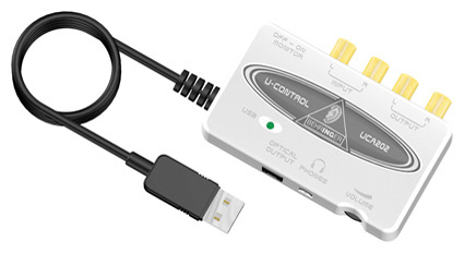

don't over look the Behringer Ucontrol UCA 202. External USB, self-Powered with RCA in and out and headphone jack and control. Not fancy, but good sounding and $30 USD everywhere. I have a couple of them and love them.
I use one for my soundcard oscilloscope. I believe the chip is a Burr-Brown.
here are some more specs and photo on the U-CONTROL.
U-CONTROL UCA202
Ultra-Low Latency 2 In/2 Out USB/Audio Interface with Digital Output
Ultra-flexible audio interface connects your instruments, mixer, etc. with your computer for recording and playback
High-resolution 48 kHz converters for high-end audio quality
Works with your PC or Mac computer—no setup or drivers required. Free audio recording and editing software downloadable at BEHRINGER: Home
Stereo Headphone output with dedicated Level control lets you monitor both input and output
Additional S/PDIF optical output for direct digital conversion
Powered via USB—no external power supply needed
