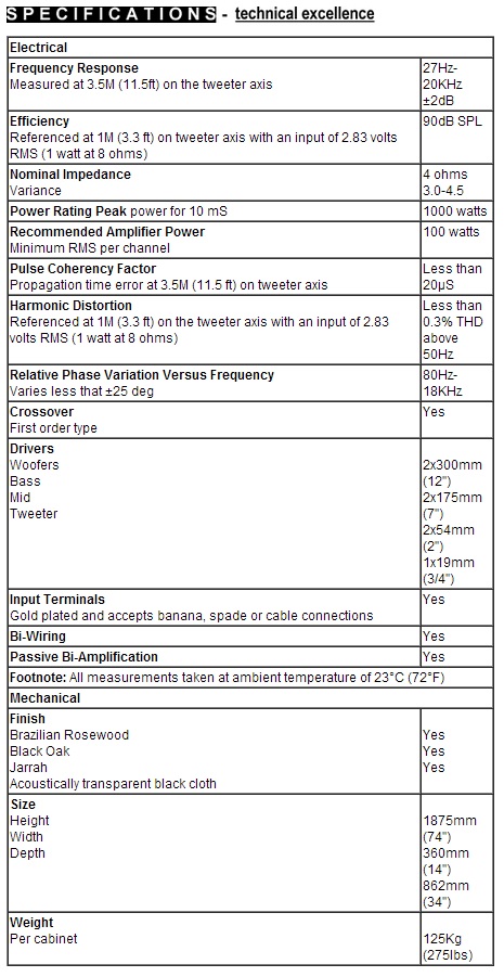

There are many aspects to a loudpeaker and its crossover that are more important and audible than fidelity to the phase response of in the input signal (meaning the speaker "can reproduce a square wave").
That fact that a very well regarded loudspeaker can reproduce a square wave does not mean that a speaker that can not reproduce a square wave must there be a bad speaker. That Duntech loudspeaker probably got about 20 other things right, too.
SOVEREIGN
Dan.
