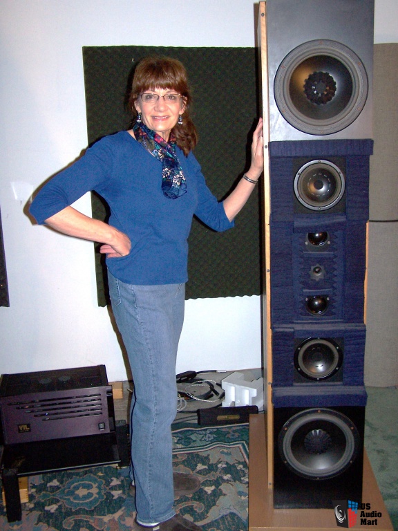

It should be noted that Rehdeko speakers use series XOs -- their info shown in post 1.
dave
Hi and thanks for the info !
Series XOs ? what are they ? which order are they ?
Regards, gino

Series vs. Parallel Crossover Networks
The square wave response in post 1 suggests that the uses 1st order XOs.
I have had good success with series XOs in FASTs where the XO is 200-400 Hz.
dave
dave
dave

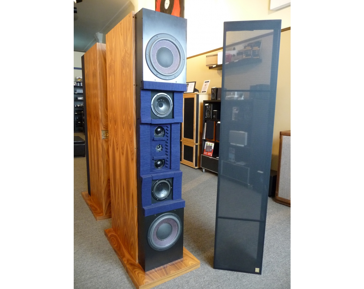

Duntech loudspeakers were noted for their time aligned construction (and simple order crossovers).
The Sovereigns give stunningly good depth reproduction, when fed correct absolute polarity.
Crossover phase rotations and lousy driver time alignment adds up to sonic confusion.
It is worth getting time alignment correct, actively or passively (physical construction).
