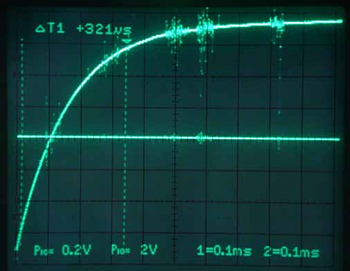

The signal should look like a charging capacitor, RC-link. Disregard the disturbance in the curve. You can tolerate a slight overshoot but not too much "ringing". This is a sign of instabilty or very near it.

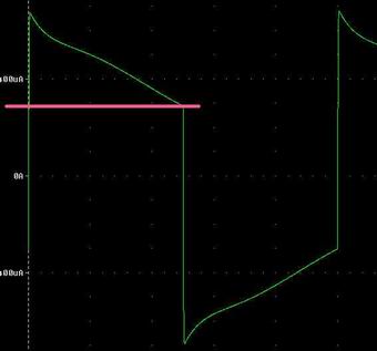

Below I repost what I already did within another thread.
It is the response to a squarewave of 200 Hz and 10 kHz, reproduced by a system with lower and upper rolloff of 12 dB/Octave and no phase anomalities inbetween.
For the lower signal frequency the effect of the lower cutoff frequency predominates (tilted top and bottom), for the higher signal frequency it's the upper cutoff that has the largest impact on the waveshape (finite slew-rate).
But you can clearly see that there are none of the typical multiple transients, at the beginning of each half cycle, that are typical for most multiway systems.
Regards
Charles
square waves

This has not much to do with gain or delay. Since the topic was mentioned within a speaker thread of Richard as well, I posted the response of a phase accurate two-way speaker system.
The waveshapes are those of a wide fourth-order bandpass. The tilt is caused by the lacking ability to reproduce DC. All waveshapes are damped quite well and the tilt is not to be mistaken as overshoot, though one is led to believe this. The flattened slopes of the rising and falling edges are simply caused by the finite rising and falling speed.
Many amps would be better than this example in terms of HOW MUCH, at least at the lower end (where a very low first order rolloff is easily achieved with SS amps, even DC reproduction, but more difficult with tube amps). But the general SHAPE would be the same, as long as there is no ringing.
But keep in mind most speakers will be worse.....
As Peranders stated, rectangular tests are quite good for determining stability. It is not by accident one of the vavourite test signals for almost any feedback control system !
