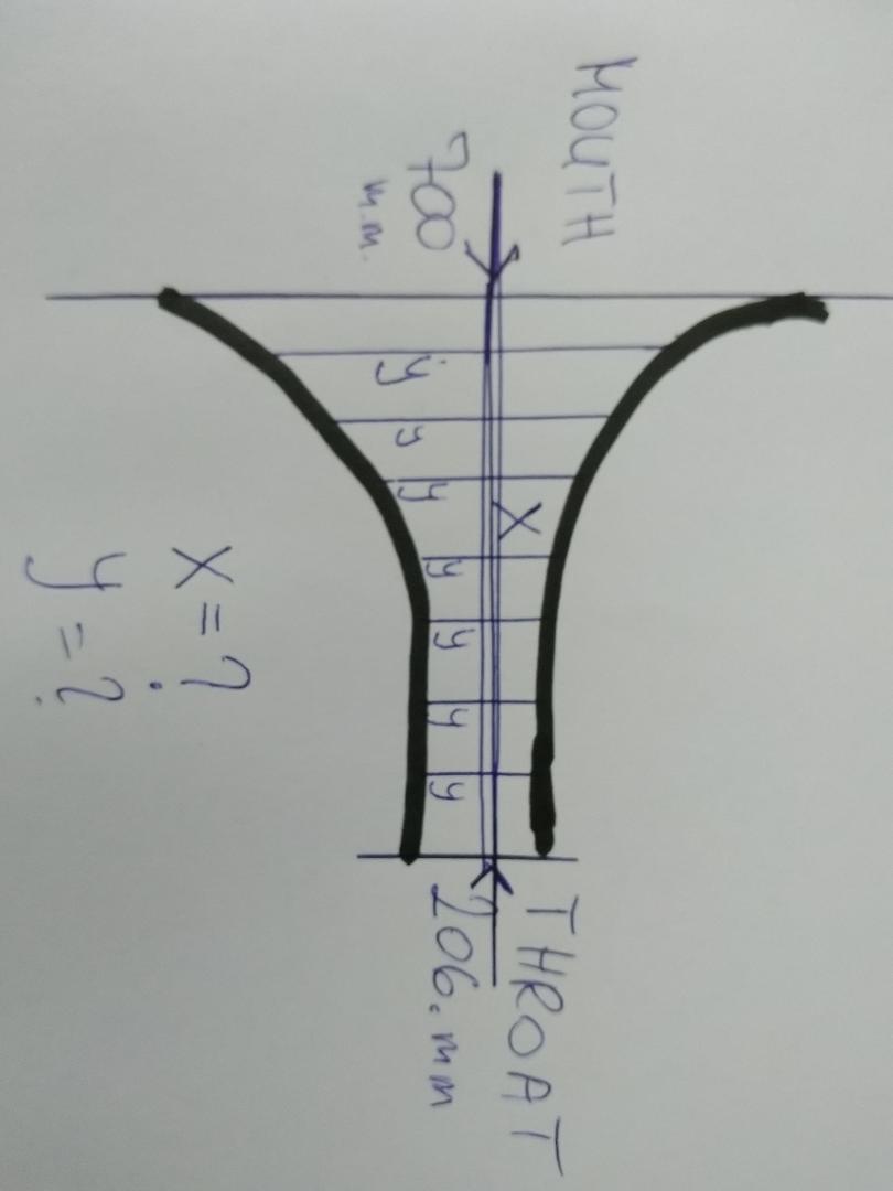

GM thank you for the answer. I hope that i can ask some more questions, because im still confused. Can someone explane me some more things. To be clear i make some drawing .
So if im geting this right, mouth is 700 mm , throut is the size of a driver( 206 mm). What are the values of a X(distance from throat to mouth) and Y( sides of a horn lets say at every 5 cm. I realy hope i explained well my questions. Thanks in advance . Dejan

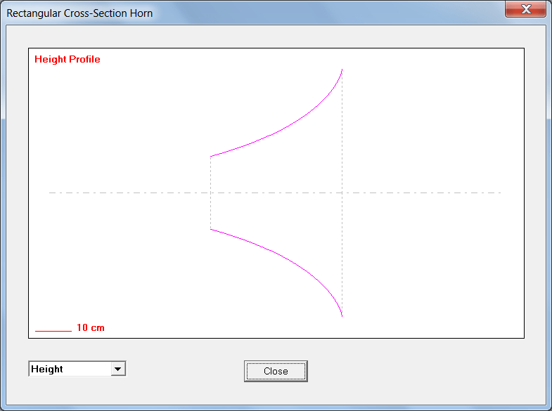

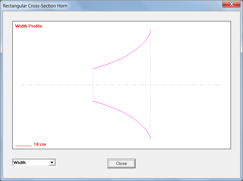

Attachment Tractrix_1.txt contains the data (at one centimetre intervals) for a square cross-section tractrix horn expanding equally in both width and height. The width and height profiles are shown in Attachments Tractrix_1W.png and Tractrix_1H.png.

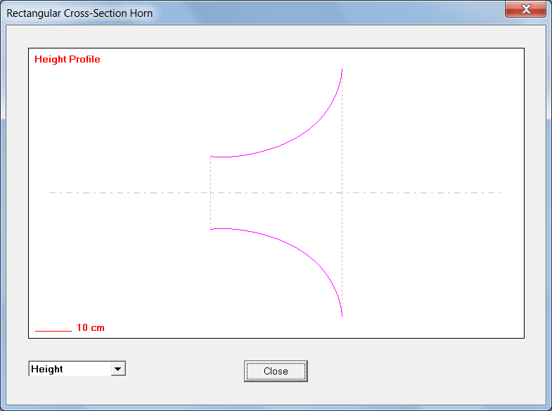

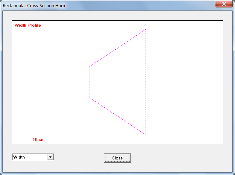

Attachment Tractrix_2.txt contains the data (at one centimetre intervals) for a square cross-section tractrix horn expanding linearly in width. The width and height profiles are shown in Attachments Tractrix_2W.png and Tractrix_2H.png. The constructed horn can be rotated through 90 degrees if the top and bottom rather than the two sides are required to be flat.

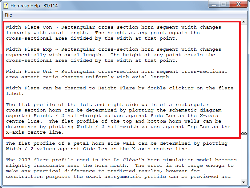

Descriptions of the data file contents are given in Attachment Tractrix_Notes.png.
The tractrix horn has the following specification:
Throat cross-sectional area = 20.6 * 20.6 = 424.36 cm2
Mouth cross-sectional area = 70 * 70 = 4900.00 cm2
Horn axial length = 37.06 cm
Flare cutoff frequency = 138.62 Hz
