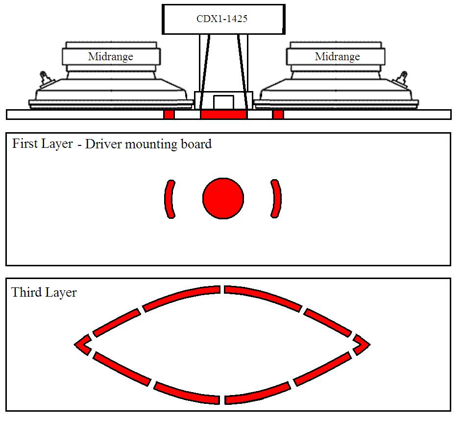

One of the things that has made building a Unity or Synergy horn difficult is how the mids mount to the horn. If you mess up or need to adjust the midrange entry ports, you have to build a new horn shell. This is because we are making the holes in the side of the horn. This makes adjustments very time consuming and expensive. If we integrate the mids into the Paraline we can liberate ourselves from making horn shell after horn shell. With the mids mounted with the Paraline only the top driver mounting plate needs to be remade. The spacer for the second layer and all the following layers would stay the same. This will make experimentation much faster and less expensive. It is also possible to get the mids closer to the compression driver than ever before. If you use a compression driver like the Celestion CDX1-1425 or BMS 4524 we can get the mids extremely close to the compression driver because we can tuck the mid under the compression driver’s magnet.

In your pictorial, what does the second layer look like?

Basically, this is a coaxial arrangement with the compression driver UNDER the cone of the midrange driver.
This allows us to use a TON of additional midranges, potentiall raises power handling, etc.

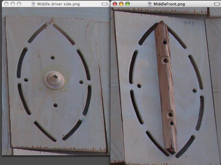

The pictures below might help you see how the parts work.
They are the "guts" to Paralines using a 1.4" exit EV DH1AMT.
The 3" diaphragm allows for a crossover low enough to make 8" or 10" cones viable for PA use. That said, at typical home levels, most 1" exit drivers are perfectly capable on a large Paraline horn of response down to the 600 Hz range at "ear bleed" levels.
It should be noted that this equal path length Paraline has a vertical HF dispersion of only a few degrees, great for a line array, but for those thinking of using a just one or two drivers the "eye" needs to be thinner to provide a more diverging wavefront appropriate for home use.
Art Welter

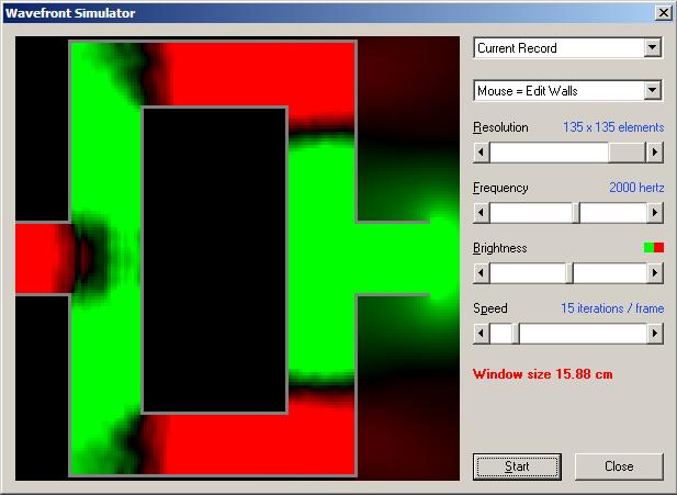

If you want narrow vertical dispersion, set the height to equal the width multiplied by two. That will give you a flat wavefront (zero degrees of vertical coverage)
Play with the wave simulator in Hornresp, and you'll notice that there's no directivity control when the wavelength is larger than the dimensions of the slot. For instance, with a slot that's 20cm tall by 4cm tall you'll lose directivity at approximately 1700hz and 8500hz, respectively. The formula is speed of sound divided by the dimensions of the radiator.
As far as horizontal angle goes, it will largely be dictated by the horn that you mount to the Paraline. Most eye shaped paralines will have virtually no pattern control in the horizontal axis due to their narrow width.
Note that these rules apply to ALL radiators. A Paraline's mouth behaves like a ribbon, a ribbon with a delay.

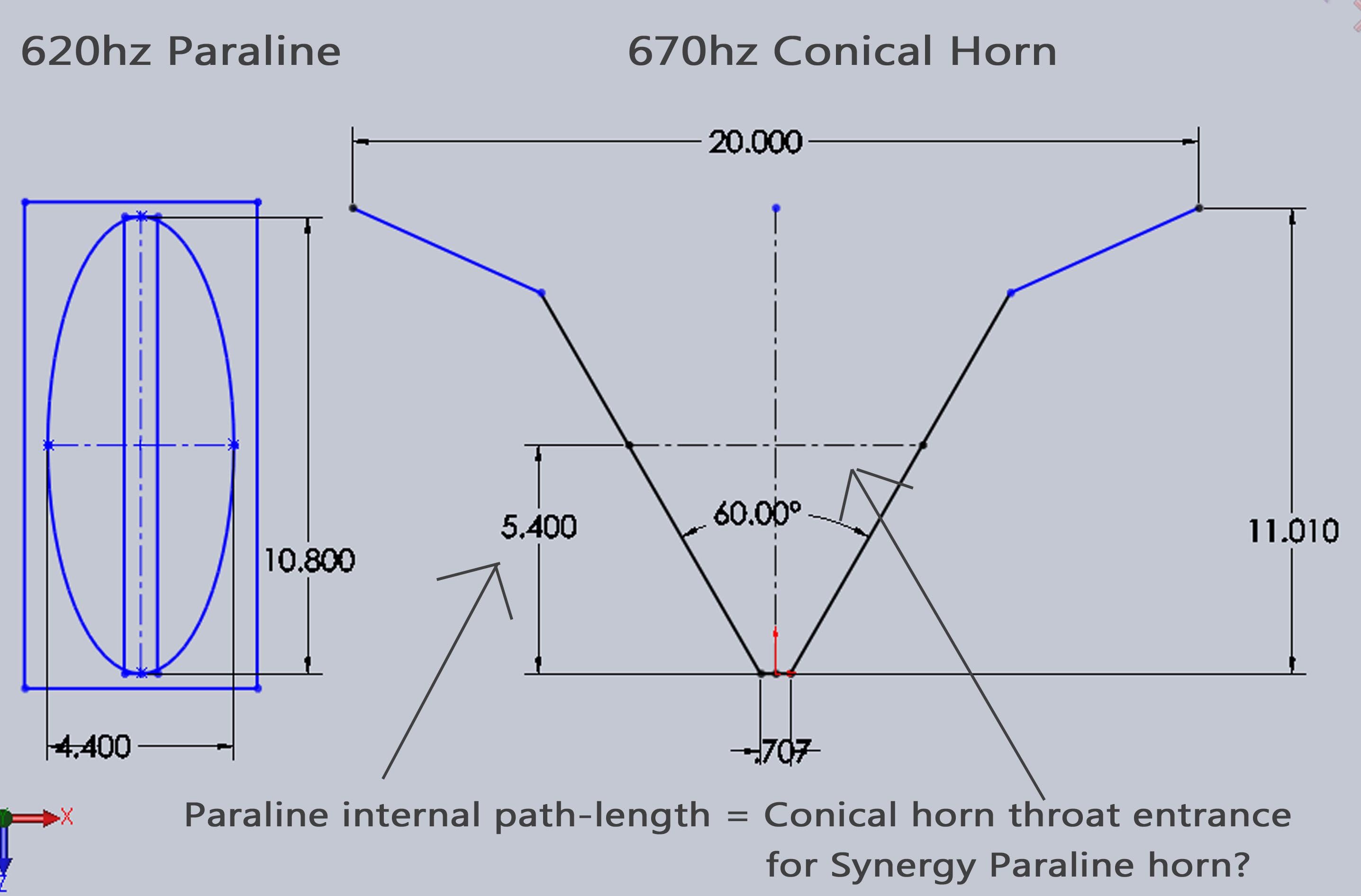

In Patrick Bateman's pic of the coaxial Paraline he mentions using this in a Synergy horn to reduce the depth of the horn. I've seen this mentioned elsewhere, and I'd like to know if my thinking makes any sense.
Since the Paraline is a horn itself do we use the internal path-length of the Paraline to determine the length of the horn that it attaches too? In my drawing I have a paraline tuned to about 620hz with a 5.4" path-length (I used Bateman's spreadsheet to get 40 deg vertical coverage). The drawing of the horn is a top view and it's dimensions were determined with bwaslo's spreadsheet here: http://www.diyaudio.com/forums/mult...ur-own-synergy-more-simple-conical-horns.html
As you can see it's a 60 deg conical in the horizontal plane and its' 20" width is about 670hz. With a comp driver at the throat the horn would be about 11" long. Is it as simple as putting the Synergy paraline 5.4" from where the CD throat would be, keeping the width of the horn the same as it would be on a regular Synergy to keep the coverage angle and mouth width the same?
I can't help but think that it isn't this simple. I understand that a paraline has no real directivity control in the horizontal plane due to the small width of the exit slot. That being the case, wouldn't we want the throat of the horn the paraline couples to to be the same width as the paraline exit slot? To keep the same coverage angle and mouth width the horn would be back to 11"..............I'm confused, and obviously don't know a whole lot about horns. :confused: Thanks
