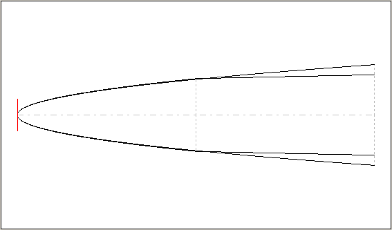

s ... And actually, only the first part of the expansion is 360 degrees... the second fold is not, otherwise it would not converge on a straight line...?
Good point... a horn formed from 2 discs has a mouth area of 3.1416 * diameter * plate spacing. A Paraline has a mouth area of 2 * diameter * plate spacing.
It's hard to model though, because the distance from the throat to the fold varies from half the horn length to the full horn length.
It's a diverging horn from the throat to the old and then converging from the fold to the mouth. It's hard to model though, because the distance from the throat to the fold varies from half the horn length to the full horn length.

The expansion rate isn't different after the fold.
The horn expands in 360 degrees in one dimensions, and zero degrees in the other. It expands out like rays of sunshine. That's one of the reasons I named my thread on the Paraline 'Sunshine'
You might care to re-evaluate your conclusion.
The expansion rate from the throat to the fold is standard radial horn parabolic. The expansion rate from the fold to the mouth is somewhat less.
More specifically, the expansion rate from the throat to the ends of the mouth line is standard radial horn. Now look at 90 degrees, from the throat through the fold to the centre of the mouth line.
Simple math, just compare the mouth areas.
Standard radial horn formed of 2 parallel discs, 20 cm diameter, 2 mm apart:
Mouth area = 3.14 * 20 * 0.2 = 12.56 cm2.
Paraline with 20 cm diameter (mouth length) and 2 mm plate spacing:
Mouth area = 2 * 20 * 0.2 = 8 cm2.
(Making the mouth slot wider does not compensate for lack of expansion earlier in the horn.)
Simulating this is difficult, because the point at which the expansion rate changes varies from half way down the horn to its mouth. Probably the best that can be done with Hornresp is to use a 2-segment horn with the expansion rate of the second half chosen as an average of the two limit cases. The attached image shows the two limit cases - the expansion rate from the throat to the ends of the mouth line versus the expansion rate at right angles to the mouth line. (The mouth areas follow the two calculations above.)

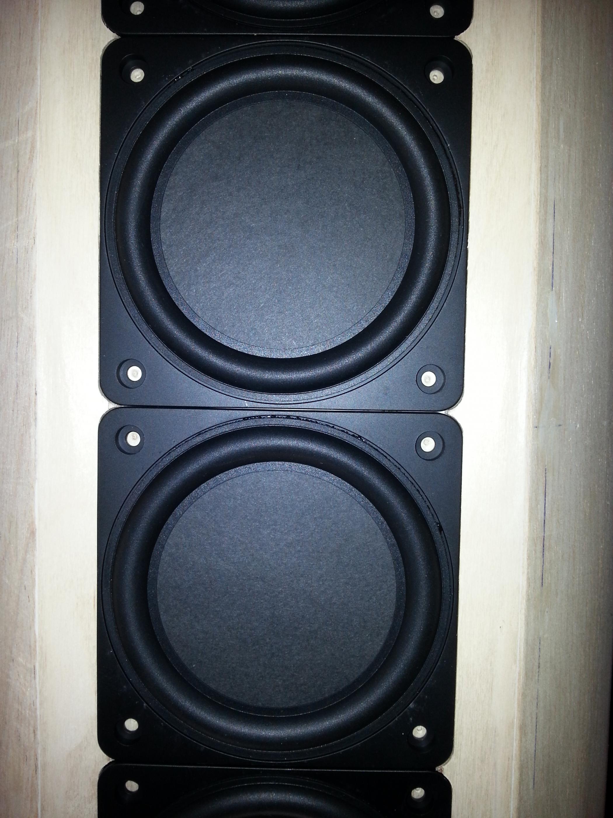

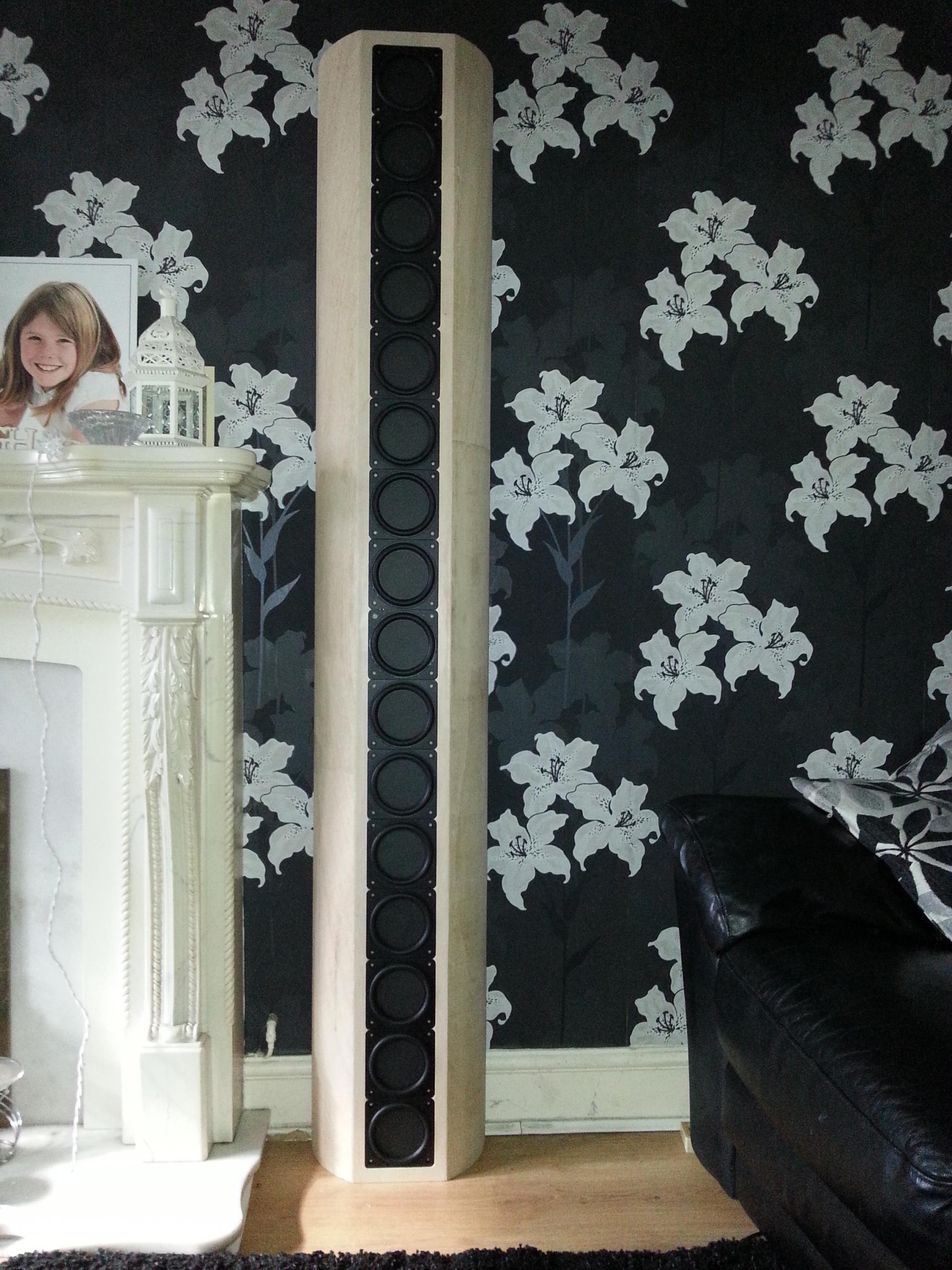

Line Array with 16 BMR per channel
These pics were taken before I screwed in the drivers ( 128 screws!) and put on the black felt covers.
Anyway they are pretty amazing...!
I agree with Patrick, off axis and on axis, everywhere in the room is even balanced sound.
A great benefit is that when you Eq on axis for driver / room artifacts, it sounds just the same off axis...
The Sd is 960 ( more than a 15 inch driver!) per channel so even when you add in low end boost and power them with big amps the driver excursion is still under 2mm ( plus / minus 1mm)
I wire them as 4 groups of 1 Ohm in series so end up with 4 Ohm load but a sensitivity of 100dB per watt @ 1 meter!
I am going to start a build thread next month when I build another few pairs and I can take more pics during assembly.
Cheers
Derek.

In the last post, I showed some data that indicates that the high frequency loading of a radial horn like the Paraline isn't well suited to very high frequencies.
One idea I had was to 'fill in' the throat of the compression driver.
By reducing the area, right down into the compression driver, one might improve the high frequency output. (5khz and up.)
I think some of the VTC Paralines do this; there appears to be a cone shaped 'insert' in their Paraline.
