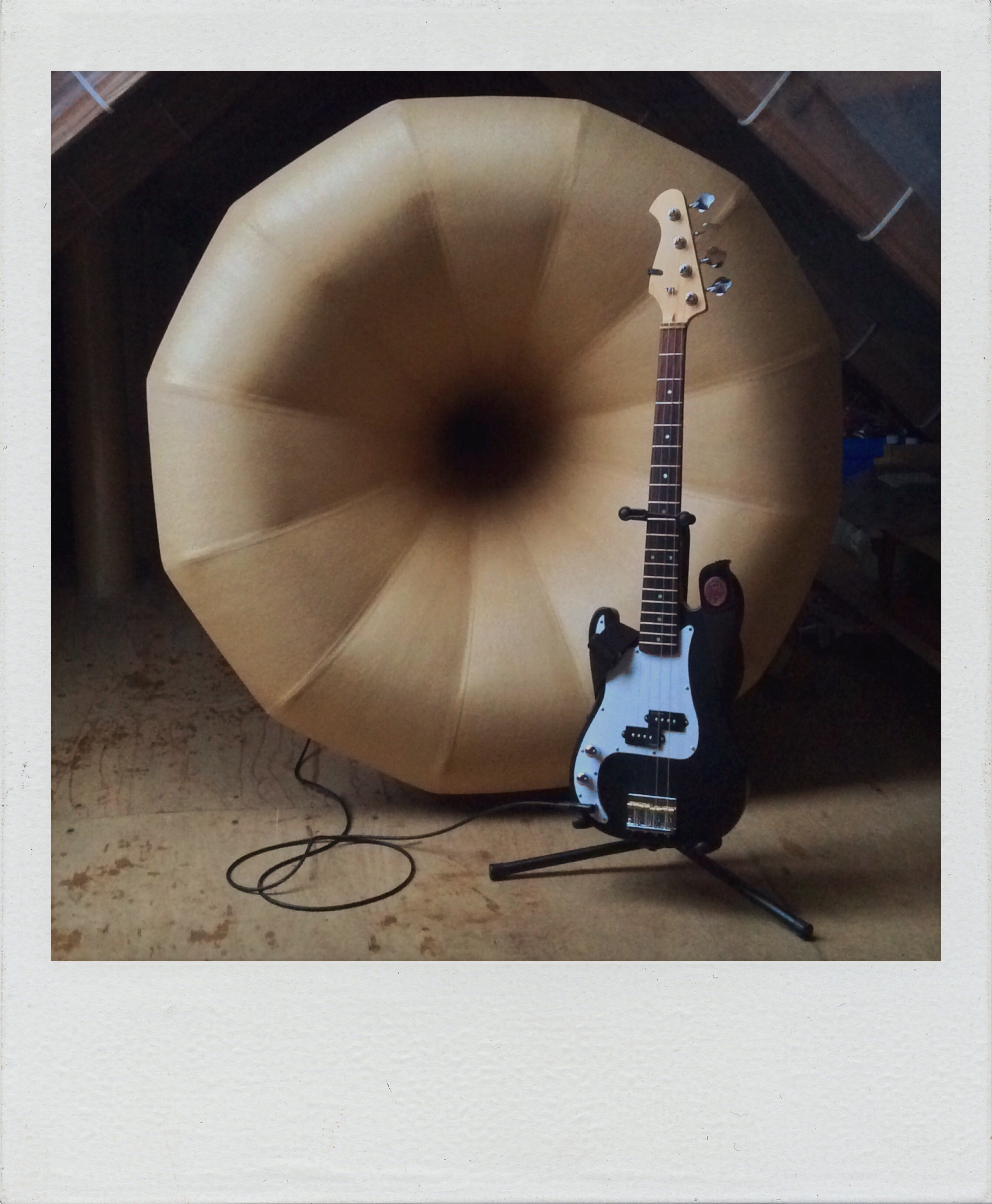

Thanks for the photo! What is it made of and how was it constructed? Did you use the Le Cleac'h spreadsheet? What driver did you use, and what is the cut off of the horn?

I used HornResp, and modelled it with a mouth flare of 112 degrees. I think the cut off was about 120hz, and I used a Jensen AlNiCo 6.5in guitar speaker as the driver with a 3:1 compression chamber. With additional EQ, I get between 85hz to 12khz at 112db per 1 watt at 1 metre (well, that's what HornResp tells me) and this thing at 4ft across, is big.
It is built from paper and card using 'stitch and glue'. Took a lot of time. As a full range mono horn it sounds lovely with quite modest electronics.
About to start work on another two as a stereo pair. Only this time they will be just 3ft across with 3in full range Peerless drivers, and a mouth flare of 180 degrees.

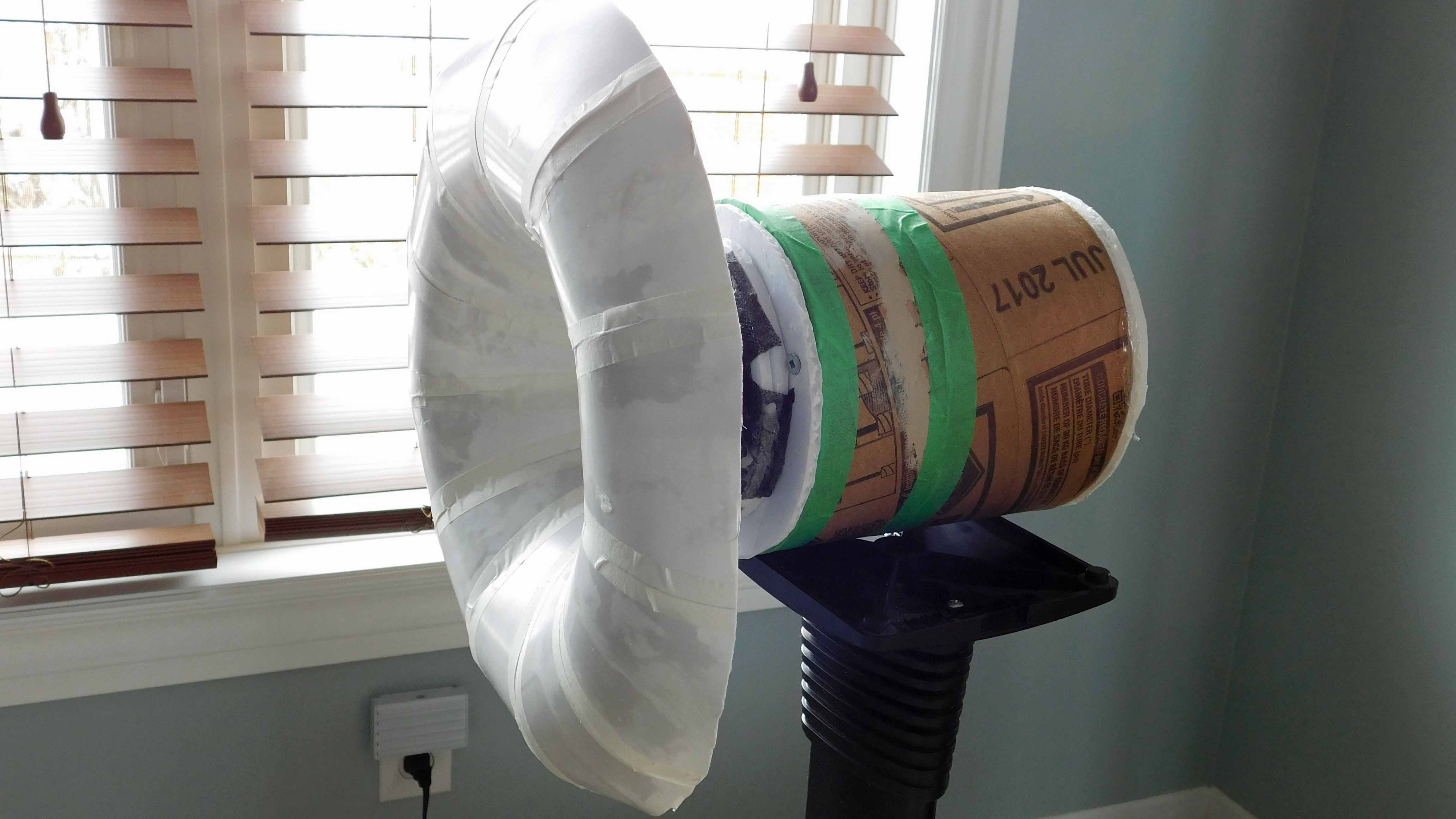

Same here, I used Hornresp to generate the petals. Hornresp will also generate rectangular form factor. Mine was from cardstock, then the horn backside was reinforced with wax+fabric. Much smaller than ToS, but it was intended as a midrange only.
