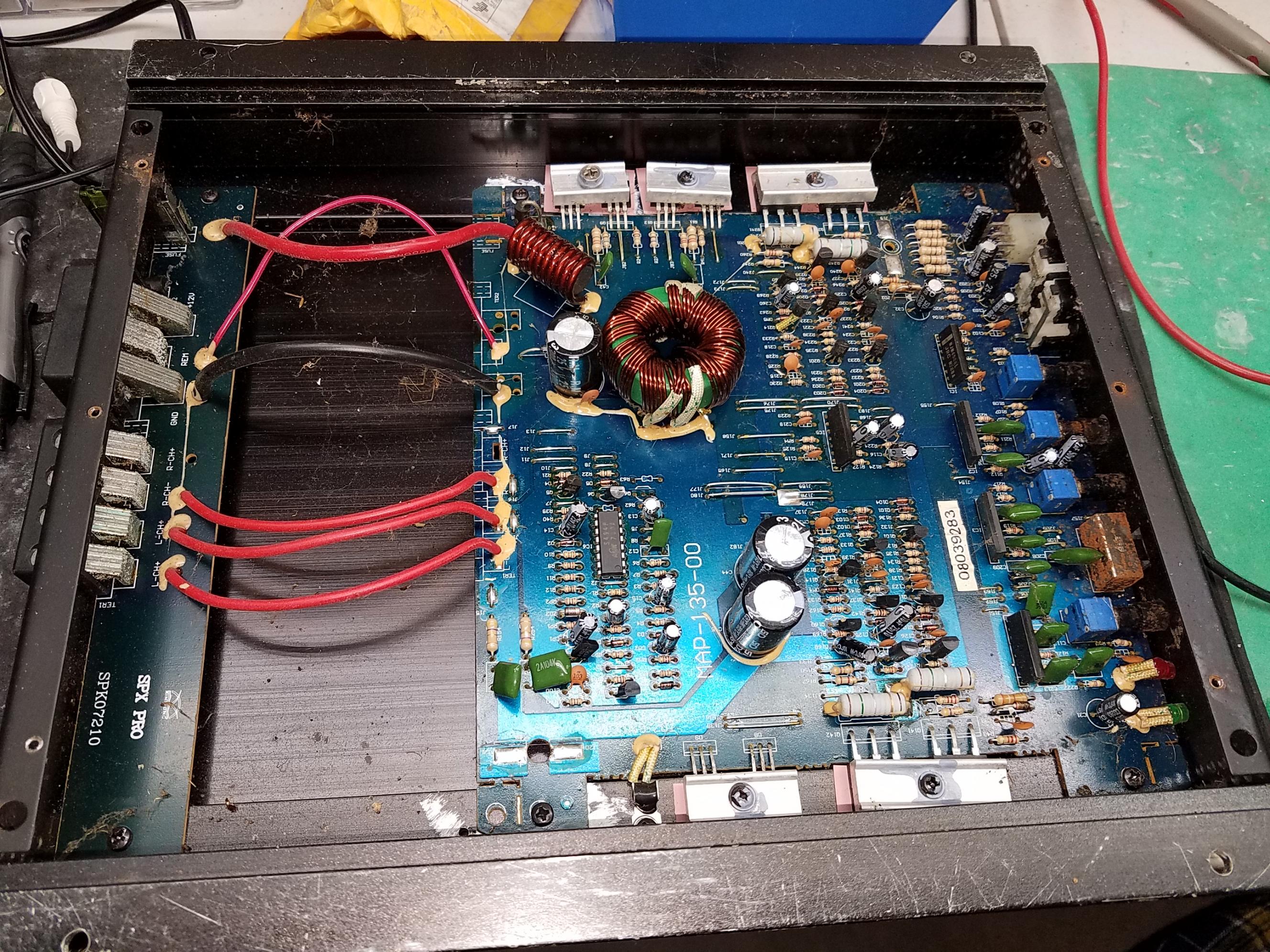

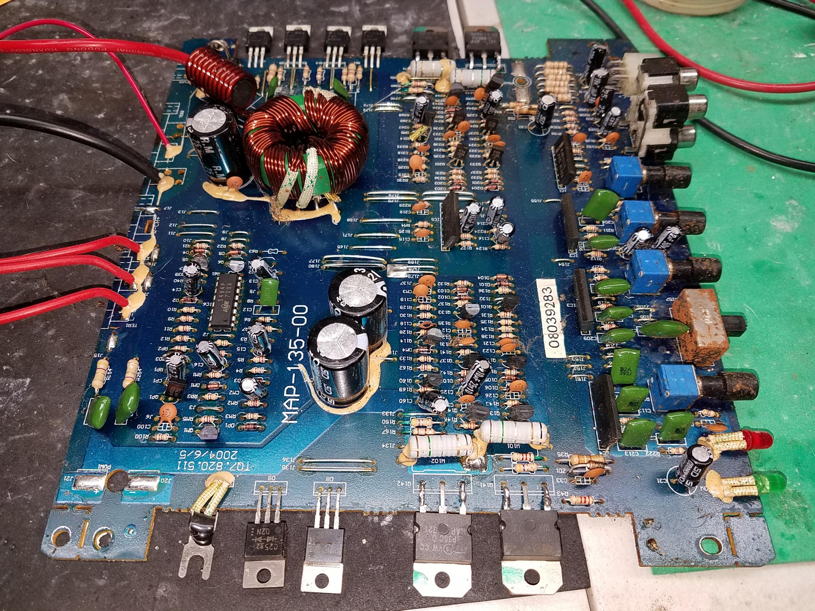

SPX pro audio amp No audio output

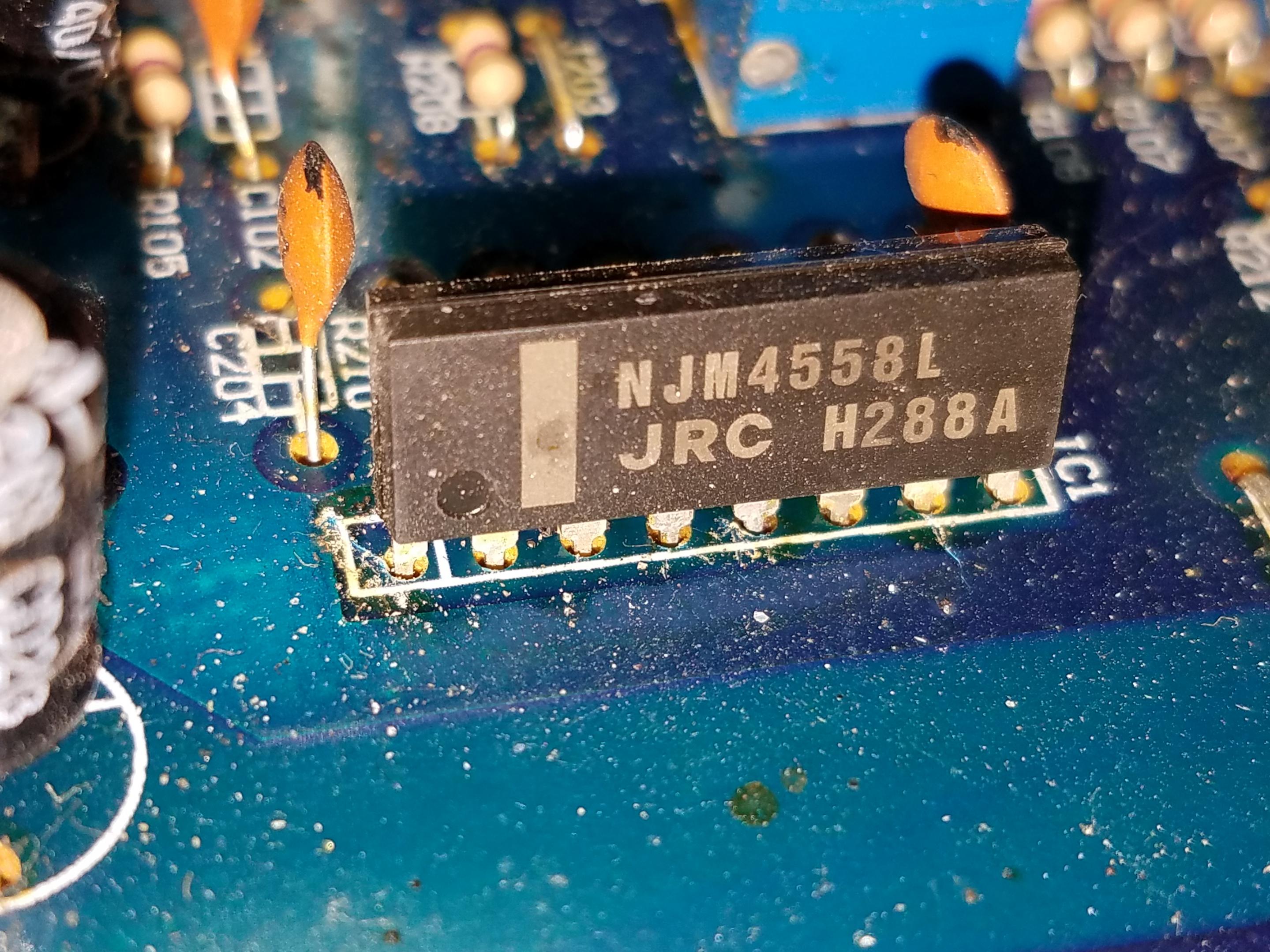

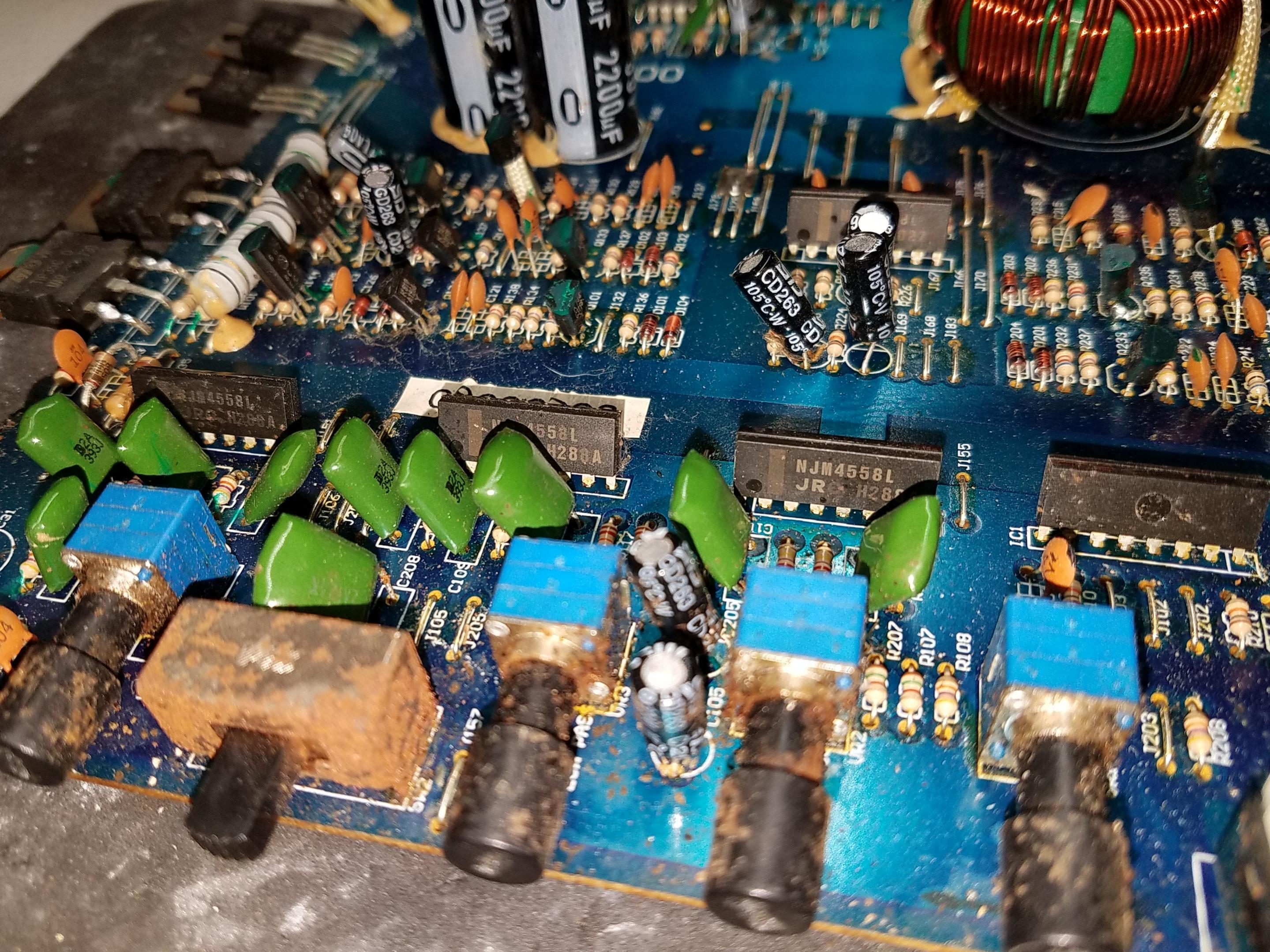

I have +-15v on ICs 1-5
100hz Signal in & out ICs 1-4
No signal in or out IC 5
Rail voltage +29.44v /-29.46
Checked all drivers?
