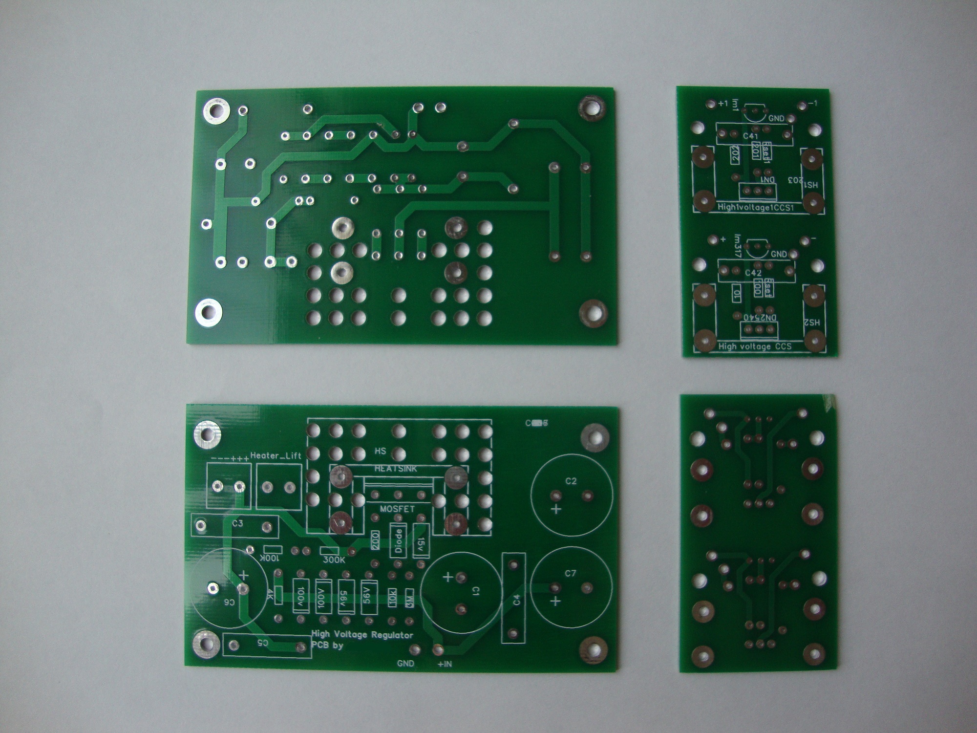

I have had zero problems with the service I linked to. I'm attaching a picture of two boards I had done a year ago (actually, one 10cm x 10cm panelized board that I cut out myself). The fit and finish is professional and they solder just fine. I just ordered another 10 of a 5 x 5 cm board, I'll let you know if the quality has been maintained. Tubelab, if you want a board as an example, let me know, I'll drop one in the mail.

Thanks for the information for the thread. Was your cost for the boards you attached $9.90 for two, or 10 for $70?!?
What about tooling setup, drill holes, hot air leveling, etc. to get a finished board?
The product you have looks professional. How was their turnaround time and shipping costs?
The cost is $9.90 for ten 5 x 5 cm boards, it's $24.90 for ten 10 x 10cm boards, and $69.90 for ten 10 x 15 cm boards, as well as other sizes (there's a drop-down to select size, and price varies according to size). Standard color is green, other colors available for a $10 charge. Hot air solder leveling is standard, ROHS and/or gold plating for an additional charge. Electrical test of 50% of the boards is standard, 100% for an additional charge. Honestly, the basic options are fine unless you really want a super cosmetically pretty board (black PCB with gold plating...mmmm). Shipping is in addition to the price, but for ten 5 x 5cm boards, shipping is $4.10 for airmail. Time frame is 10-30 days, depending. Faster shipping is available, but I'm not going to spend $40 on shipping $10 of boards.
With 9 pin Novals or Novars, I'm sure a 10cm x 10cm (slightly less than 4" square) board could be designed. I've designed a 6L6 driver board using two 6FD7 tubes and it's smaller than 10cm square. Granted, there's no power supply onboard, but I like using the big square diode bridges offboard and regulator PCBs. A separate power supply board would be cheaper than a single big PCB.
The cost is $9.90 for ten 5 x 5 cm boards, it's $24.90 for ten 10 x 10cm boards, and $69.90 for ten 10 x 15 cm boards...Hot air solder leveling is standard, ROHS and/or gold plating for an additional charge. Electrical test of 50% of the boards is standard...the basic options are fine...Shipping is in addition to the price...Time frame is 10-30 days, depending...
That's a pretty amazing price, all things considered. In what units (mils or mm) did you design your PCB's?
What software did you use? Looks like the service likes a Cadsoft Eagle Design Rules check. Since I am new to all this, I'm trying FreePCB. It has a design rules check, but I am too novice to know whether it's check is consistent with the Eagle check AND whether the Gerber files it will produce are a format compatible with your fab service.

Ultimately, at $7 a board for a batch of ten 10cm by 15 cm boards, which the SpudSE proto-board is (roughly), I am hoping that we can coax George to pull a potatoe (thanks Dan Quayle) out of his hat, after pulling his Guitar Amp board out for his audience.

I already have a board designed. Like the Spud SE, it cost too much to produce in small batches using my current PC board vendor. The board I have is quite simple with a tube rectifier for main B+ using the existing conventional power transformer. It uses a second auxiliary power transformer to provide +/- 150 volts for bias and mosfet drain supplies. This removes the main B+ from the mosfets on the TSE board allowing them to run at higher current while staying much cooler. I'll look at making it fit one of Seeed's standard sizes and see about getting some made.
I have several other simple board designs in the works too.
A Tubelab board usually goes through an itterative design process. I usually home cook a single prototype to test the design. Then I will refine it, redo the layout and home cook another board. This loop may repeat several times until I am totally happy with the results. Then I spend $1200 to $1500 for a batch of 100 boards. I need to recover that outlay before doing another batch of boards. The TSE took almost 2 years. THe SSE took off, repaying everything in less than a year. I have just ordered the 4th batch and it is the first Version 2.0 batch. The SPP has broken even after about 2 years.
This process doesn't work for something that will not sell 40 to 50 boards a year. The Spud SE, the auxilliary power supply, and several others will not sell that many in 5 years! I have resisted using Chinese PC board vendors, but maybe this will work for small volume runners.
The existing Spud SE board is 4 X 6 inches. I am sure that it can be squeezed into 100 X 150 MM. I'll need to check the 9 pin sockets and adjust the PCB pattern to fit.
