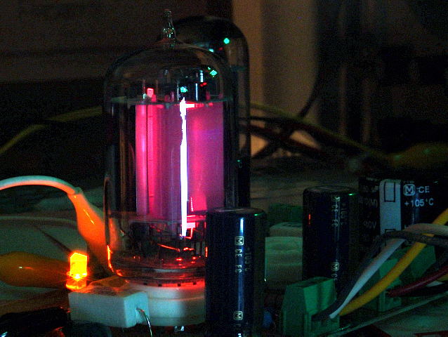

BTW is this a triangular shaped LED next to the tube? Any reason for that or just the next best thing to use?
Well, the LED in the other channel is round. In reality I put some aligator clips where the LED should go and started trying LED's. I picked the ones that gave the lowest distortion. I had an orange rectangular one in there first, but a shorted tube blew it out, so in went the triangular yellow one. It was left over from a satellite TV receiver that I designed about 25 years ago.
I tried two Sears branded Sylvania USA made tubes. They consistently made about 1 watt less power and showed faint color at 26 watts of dissipation. They lit up brightly at 40 watts.
I tried one really crusty old looking RCA tube. It made 14 watts at 5% under the 500 volt test. It also barely glowed. When I removed the drive it developed a glow similar to the Japanese tube.
Both the RCA and Sylvania tubes glowed the brightest on the plate surface that faced the other tube section. I would expect this since the path to radiate heat is blocked. The Japanese tube glowed the brightest on the outside face of the plate.
All of these tubes exhibited even glow, no hot spots. This is good. Any hot spots on the plate can cause a quick tube death.
Have you tried Pentode mode?
I put the cracked tube back in and wired up a second power supply to the screen grid. This way I can set the plate voltage and the screen voltage independently. I could not find any set of conditions that worked any better than UL mode. I get lots more gain in pentode mode (expected), but no more power output (unusual, but I have seen it before). I have also seen tubes (the 307A - VT225) that make the same power in triode as in UL, but pentode makes more power. The best results were always obtained when the screen voltage is the same as the plate voltage.
Note, Never operate the screen at voltages significantly above the plate voltage. Dead tubes will result regardless of what the magazine article said.

George, did you try to match impedances in pentode mode? It may explain your results.
No, I didn't. Pentode mode was again "one last experiment late in the evening". I have not tried to optimize the load impedance in any of these experiments. One of my initial design goals was to use the cheap Edcor OPT's and optimize the circuit to the transformer.

In this case the LED is used as is. The LED was added because both tubes (6LR8 and 6GF7) want about 2 volts of bias but at different current and plate voltage. You can't get there from here with a resistor, but you can with an LED.
I have used LED's in my other amps (Simple SE and Tubelab SE) without needing "boost" current. I tend to run my driver stages at higher that "normal" current (5 to 10 mA) so "boost" is not usually needed.
You can measure your LED's and see if "boost" will help. Connect a suitable resistor in series with the LED, and hook both up to a variable power supply. Increase the voltage until the LED just begins to glow. Measure the voltage across the LED and the current through the LED. A current meter is a big help, but the current can be computed from the voltage drop across the resistor. Increase the voltage and take a new reading repeat until you are well past the current that you intend to use. Choose a convienient current increment (such as 1 or .5 mA). Then plot this data (I used Excel). You now have the I/V curve of the LED. It should be nonlinear up until a point at which it becomes very linear. Is your chosen operating point safely inside the linear region? If so "boost" will not help. If not, now you know how much "boost" you will need. You can pick two points an equal distance from the chosen operating point (but both in the linear region) and compute the dynamic resistance of your LED. Lower is better.
