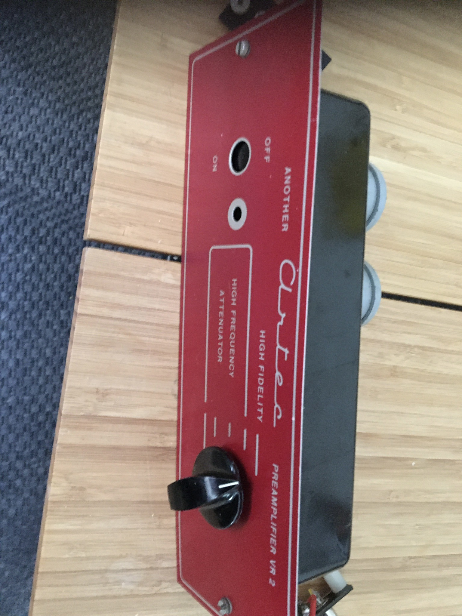

Vanarn, Thanks! I have an old Artec (Belgium) preamplifier which has 2x251s and a high freq attuenator. So according to you this would be a passive preamplifier, makes sense. I am uncertain how this originally was used, other than it was taken from the plinth of a td124. Being 2 251s wouldnt that make it suitable for stereo (SPU) also?
The step up impedance ratio of the JS No. 251 is 1.5 ohm : 200 kohm (1 : 365). A typical phono preamps would neeed an attenuator pad fitted between the SUT and the preamp input, to prevent overload and an impedance mismatch.

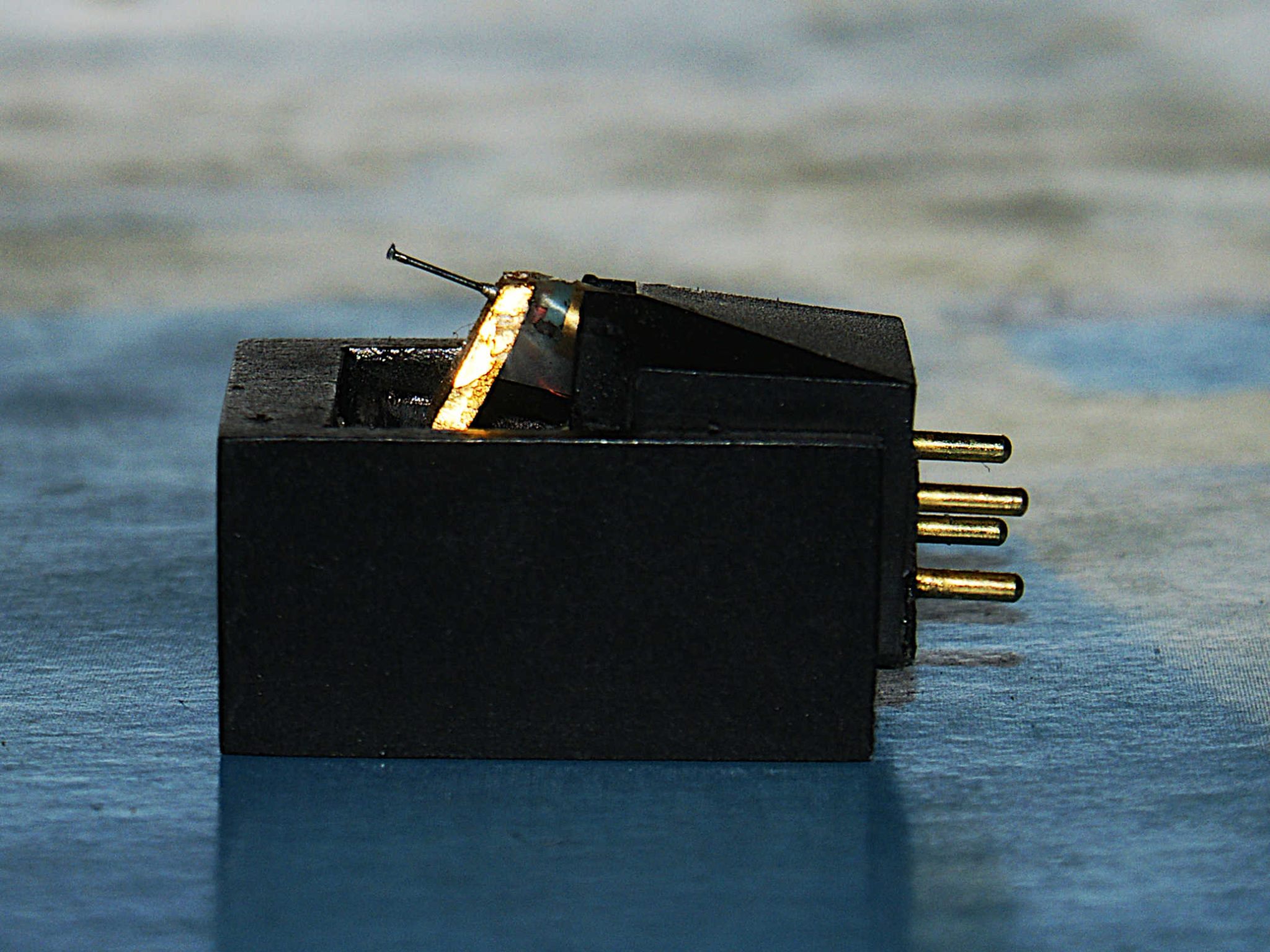

Regarding the original headshell mounted SPUs, I found that to fashion a pair of small bars
to bring the cartridge to a flat top surface and then to use a good head shell suitable for the
arm in use; in my case these were a FR64-S on an SP-10/II and an old Zeta on a Thorens124/1

One good thing to do with an early SPU is to firmly cement the cartridge pins to the rear block
as they have a habit of moving when changing the mounting. Another week is to (carefully) cement
the cantilever tube to the body...! This tweet also applies for many other cartridges; I posted it
ref. a Denon 103 thread some 20 years ago.

Hi Dnic. Is this the Steve Bedard cap that the cartridge just pushes on to or do you have a link to a different one? His Cap is not nuded so it must be a different one. I probably won't change the cantilever for a while since the cartridge has very low hours on it still. Who did you use to change the cantilever? Did you use a line contact diamond then? Even the stock 103R is great for its price! Thanks, Rick.
Hi, There are lots of caps available, check out Flee Bay. The cap weight needs to match your arms Eff Mass, so the total Eff Mass is raised to between 30 to 35 grams.
Nude 103 is the best for S/Q, but that also lightens the unit. Recently I modded a cap by cutting the area away by the stylus, looks a bit weird, but S/Q improved. This type of mod is recommended by the NeedleClinic cartridge re-tipper
Cheers
