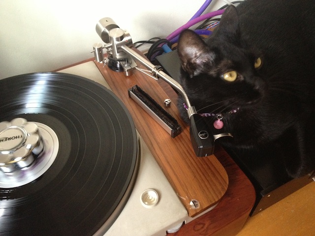

Finally bought a used SPU Classic from Japan, taking advantage of the drop in yen exchange rates from the Abe economics.
I was using a Soundsmith retipped wood body DL103R before. The word to describe the SPU is "Grand".
The sound is of course further enhanced by the presence of the "black cat", who will cast magic spells for sound improvement where no snake oil can compare. Though this young lady had snapped a cantilever of my DL103R. Sorry, the magical cat is not for sale.
Enough for the jokes. Just want to ask the experience of the fellow members to summarise the difference of different SPUs. There are so many types out there and I have no clue what the differences are, except for the price.

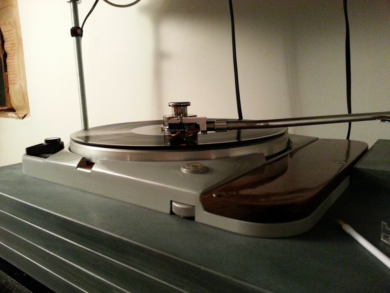

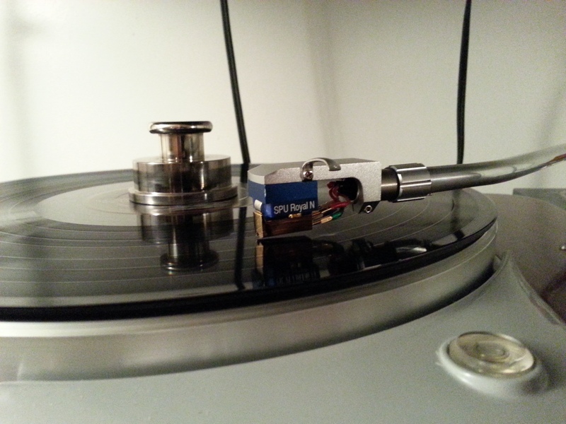

Picked up a NIB SPU Royal N recently on Audiogon and installed it on an 18gm Audio Technica Technihard today. Rather pleased with the result. Despite rumors to the contrary I've not found the fact that it has a Replicant stylus the least bit problematic at least in this head shell. I regard this as a rather significant improvement over my Meister Silver, better tracking, noticeably cleaner sound, more detail, refinement and much less tracing noise. (Noting that the difference between the Meister Silver and a GM E II is about as great.)

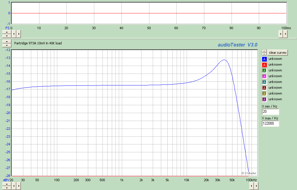

Recently acquired a set of Partridge 973A mu-metal core microphone step ups as I was feeling a bit too cheap to spring for another pair of Lundahl LL1941 for the second TD-124/SME-3009 Series II/SPU GM E II/Muscovite Mini phono stage.
These transformers are 1:16 and the seller claimed a primary dcr of 2 ohms and an impedance of 30 ohms..
The secondary impedance is claimed to be 40K and the dcr of about 250 ohms.
I did not bother measuring the dcr of either winding.
I did rather quickly determine that they sounded grossly inferior to the LL1941 when driven by my Ortofon SPU GM E II with a source impedance of 6 ohms.
A 30 ohm primary impedance reflects to the secondary at 7.7K so I am not at all sure where that 40K ohm figure comes from and is indeed much higher than is reported for the 1:12 version for example. (This raised my suspicions)

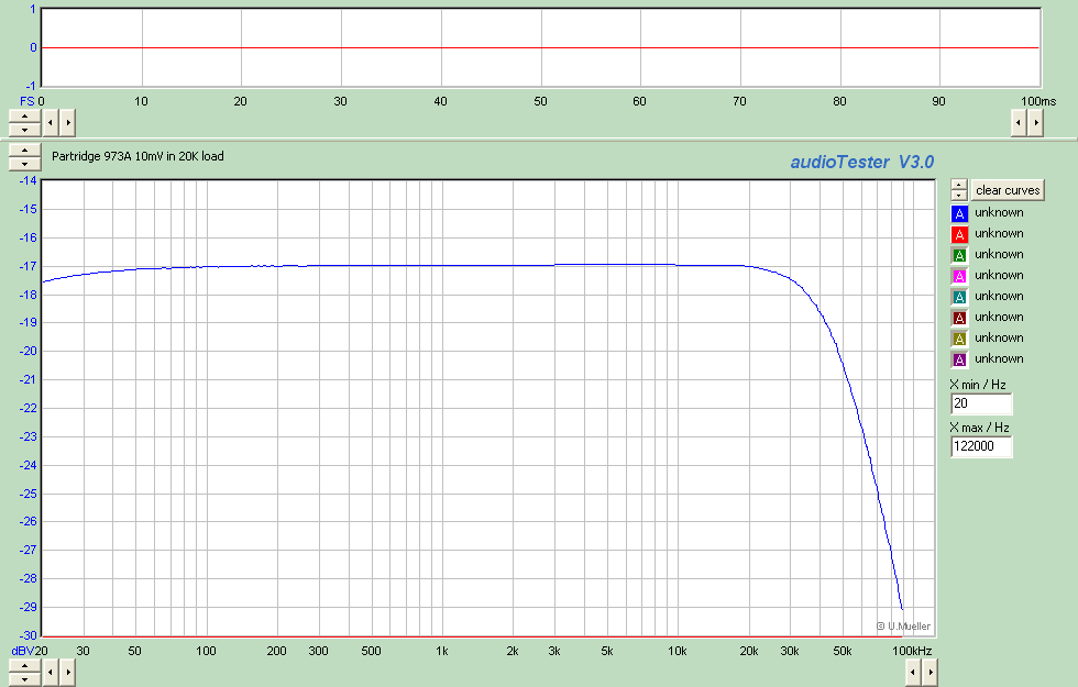

Something not quite right here.. I decided to measure the transformers terminated into 40K and a number of lower values to see how these transformers behaved.. The source impedance was 6 ohms, and the drive level just shy of 10mV. (I figured why not as they weren't clipping and the extra snr could not hurt.)
The results were, umm.... interesting.. See below..
The measurements were performed over a frequency range of 20Hz to 90kHz as a swept sine. (The measurement system is flat to better than +/-0.1dB from 20Hz - 90kHz)
The conclusion is that in my system with the low capacitance inputs provided by the muscovite mini that a 20K load across the primary rather than the habitual 47K is advisable.
IMHO these transformers have an overstated reputation for excellence and sonically and in measurements do not live up to the hype - they are billed as punching way above their price class which they do or don't depending on point of view. I had frankly expected better performance based on the hype - something approaching the LL1941 which I did not get. They are pleasant sounding if a bit wooly on the bottom end, they sounded a bit odd, hollow at times which the proper loading seems to have fixed.
Frankly if you are going to spend $1K - $2.4K on an SPU the LL1941 at twice the cost of the 973A is a better long term investment.
