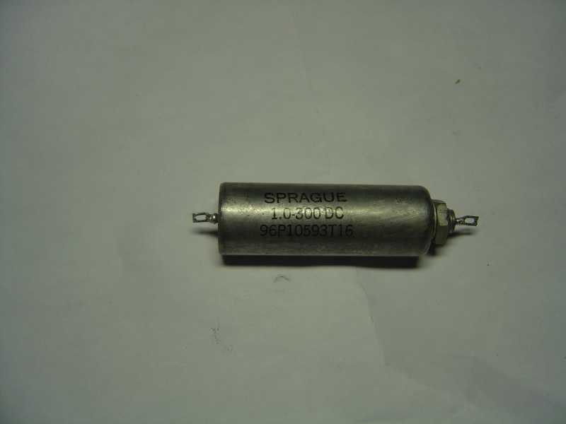

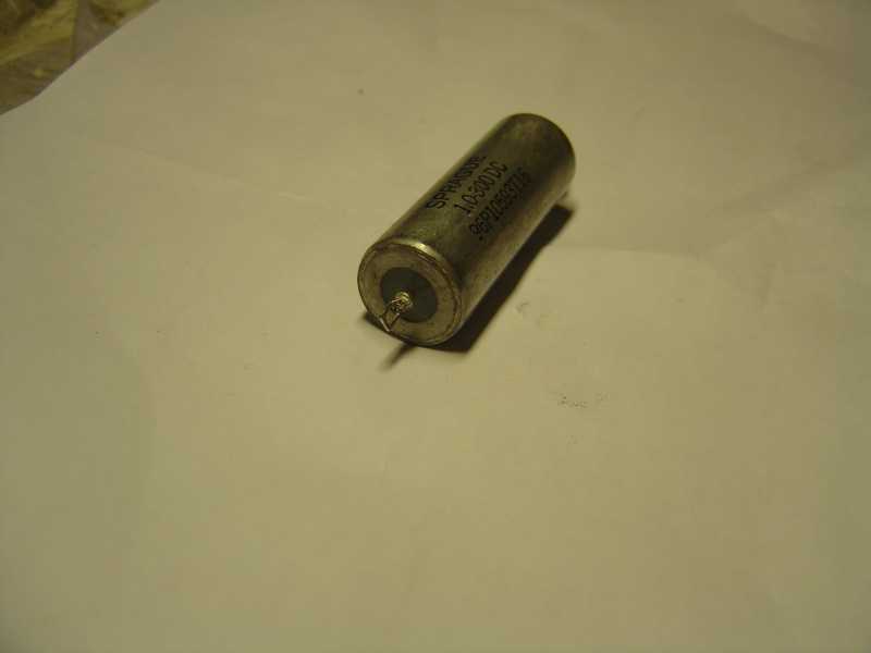

Sprague capasitor id
Could someone please id the following capasitor type? PIO, Polyprop ...
Got my hands on a few of them. Missed a few hundrend more thou.
The threaded end makes me think is a feedthrough capacitor. Measure the resistance (yes resistance, not capacitance) across the two ends. If it remains basically zero then it is a feedthrough type and the 1uF is between the conductor that runs from one end to the other and the case. It is used to filter RF from a signal passing to or from a shielding enclosure.
