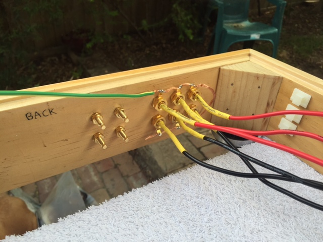

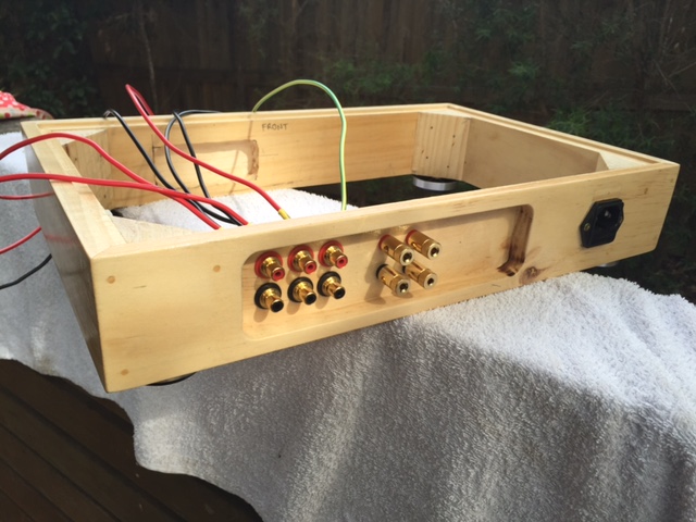

Thanks for your advice folks, and sorry to take a while to check back in!
I've assembled the PCB with all the resistors on the top side. Right now I'm assembling the (wooden) chassis, which will have a 3mm aluminium top deck - see photos attached.
I'm now trying to get my head around how everything should be grounded. Is it reasonable to ground the RCA connectors' outer casings as shown in the photo, i.e. all soldered to an earth wire that returns to the centre pin of the IEC connector? I would then have separate ground connections from the mains ground pin to (a) the aluminium deck via one of the transformer mounting screws, and (b) the audio ground on the PCB via one of the input ground connectors.
I have three sets of input RCA jacks. With the casings grounded, I'm connecting the centre pins of the RCA connectors (i.e. left and right channel signal) via a 2P3T rotary selector to the volume pot tracks. The other end of the tracks would be grounded to the PCB input ground. The volume pot wipers would be connected to the PCB input signal connectors.
How do I ground the casings of the rotary selector and volume pot? Do I literally just solder a ground wire to the metal case?
Please let me know if I've got this all around the wrong way!
Jon
