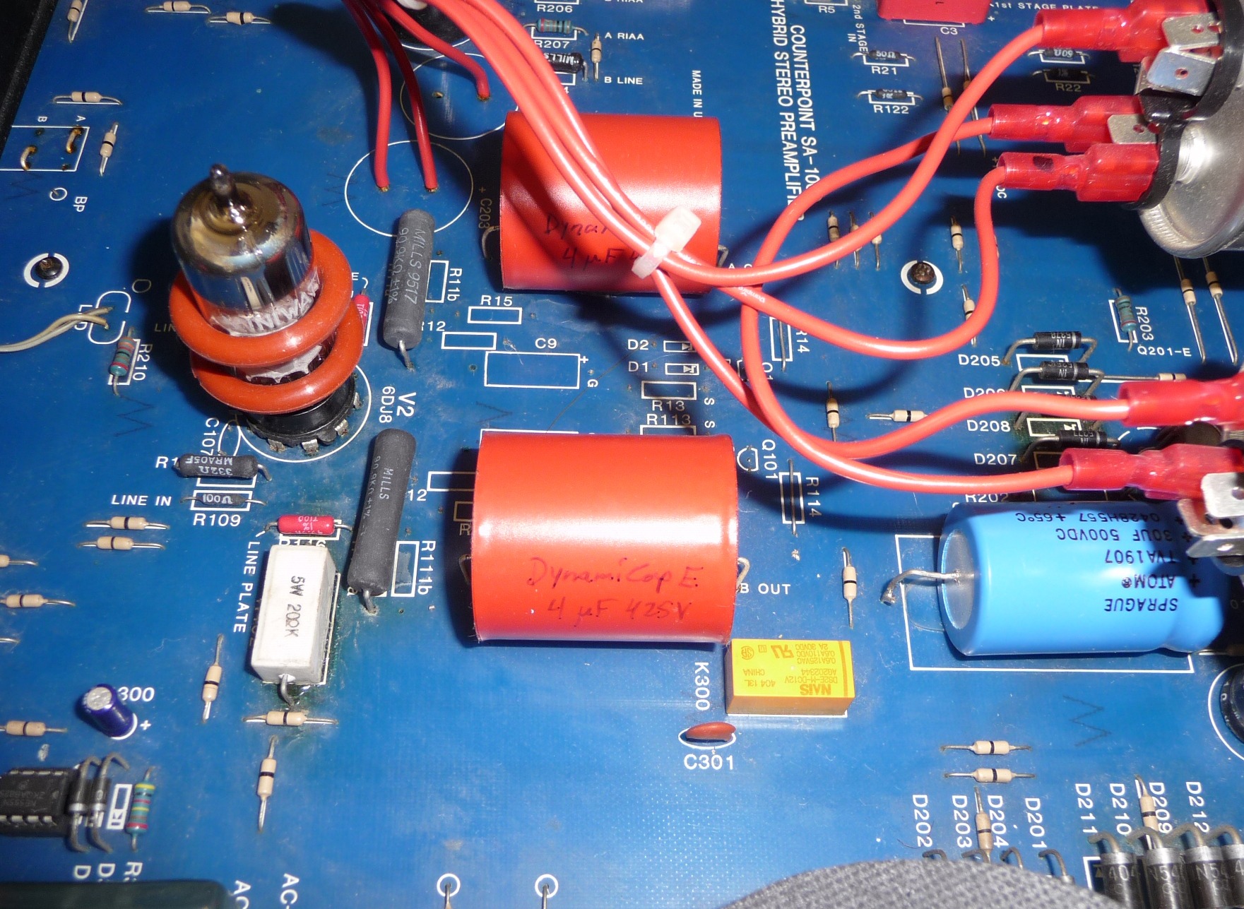

Splitting output signal to two?
If you first disconnect the present connection to the tape out, it's ok to use the jack for something else.
In the unlikely event this causes hum, you might have to change the ground connection as well,
but wait and see.
It depends on the equipment, assuming this is not a tube preamp.
If the total loading on the preamp is 10k or higher, there won't be a problem.
If the two loads in parallel are much less than 10k, there could be some loss of bass, etc.
C8 & 208 are 4uf, this was upgraded by AltaVista.
