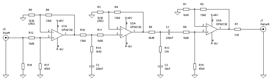

a all-in-one RIAA, though technically elegant, may not give as a precise RIAA-EQ as a split network.
The splitting offers the advantage to design the networks independant of each other.
This can reduce losses and improve on noise.
With regard to clipping headroom matters depend on circuit topology.
A inverting stage would be probabely best in this regard, due to low parts number count and lowest commonmode voltage swing at the input.
But since the (non-constant) pickups impedance would define the gain and would add considerable amounts of noise with rising frequency.
Such a single inverting stage would rather be found as second gain stage with a linear noninverting input stage ahead.
Single gain stages are almost always of noninverting configuration.
A non-inverting RIAA-gainstage would not tend towards a gain of 0 with rising frequency as required by RIAA, but to a gain of 1.
Such a stage would require an additional lowpass to achieve the RIAA response.
This lowpass may either follow behind the RIAA-stage or may be between a linear gain stage and the RIAA-stage.
The latter offering the highest flexibility. Since the linear input gain stage would take over most but not all amplification, clipping is rather a no issue with standard +-15V supplies.
A all passive RIAA-EQ would require two linear gain-stages and 20dB more gain than split RIAA with 210Hz passive and 50-500Hz active RIAA-EQ.

Record surface scratches (usually) do not overload a properly designed phono stage having +/-15V power supply. Once I tried two passive RIAA phono amplifiers of the same topology. The gain stages were opamps in the first case (TL071), and tubes in the other (SRPP Anzai circuit), but the passive RIAA network between the stages was the same. Needless to say they sounded much different, the tube version did not exaggerate the record surface noise, and it was not due to HF rolloff.

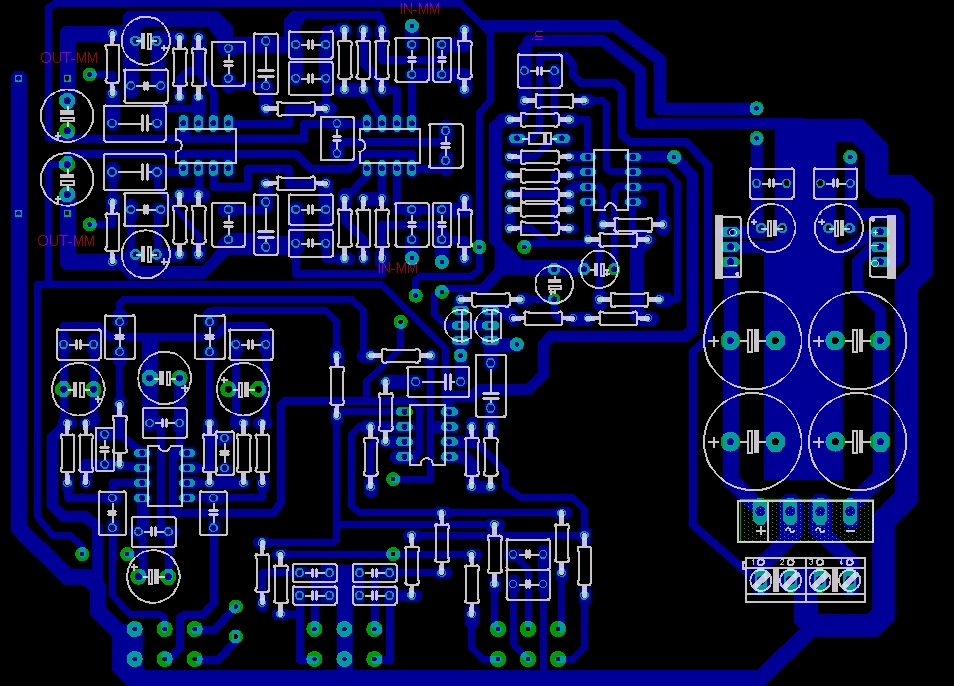

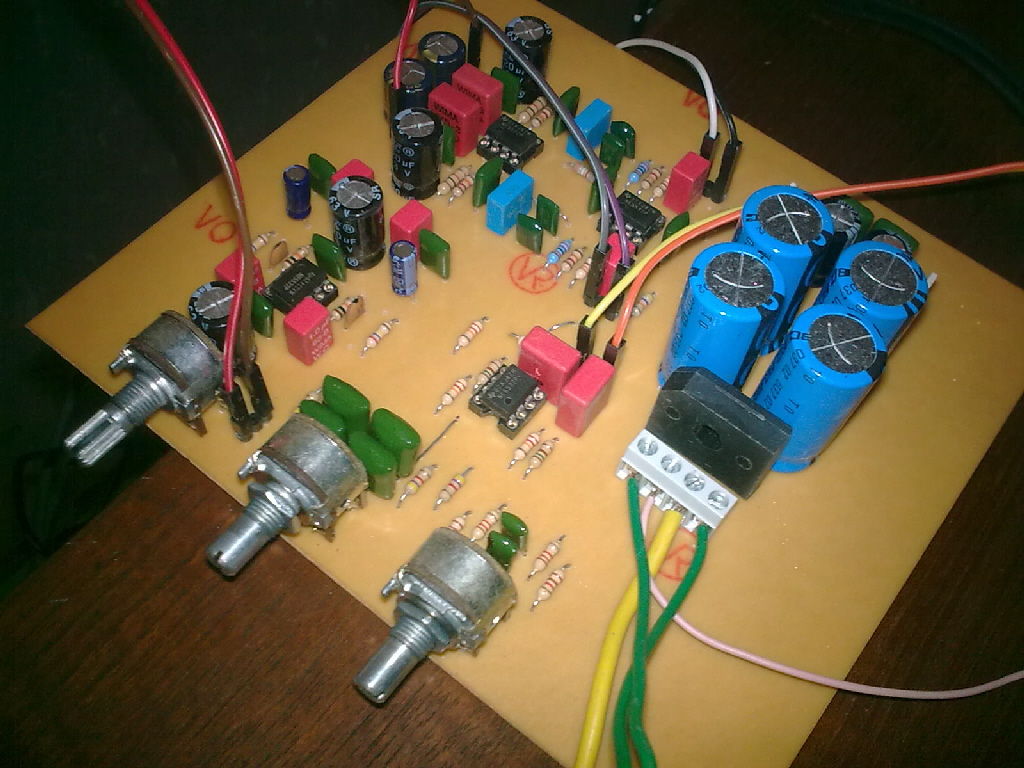

mine does not clip with 6v rails and the treble response slightly high.
may be the rolloff at 25khz on the 1st stage low noise NPN amp.
