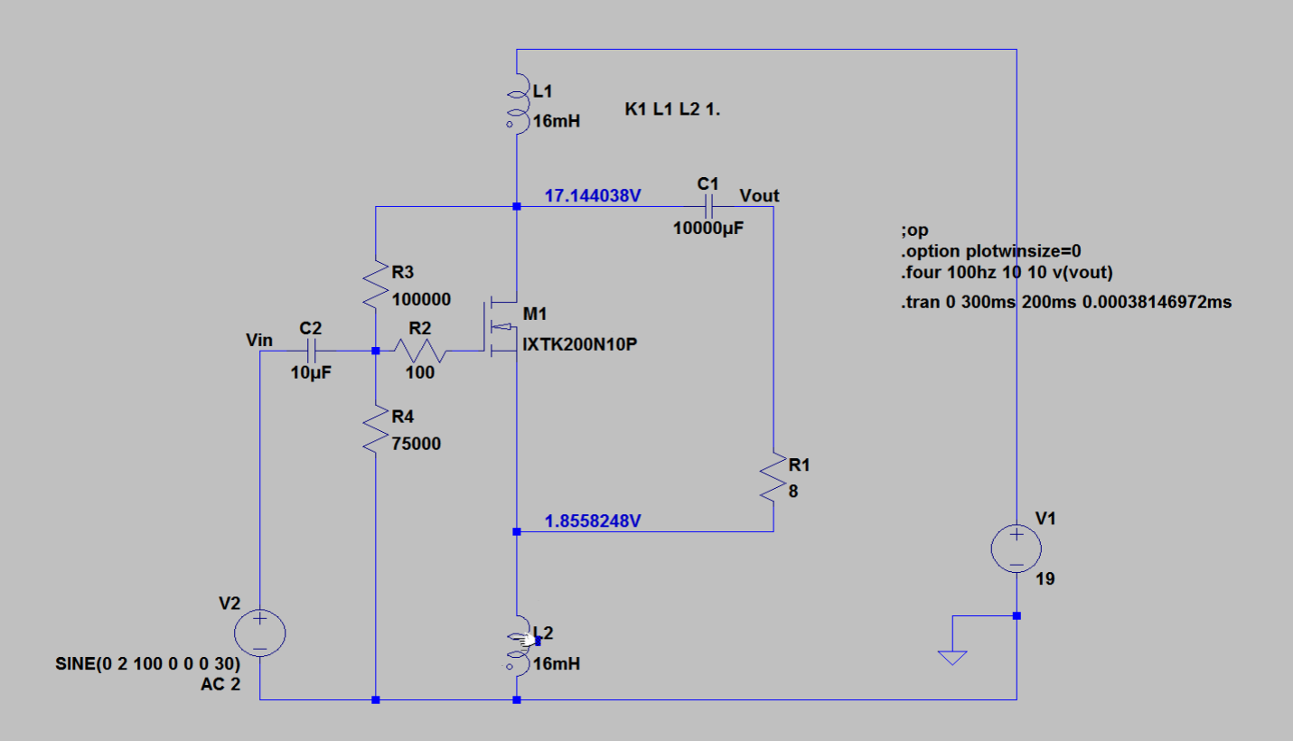

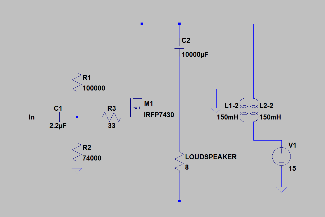

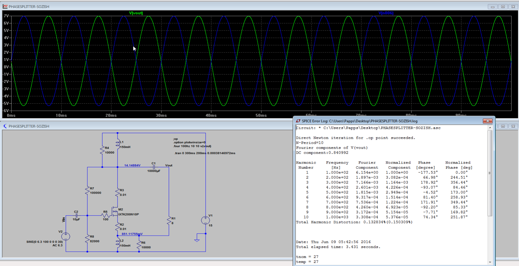

Split load phasesplitter amplifier with bifilar choke load
Hi everyone!
Today I am tired and my mind feels dull and quite worthless.
I have been thinking about a "Concertina" split load phase splitter based amp with a bifilar winded choke as load.
I ended up with the circuit above, and it works nice. I am playing Melody Gardot March for Mingus as I type this.
I can't say that I am impressed by the sound in any way though.... There is nothing wrong really, its just a bit dull and boring to listen to.
The same IRFP7430 in a Zen type amp sounds marvellous with abundant muscle and joyful vividness.
Is the transformer-core magnetized in the above schematic? I can't grasp this circuit today. What could be the reason it sounds so dull?
I tried to couple the two windings differently and the music just disappeared, so I guess that was the wrong way.
Thankful for any comments on this, since my brain is on sick-leave today, an just flat out refuses to do anything meaningful...
Johannes

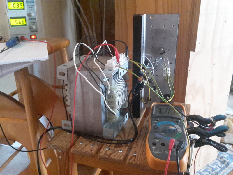

I connected this amp to my computer soundcard and the sound quality increased substantially. It seems more sensitive to the signal source then other amps I have built and tested. It has no voltagegain. It is a powerbuffer, so I don't get a lot of power from it. I need a good preamp.
I have been listening to Biosphere, Yazzo, Frankie goes to hollywood and some Miles Davis, and it kind of grows on me. It might not have the same immediate presence and vividness that the same IRFP7430 has in a normal Zen amp, but it is very well behaved. Clean, fast and with a nice dynamic punchy bass reproduction.
Johannes
https://youtu.be/ewTKcSiXlH8
Here is a video showing me varying the current through the amp while playing music.
There is a lot of audible distortion with less then 50 mA of current through the amp.
With 50 mA it is quite nice sounding. With 500 mA it sounds somewhat warmer and fuller with a smoother treble, but the difference is not that large compared to 50 mA.
This is really strange. I don't understand how it can play nice, clean and smooth music with only 50 mA?
I simulated something quite similar but with 900 mA current instead.
I don't know how to simulate a bifilar choke, so I used two separate 0.55 ohm 150 mH chokes.
Johannes

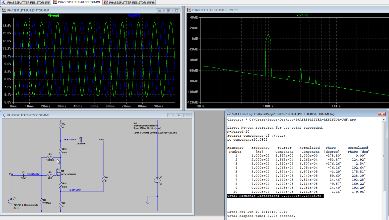

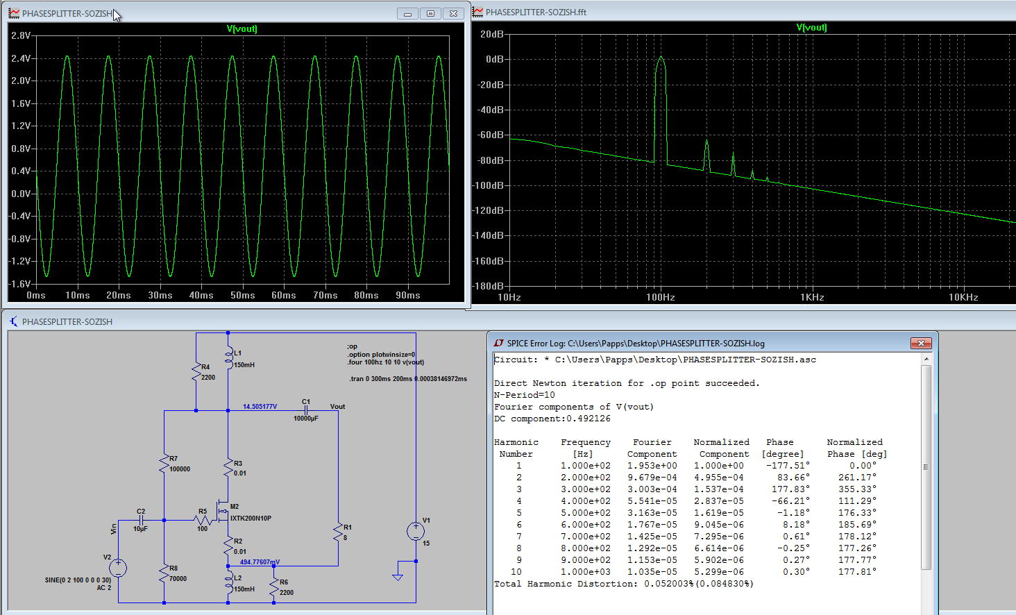

Here is a simulation of a power-resistor loaded split load phase-splitter amplifier driving an 8 ohm load with a 15.4 volt (p-p) signal. Very low distortion for a such simple amp and only resistors as drain and source load.
The FFT clearly shows the cancellation of even order harmonics.
Johannes

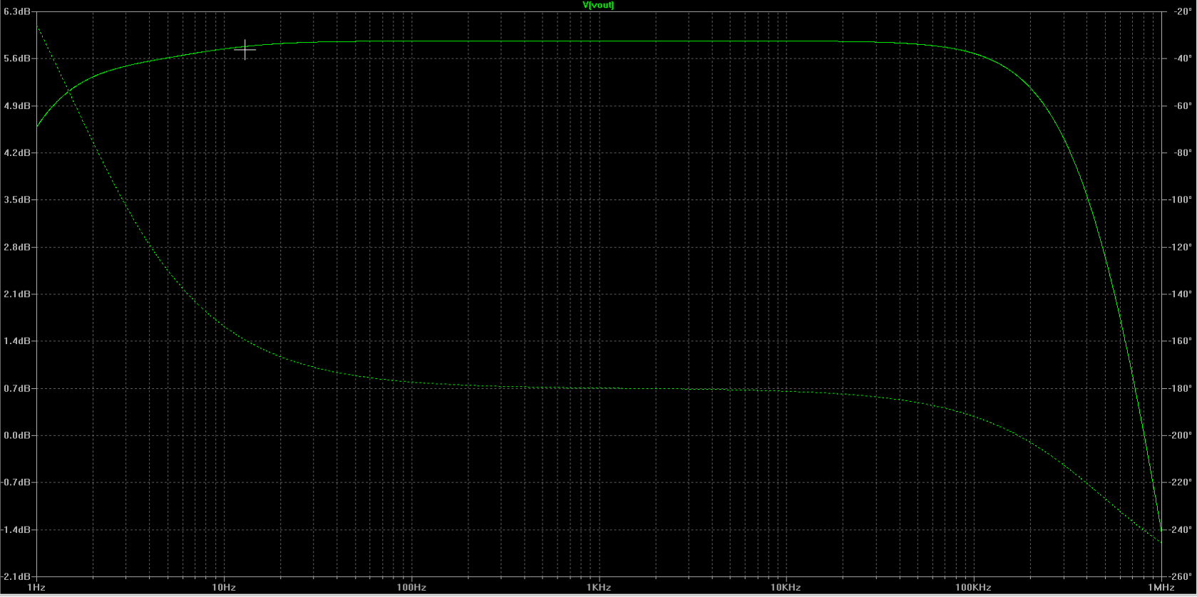

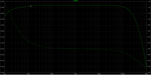

As I said in my first post: my brain was on sick-leave and refused to do anything meaningful the day I built this last experimental amplifier.
The core of the large bifilar choke is magnetized by the current. When I traced the wiring again today, I saw that the current flows the same way through both windings. Luckily for me, the core is somewhat air-gapped. This might partly explain why I find the amp somewhat lacklustre in dynamics and vividness.

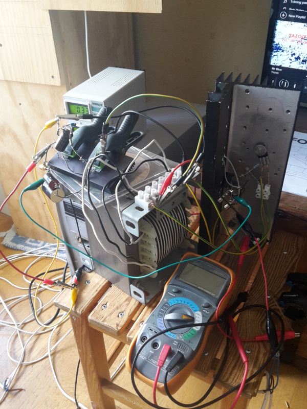

Tomorrow I hope I can test this amp with my aircored 2 x 16 mH bifilar choke. It looks good in simulation at least. Only down one dB at 20 Hz or so. I guess this is because of the balanced operation and the quite large DC resistance of the windings.
Johannes

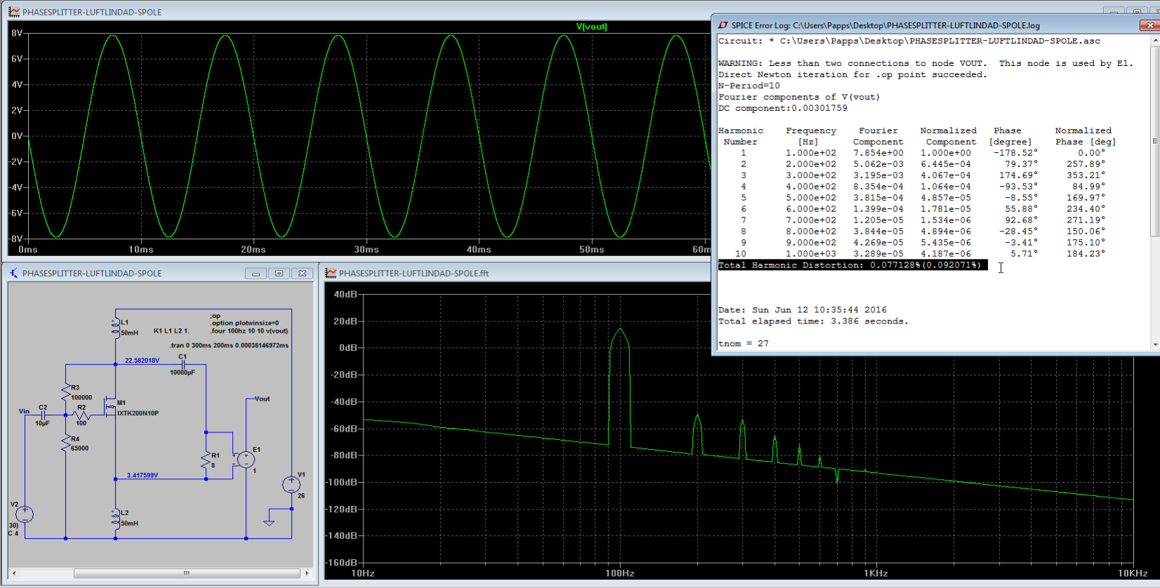

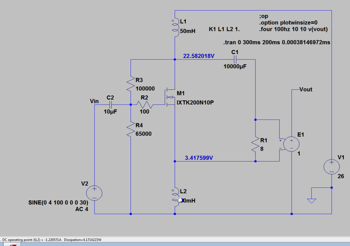

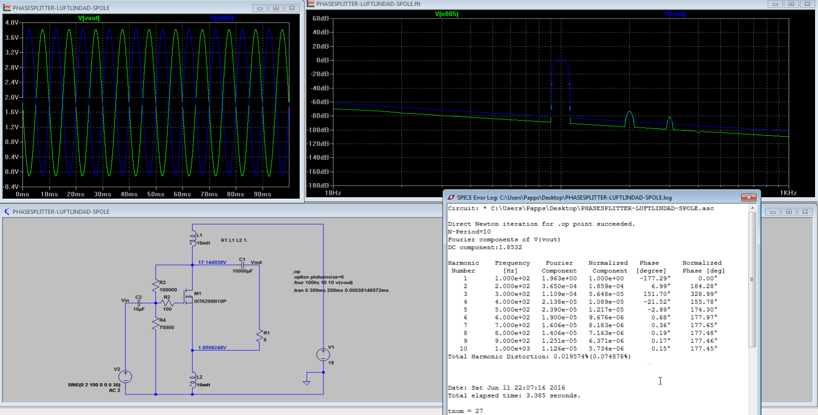

I believe there are some misleading things in your sim , if I'm understanding rules of .four analysis - it is referenced to gnd , while your speaker is nested between two chokes , so you're ignoring things developing in L2
put e.asy across speaker leads , connect - out to gnd , mark + out as Out, give it value 1
that way you'll translate floating outputs to gnd
Yes, most certainly... I am a complete noob when it comes to LTSpice, so I try to keep it as simple as possible, and I don't dwell much on any discrepancy between the simulation and the real world results - as long as they are consistent between different simulations.
Your analysis and suggested changes are most valuable to me. Thanks for easy to understand, clear and concise instructions in how I can use transformers and e.asy to better the simulation. This makes it much easier for me, and I really appreciate it! 🙂
I try not to delve to deep into every aspect since I view a simulation as a crude approximation. It is a great tool test ideas and see what has an effect and what does not have an effect on the results. I don't take the numbers as absolute facts. I hope any inaccuracy or discrepancy between the simulation and the real world results are at least reasonably consistent between my different simulations.
I omit all the parallel and series capacitances and inductance leakage between windings in my transformers, because I want to keep it simple and consistent between my different sims.
Since I simulate with a 8 ohm resistor as a load instead of a highly reactive loudspeaker, I guess it is not that important if other parts of the simulation is crude approximations too.
Cheers and thanks!
Johannes
