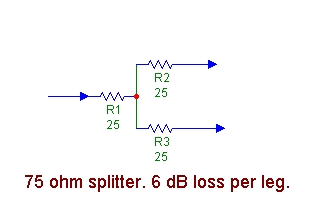

I have noticed that there are some AES/EBU splitters/combiners on the market, but I have yet to find any S/P dif splitters. Does that mean you can split an S/Pdif cable from one output to two inputs (active speakers) with good results?
If not, what is the recommended way of doing this?
Courtesy of Jocko:
That is essentially the schematic for a standard 75 ohm cable TV splitter that you can buy in the US at Radio Shack, Lowes, Home Depot, or your local grocery store. I dont know what you have in Rakkestad.
Video cables have different connectors than audio 75 ohm SPDIF cables.
You can make your own cables of 75 ohm coax RG6. Use RCA connectors on one end and coax "F" on the other.
It should work OK if you keep the cables short and have good crimps.
