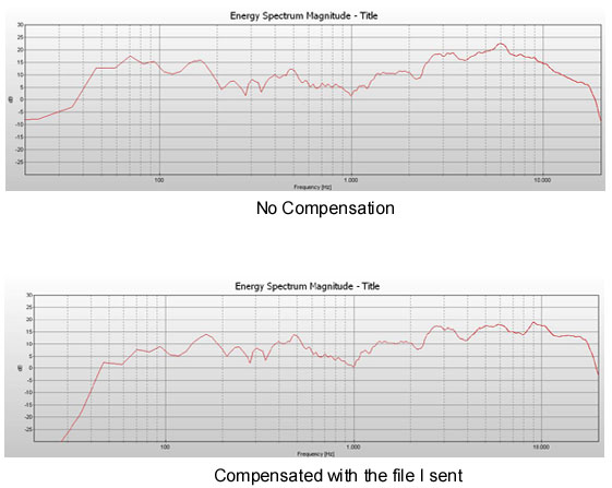

Hello,
This is what I use as a mic compensation file in WinMLS 2000. It shows much positive bass output deviation. Its a fact though, cause I have compared to a friend's well calibrated mic (professional loudspeaker designer) with the same program taking alternate measuements on the same setup. Also in RTA programs I get much bass on the graph if I dont compensate that much. Setting is C. Analogue RS spl meter RCA out.
"Radio Shack low cost condenser mic (Salas)"

here's a pic
Hello,
As I wrote I got em compared in a friends calibrated professional setup. The reason I did that it was that I kept getting too much bass in the graphs in all programs when I used all those readings I found on the web.
I include I a pic I made just now. The top graph is my PC speaker left channel + sub (Cambridge Soundworks) without any compensation used. The bottom one is the same but compensated with the file I sent before. Radioshack analogue set to C. These thingies must variate wildly I guess.
Hello,
