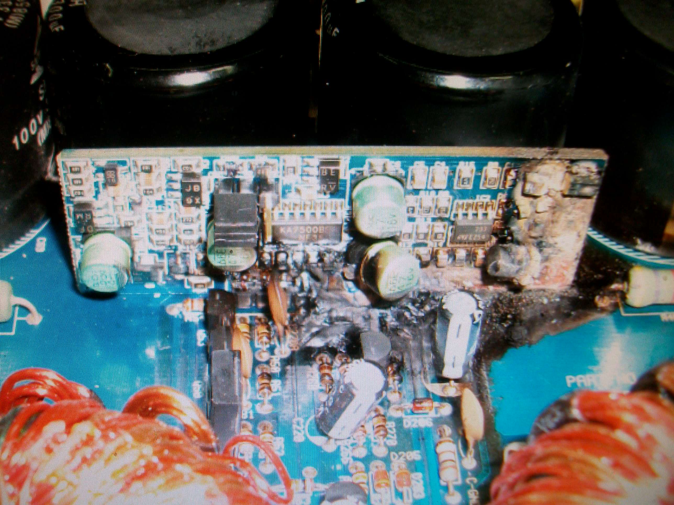

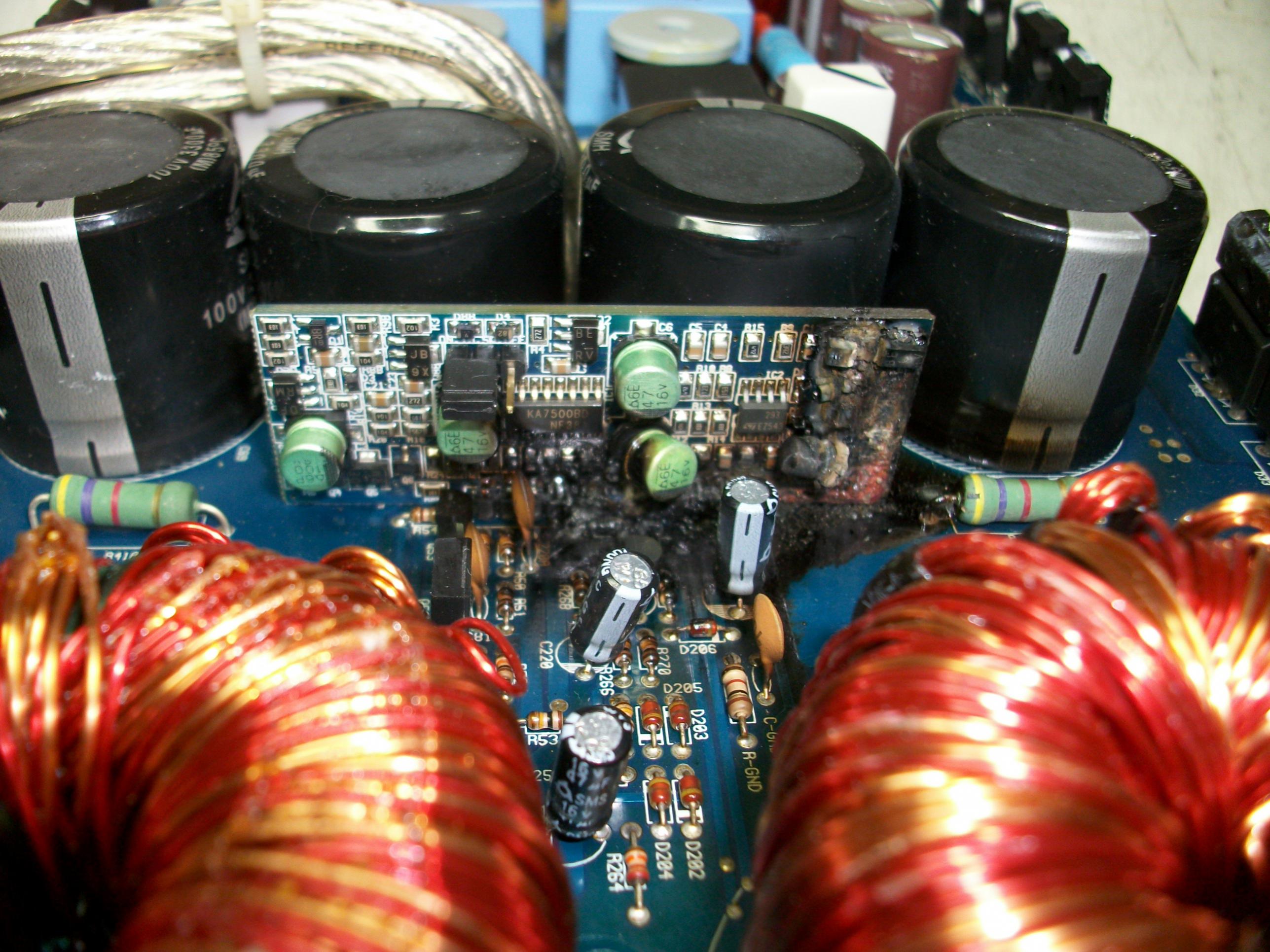

This power amp got fire in the power supply section.
As you can see from the pic, the PWM module has melted.
I wonder, does it worth replacing it? Is it available?
All power supply IRFPs are blown/melted.
The main board does not have severe damage, from the melted module.
I think that after some careful cleaning, it can be repaired....
The class D section seems OK.
Please i need some experienced advice on this

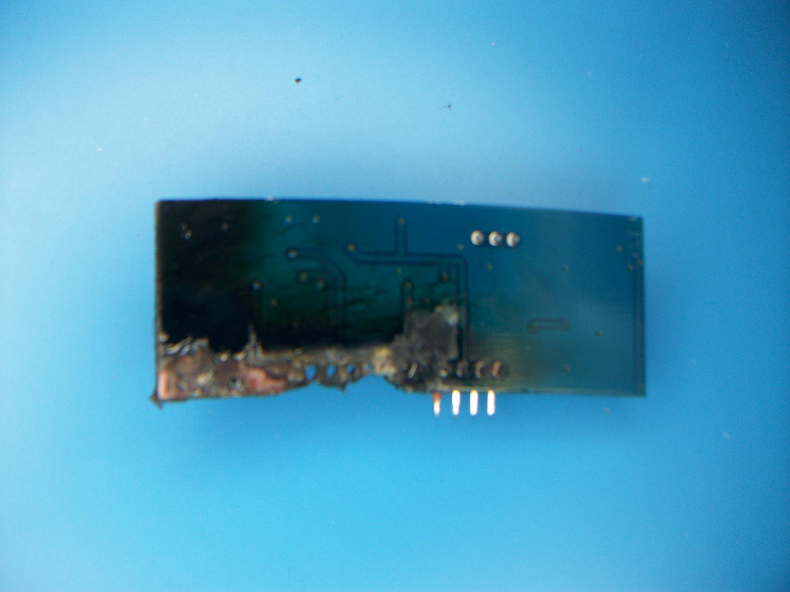

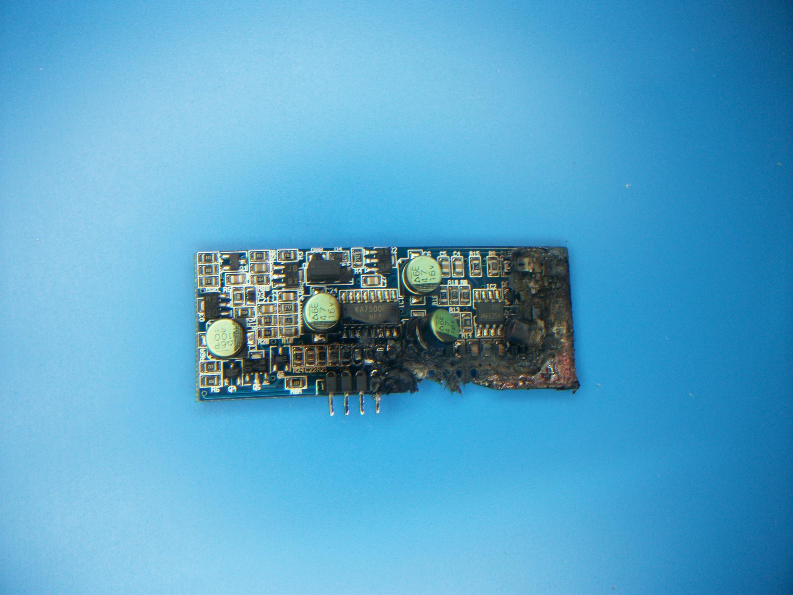

No, actualy i removed the burned module, after trying to desolder whatever pins could be desoldered....the rest ones, i cut them.
Is this module available to buy?

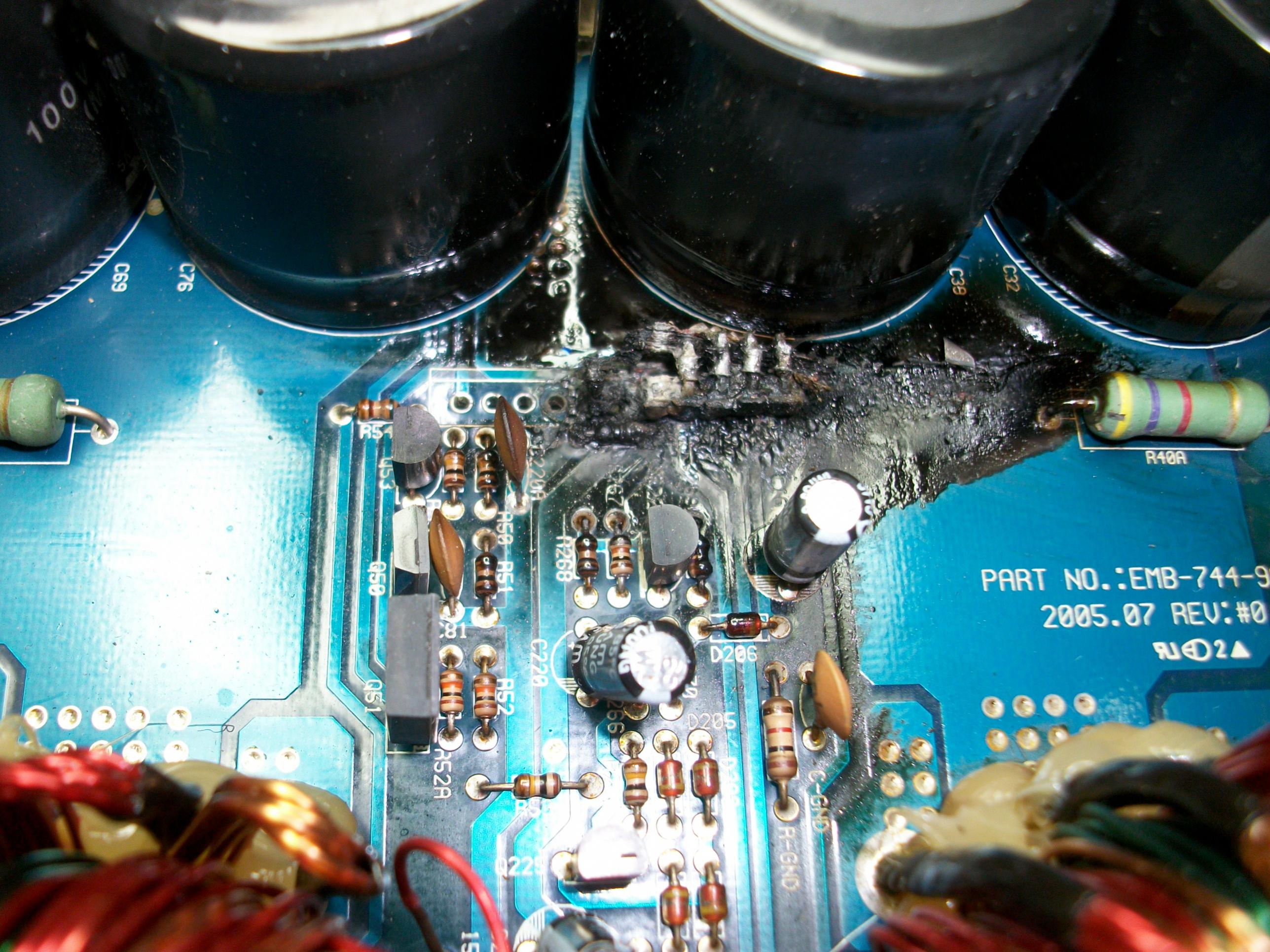

Most of the damage to the mail board was caused by the SMD electrolytics in the module that melted/exploded.
The underside of the main PCB is in repairable condition...
With a q-tip and alcohol, i think i can save the main PCB.
Problem is with the gate resistors of the IRFP064.....ALL burned-could i find their value?

This is what i could remove by desoldering....
The rest, i had to cut.
In my opinion, this power supply started burning from the mosfets inwards, to the current amplifier transistors, and back

Do you confirm that this kind of damage is worth repairing?
What would you do in my shoes?
I confirm that one gate resistor i measured was 33 ohms.
The rest of them , i do not know.

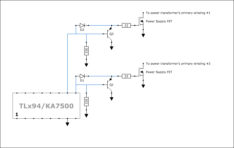

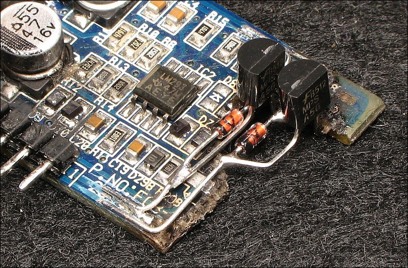

I suppose there should be two PNP and two NPN current drive transistors that are burned on the right side of the PWM modulde.

@ Luka:
I think the amp was directly connected to a battery...
A 200A fuse might be difficult to blow....

ultra:
The missing diode (D8) was a factory defect, I believe. Other boards had the diode installed.
The board is from a Hifonics amp.
luka:
I don't think they use flame resistant boards for the driver boards. On the ones I've seen, the driver transistors fail and the board begins to burn. In most cases, the main board isn't damaged but with the amp mounted with the feet of the amp on the floor of the vehicle, the flames travel up to the main board. The amp is upside-down in the photos.
